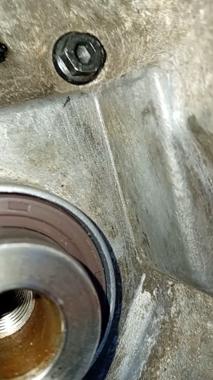

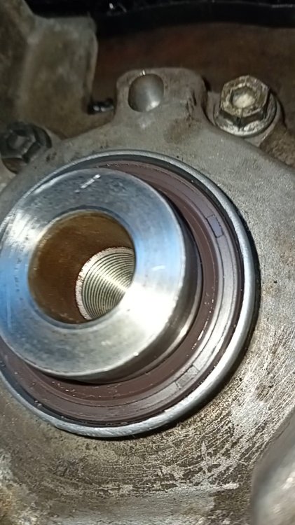

I have fitted a new seal on the front crank, but it leaking for some reason might have done something wrong. So I took it off and went through it again put another new seal, I hope it looks ok, or do I need to tap in a bit further?

Bit hard to see but maybe the second picture shows a slightly raised section of the crank. The seal is only just on that. On that basis Id tap it in a bit more.
However, you really need to check the shaft for a worn groove, as that won't be helping and can well be the main cause
I have tapped a bit more, no leaking so far, thanks! I was a bit afraid to tap a bit more cause it went in too far, like on my old Punto, it was tough to remove when it pushed too deep and reapply the new seal again.
