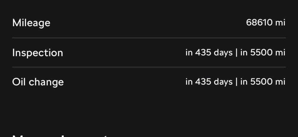

Screenshot from my Škoda app…
I don’t have VCDS, though I assume it can be used to check/change settings - but make sure you have the correct oil before doing so.
Also, I think the mileage element of the service due is variable, based on sensors in the engine. High stress/load then it might be shorter.

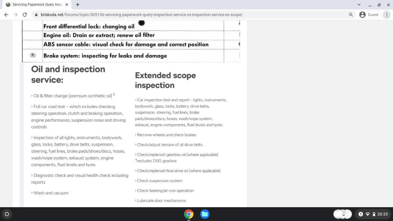

@clevoir25 'Inspections' is not necessarily the same as Oil & Inspection service, or 'Oil Service'.Some idiots Techs left 'Inspection' at 12 months even when the cars were on Variable / Flexible servicing from the Factory, which they are all. If the changed to Fixed Servicing that is Oil & Inspection servicing every 372 days / 9,400 miles or sooner. On Variable @ 24 months, 18,000-20,000 miles the 'Inspection' could just be matched to the same time. Which idiot said a TSI is not suited to 'long life servicing'? What VW Group had with 1.4 TSI PHEV,s was Fixed Servicing, now 1.5 TSI PHEV,s do not have that as the regime. PS, when getting Main Dealer Servicing be sure they put on the system they did the Body Inspection for the Corrosion Warranty. It is not required but Skoda / VW UK say if there is a claim there is no RECORD OF THE INSPECTION BEING DONE. Well they know who do not do them, and there is no T&C,s in the Warranty of a Bi-annual or annual inspection. But there Websites on Servicing says it is part of Main Dealer Servicing.
