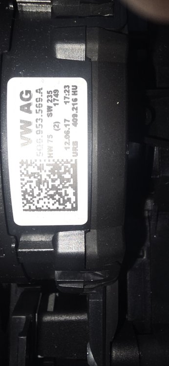

Hi I need some help with my Superb, clock spring replacement, im new to all this. I replaced the clock spring a little while ago and have had no cruise control since, i replaced the old unit with a new one with exact same part number 5Q0.953.569A . Was told by my mechanic friend that it needs coding. everything on steering wheel works except the ACC message that appears on start up. I have vcds now and ran a scan but have so many faults now. Need advise please. many thanks dan

There 2 versions of 5Q0.953.569A clockspring for VW w/o third stalk fo ACC and for Skoda with third stalk support.
Try to restore coding from previous clockspring, if it won't atccept coding, probably you bought clockspring from VW

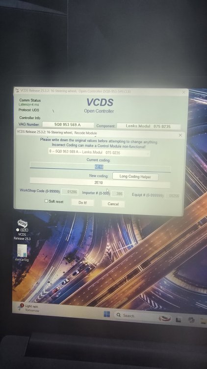

Long Coding:
6414
Try this
Edited by Cairus
Tried changing the code to 6414, but I then got an error message on dash saying please return lever to park, seek worksop repair.
I changed it back and it worked on test drive, cruise control Working but then dinged up saying unavailable.

well, we can only guess, because we don't know what equipemnt you have. E.g. in my Superb coding was 6410
Open coding and check whats is extra is on or off

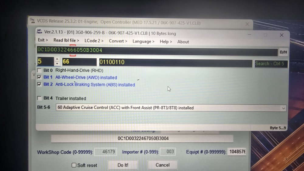

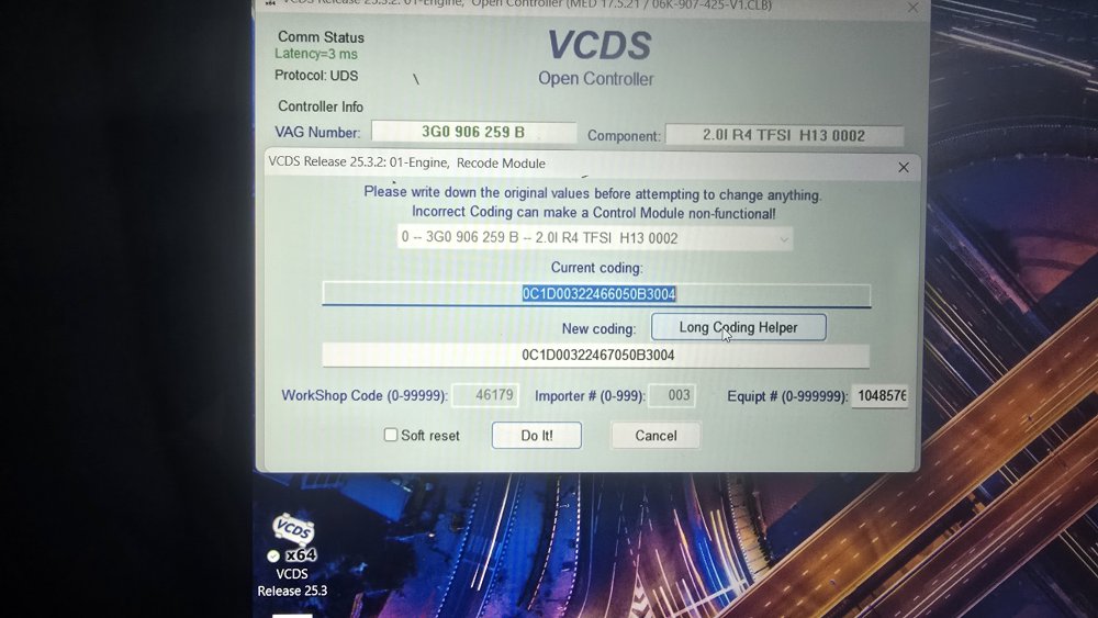

Noticed that there is a box unticked which says RHD , should this be on, did try changing it but it wouldnt accept code. Is there anyone that can tell me if this information can be found on odis? Will try the dealer that serviced/ repaired my car previously, hoping they scanned it then.
this was original, part number which i replaced with same number.
When you have rhd Car, Set Bit aktiv

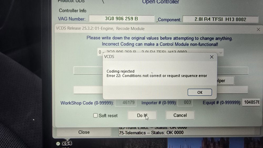

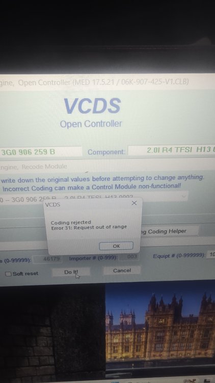

I did that and it says code not accepted,
Security Login done? S12345 = Code
Tried again, this is what i get
Engage the electric parking brake, open the driver's door, and unlock the hood. Ignition only.
tried ha lastnight and hot the message
