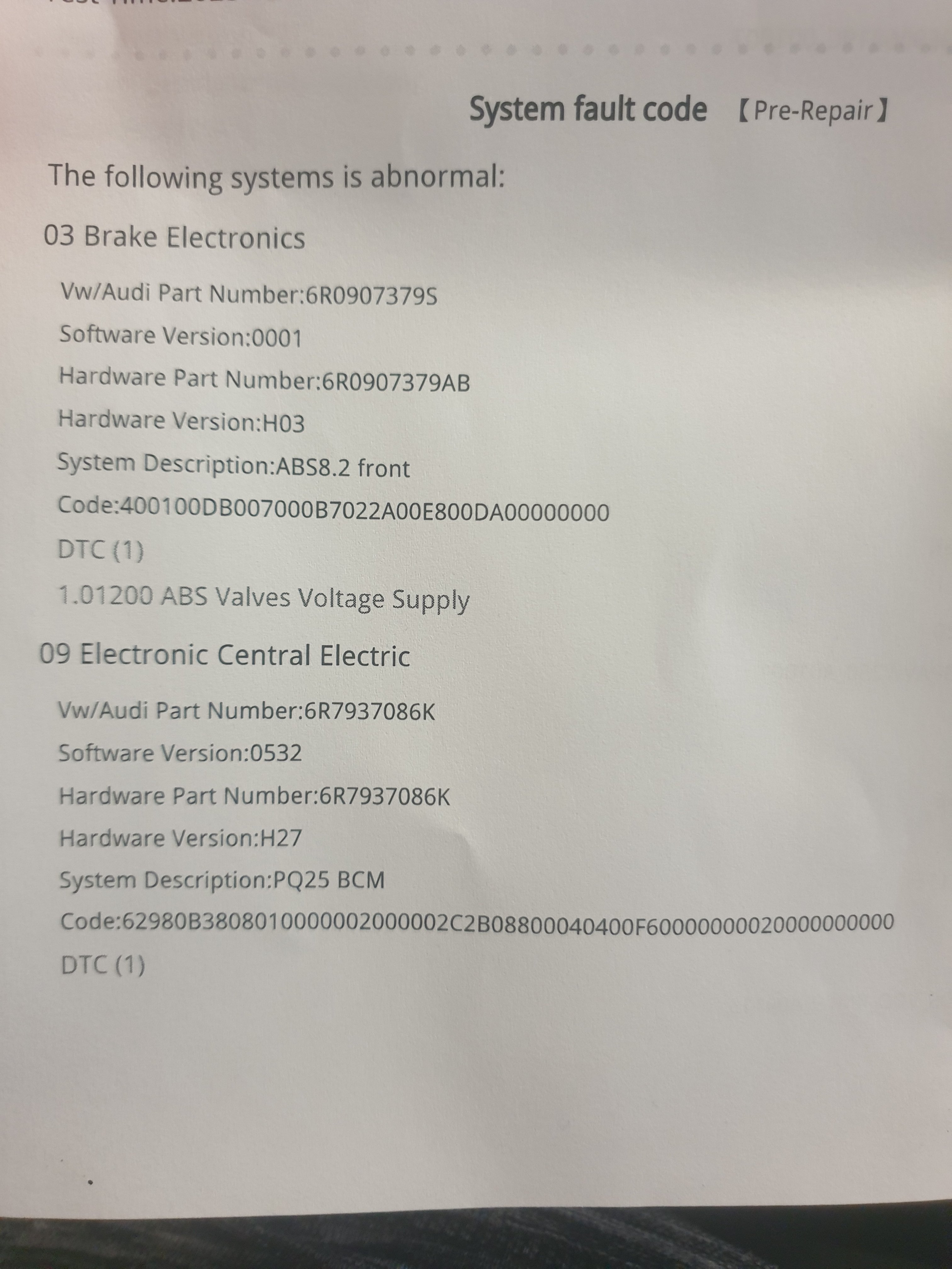

Hello,
I have permanent warnings ABS and Break(!). From two mechanics I understand that I need to change my ABS unit. Is that true? I attached the errors from their raport. My question is if I should try anything else before doing that as is an expensive reparation and might not fix the issue.
Thanks
On my sons MK1 it was just the strip fuse in front of battery that caused ABS/BRAKE warning. On his they are individual and can develop hair line cracks that are almost impossible to see. New fuse and problem cured.
