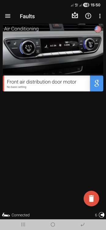

Skoda Superb mk3 2015 2.0 tdi 150hp dsg limousine.
I have a problem with ventilation, all the blowing zones work except for the lower ones near the legs. Nothing happens, there is no air from the lower zone, only blowing from the middle, even if that zone is not turned on. Diagnostics reports an error Front air distribution door motor (no basic setting)

Thanks for the help, but I tried that and it didn't work.
I suspect one of the dampers (electric motors) that regulate the zones. But I have no idea where they are located and which regulates the zone at the feet.
Does anyone have a diagram of where they are located?
