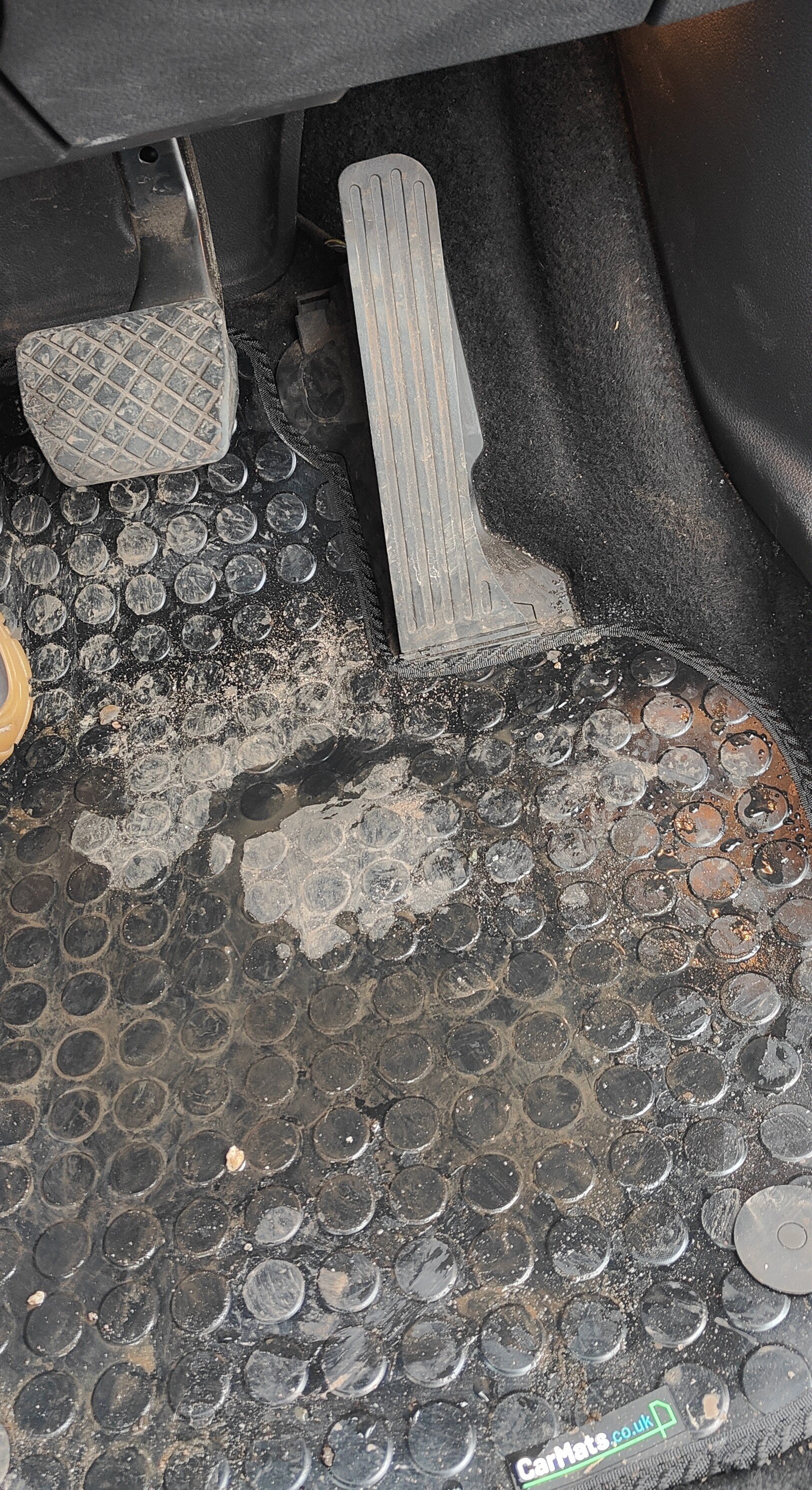

After just spending out on Cambelt/water pump, gearbox oil change, both front wishbones and headlight sensor, I had rather hoped i`d cracked this but it appears i now have water ingress into the drivers footwell? It doesnt appear to be a great amount but it is worrying nonetheless. I have the panoramic roof that is also half a sunroof but there doesn`t appear to be any staining or wet around the headlining so am wondering if this might be a blocked scuttle or something like that? Is this a common issue and whats the best way to rectify please anyone?

Yes it does have the sunroof, but am really puzzled by this now. Substantial puddle of water yesterday. dried it all up, has been raining pretty much all night and this morning when I check barely anything at all just a small patch about 3" in diameter. splashes evident under dash near throttle pedal, but cannot feel any wetness under the dash on a cursory feel.. If it is the sunroof, how easy is it to access the drain hoses to check for blockages/or detachment?

sadly, it would appear the issue is not sorted after all the rain we have had. Opened car door Monday morning and found another pool of water on the rubber mat. I`ve been back to the garage and they are going to have another look on 18th feb (earliest they can fit me in). This now has me wondering if there is anywhere else this could be blocked apart from the front drains which have been dealt with, or if it is actually coming in from the windscreen? Extremely frustrating as I just want to enjoy the car, but all this is putting me off somewhat...

Since I last posted on 7th Feb, we have had all sorts of rain, torrential, misty rain, normal rain, whatever you can think of and nothing has come in so I cancelled the appointment to investigate further. Last night we had 50mph winds and driving rain and when I looked inside car this morning a very tiny pool of water around 2" diameter was on the rubber mat.. This defies logic so for my own piece of mind can anyone tell me or show me a pic of where the drivers side sunroof drain actually comes out under the wheel arch please? I`m going to try threading some 3mm strimmer line down the drain and see if it comes out to confirm the drain is intact first off.
