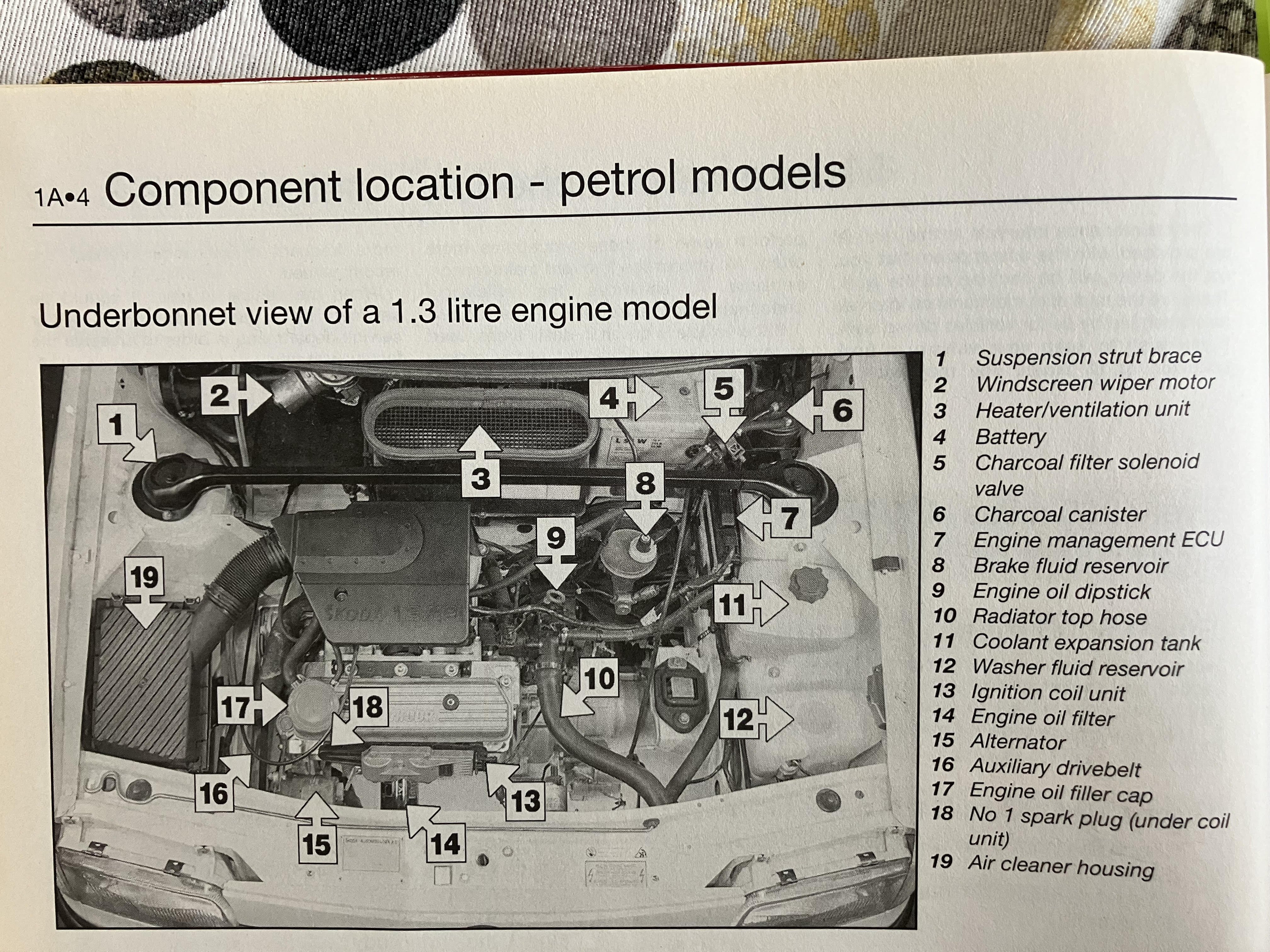

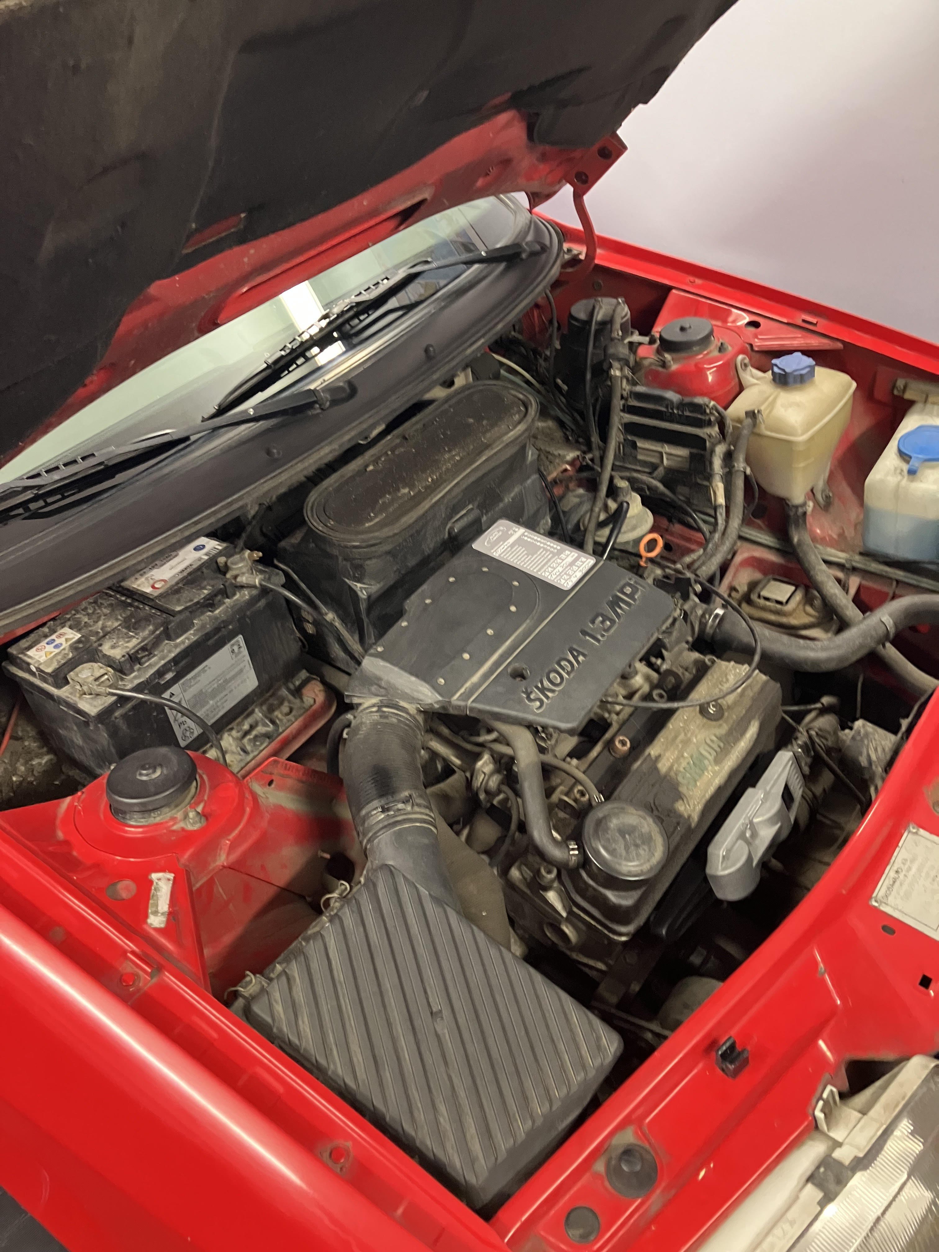

Hi All, I did take a look on this site to see if it had come up before, but I didn't find anything - my newly acquired Haynes manual shows a suspension strut brace in the engine bay, yet my Son's Felicia doesn't have one - does anyone have any info on this?
Does it have airbags?
Edited by Thefeliciahacker
I don't believe so.
7 hours ago, TonyW1967 said:
I don't believe so.
Yep, that makes sense. They rarely had it if not for airbags

I haven't noticed any difference with and without it, they used it for providing better airbag acceleration detection
