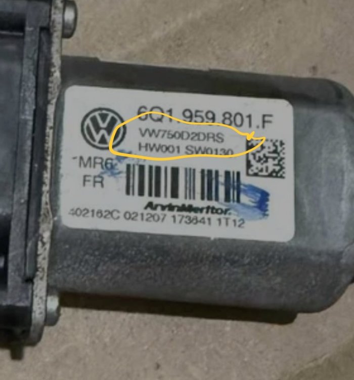

Secondhand units on ebay can be found at prices competitive with repair, but be alert to the fact that the same base part number 6Q1959801F is used also on some VW models, where they are mounted differently. Compensatory software differences mean that Skoda and VW ones aren't functionally interchangeable, despite physically fitting.
Up and down will be reversed relative to switch inputs if mixed heritage parts are fitted.
VW parts will have a number under the 6Q1959801F that begins VW240 (Polo) or VW750 (T5).
Skoda versions have SK250 (mk2 Fabia) or SK258 (Roomster).
Get the correct one if going for second-hand.

The VW/SK info is there on the part number label.
Generally best to go by the label rather than sellers' descriptions, hardly anyone really understands the interchangeability, or lack of, amongst these units.
I'll message you shortly, and I may make a little 10 or 20 second video showing how to disassemble these units without damage.
