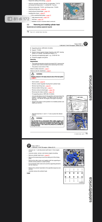

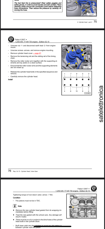

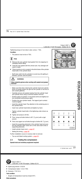

removing the cylinder head, could someone please tell what is the sequence of removal and fitting of head bolts. Picture would be nice. Also, the torque sequence of new bolts please. Much appriciated.
Should be this
