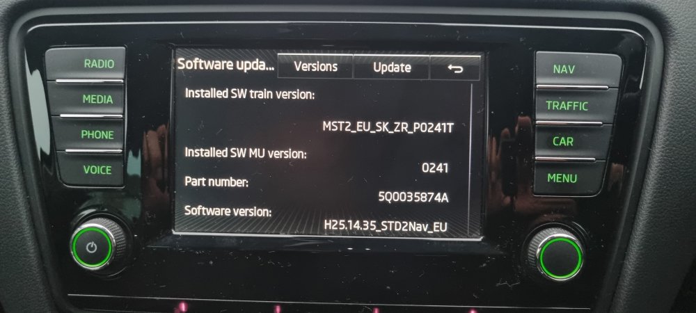

Having problems with my infotainment system skoda screen comes on radio starts playing but start up screen dosnt go off, after couple of minutes it reboots by itself but dosnt get any further.
Picture was taken a while back @pab567 any ideas? I've tried holding power button and tried disconnecting battery
Hm, I would start with software reflash but in such case it can be done only in emergency update mode which requires UART and PC. Unit mut be rather on bench than in the car as it must be open.
@pab567 Just seen a youtube video doing this, looks a bit complicated any ideas on where I could get this repair done I'm based in Yorkshire
