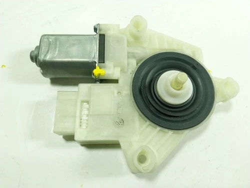

Should you be able to turn the white plastic gear in the centre of the black rubber seal?

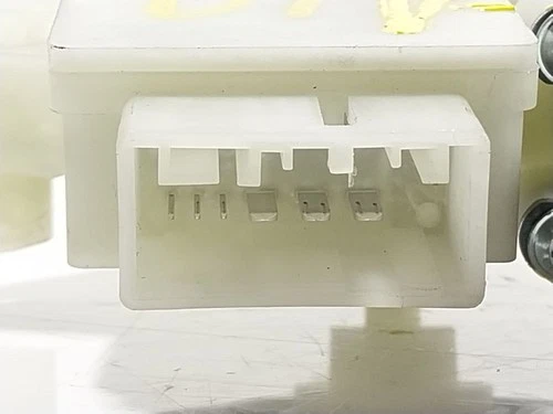

Is there a way of testing the motor, perhaps by applying 12 volts to it.
There are 6 electrical connections on the connector block, three large flat and three small pin shaped.
5JA959811K LEFT FRONT WINDOW MOTOR / 50A959811K / 17447064 FOR SKODA FABIA III - Picture 4 of 10
Any idea which ones to use?

No, you shouldn't be able to turn that cog, the motor shaft has a worm gear on it, and those don't work 'backwards'.

How many wires and ways in the loom connector?
Circuit diagram shows a 10 pin connector at motor, permanent 12V on red/yellow at pin 2, brown earth at pin 3, passenger side switch inputs on 5 and 6, green/black and black/grey respectively.
Then inputs from driver's side switch on 7 and 4, red/violet and brown/black.
I don't see a way to power motor itself directly without disassembling the motor.

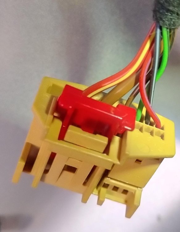

Connector look like this:-
Thanks. AG Falco

Ah, just spotted the empty 3 positions in front of contacts 5, 6, 7 making it potentially a 10-way connector. Was scratching my head til then.
Everything seems to correspond colour-wise.
