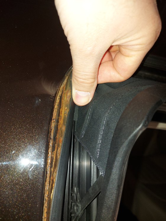

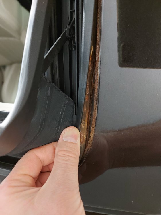

I have an urgent rust problem near the panoramic roof seal. So far, there's no leak. I plan to take the car to a body shop shortly, where the rust will be sanded off and the entire roof will be repainted. The seal will, of course, be replaced with a new, original one.
The body shop told me that the repair might not be effective, meaning the problem might recur after some time due to moisture, which could be getting under the seal's mounting due to a design flaw. Has anyone else had a similar problem? How did you resolve it?

I’ve got the same thing going on, bubbling up around the edges of the rubber seal.
I’d be amazed if Skoda uk would honour the corrosion warranty, I’m at some point going to speak to a local body shop to get advice on repair and their opinion as to what’s caused it.

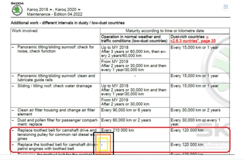

@Peltsu Has your 9 year old car had Body Inspections during services or the Sun Roof Serviced where there could have been Corrosion spotted early on? When did you first see signs of rust? Inspections are not actually in the Skoda 3 year paint warranty or 12 year corrosion warranty T&C,s . Yet Skoda / VW often say 'no record of being done'. Yet Body Inspections feature as part of Skoda / VW Main Dealer Servicing. So with a Service Record if no record of an Inspection they know who do not do it. .......................... How many people are offered a Sun Roof Service or pay to have it done?

In my case, I only spotted the corrosion around mine after the original post was made, I’m a slightly shorter than average guy so didn’t notice but once I looked, it was obvious. I have done nothing about it as we were in preparation for a long holiday in France but I will do as I said in my first post and go to a local body shop to get a report from them. My car has an impeccable dealer service record from the first owner and I’ve done my own services and had Haldex and gearbox services completed at a vw/skoda specialist but I really don’t see the warranty being honoured even if it had been done at a dealership all its life.
It appears that it is because the rubber surround has not been sealed well enough that has caused the ingress of water. I have a 26 year old turbocharged Volvo with a factory fitted sunroof with no such issues, there’s plenty of corrosion in other areas but not there!
