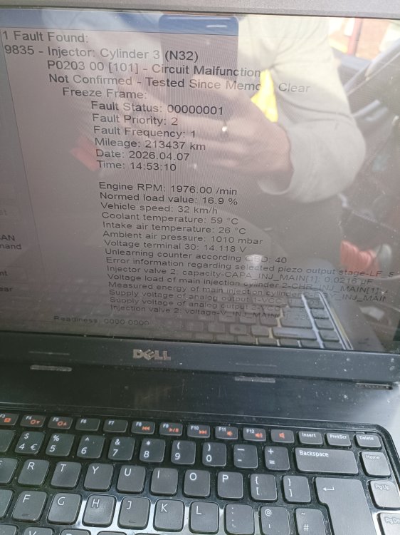

Update the wife had done about 400 miles of driving since getting the car back and today she got a solid glow plug light and the car started running very rough. When I got in, I plugged vagcom in and got code P0203. So it looks like the blue smoke may have been a failing injector.
