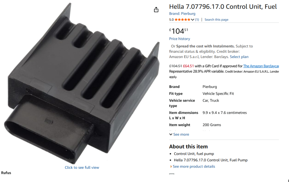

I'm also looking at the unit and I can only find it on Amazon and I'm not sure if it's the correct one. Amazon says it is but I need some clarification before ordering it.
Any help appreciated both on whether this is correct and also how to get it out.
