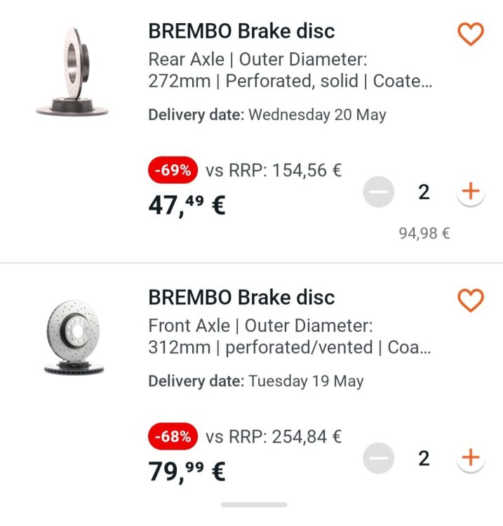

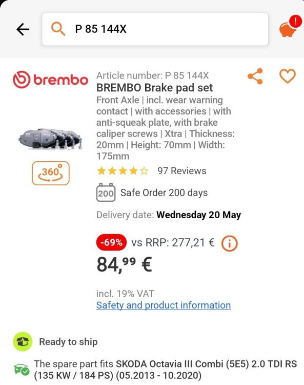

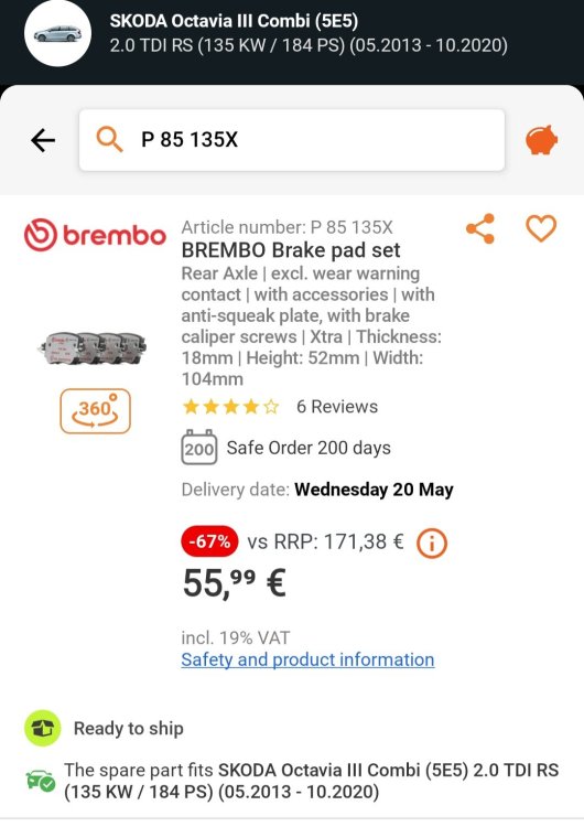

Hey! I'm currently trying to replace all the Discs & Pads on my 2013 2.0tdi vrs 188hp
Used autodoc, bought parts that "fit" didnt fit... so looking to see if anyone has a bit more knowledge on the correct parts before I buy them.

Best advice to find the correct parts is to go to Skoda-Parts.com. Create an account and then you can use your VIN by adding a car to the garage and then you can find the correct parts numbers that you can search by on most car parts places.
Your fronts will probably be 340mm. They reduced the front brake size at some point though hence why the 312s were suggested. Rears are likely the 272mm. There will be a sticker in the boot with all the codes. 1kt is likely your brake code and AUTODOC should reference the code. That’s where I got my manuals. Not sure if they still work https://www.hypermiler.co.uk/skoda/skoda-octavia-mk-iii-2013-workshop-service-maintenance-repair-manuals-downloads-inc-vrs-free

It's unlikely to have the PR code for the front brakes, which is separate from the rear brake PR code.
