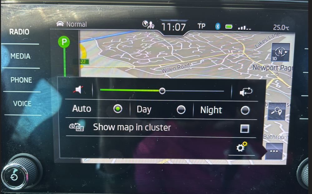

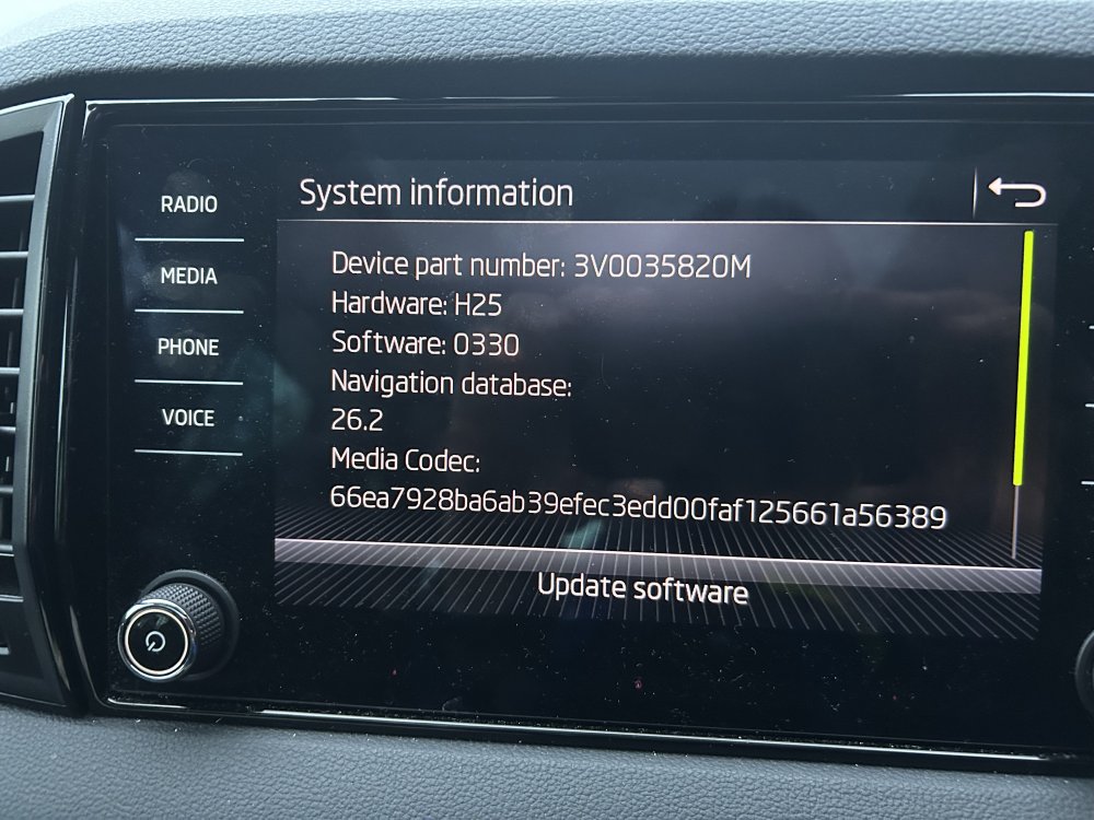

This is the hardware and software versions in my 2023 Sportline. I suspect your car will have later versions of both. With my Karoq the built in sat nav has a setup tick box to show the map in the centre of the classic VC dash and then it shows the compass on the main screen. If unticked (the setting I use) it shows the compass on the centre section when Navigation is selected for the centre section by the button/scroll. The route guidance ie next turn info automatically gets displayed on the centre section when the route is selected. I couldn’t find a way to get CarPlay display anything from the iPhone screen in the centre if the VC dash. I’d be interested to know what the hardware/software versions your Karoq has as I ditched CarPlay 18 months ago because it didn’t seem to be integrated with the dash or steering wheel controls.
@thamestrader thanks for your response! I will check the hardware / software versions and post them later. How do you access the setup tick box? I wasn’t able to find that option when I was searching last night.

Its on this screen - tap the three dots bottom right on the map display screen. I have it unticked as I prefer to have the map on the main screen and use the centre dash display for the Phone when not 'Navigating' and the turn by turn guidance automatically gets displayed in the centre of the dash, at the end of a route the centre section reverts to displaying the compass, so I have to manually Telephone via the scroll wheel. I guess we'd all like to have the ability to define the default position on startup, and probably the ability to decide if every start should default (which would be problematical for stop/start) or whether the default should only apply after 2 hours like the 'Since Start' driving stats.

@thamestrader Thanks again for responding. I don’t see the option to show map in cluster unfortunately, most probably because the hardware / software versions are different (see attached). Really frustrating.
