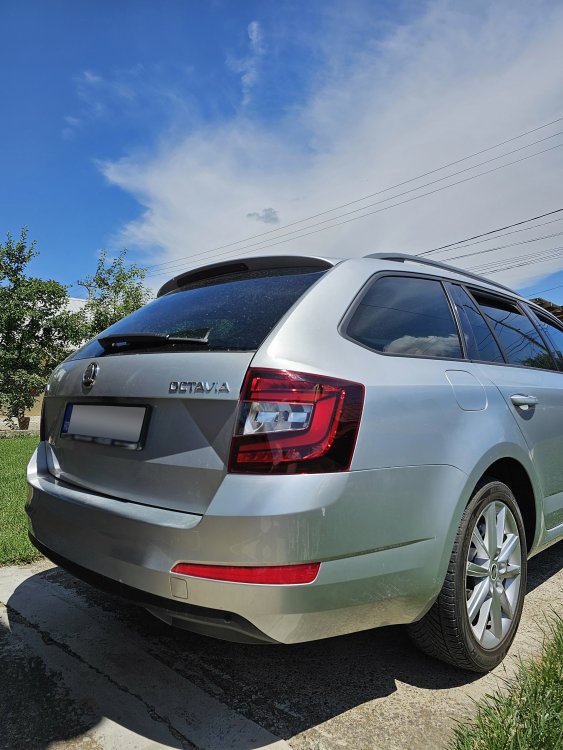

I was searching the forum about this topic and the solution was eather buying 80 euro adapters or watching a video that is no longer available for diy. Looking more in depth I've found this on a SK forum, I hope there is no issue sharing it here.
When you are searching for the tail lights 5E5 = sedan, 5E9 = combi, and be sure that the bulb carrier and harness is included!

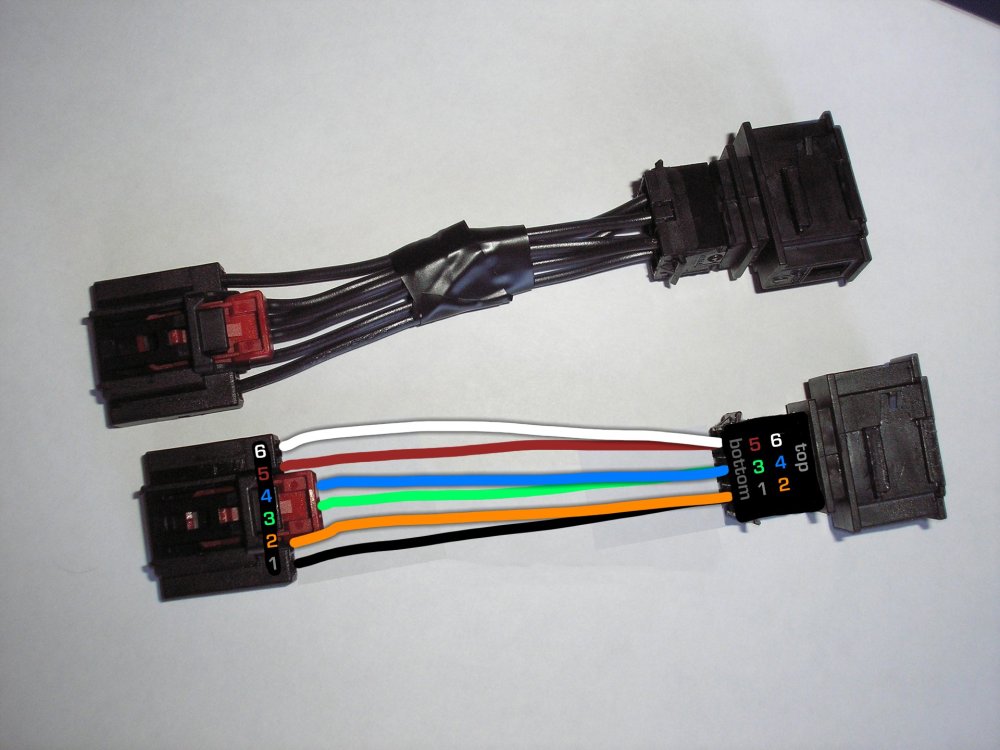

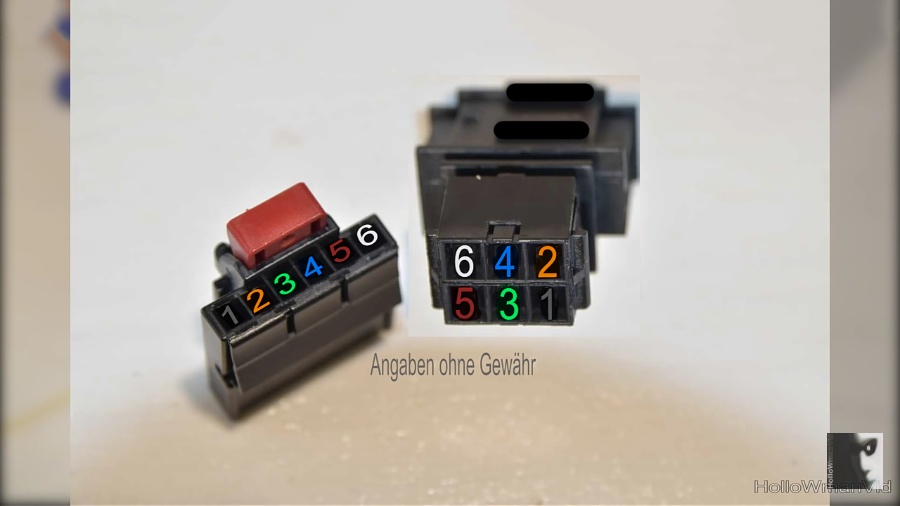

Option 1 - Make an adapter:
  • 2x 3C0972733 (Combi)
  • 12x N10336105 (Combi)
  • 2x 1S0972706 (FL)
  • 6 wires 0.8 - 1.0 mm2
  • 2x 191972716 (Sedan)
  • 12x N10318905 (Sedan)
  • 12x N10335807 (FL)

Option 2 - Cut the old connector, follow the wiring scheme to add the new connector so it will look like it came from the factory:
  • 2x 1S0972706 (FL)
