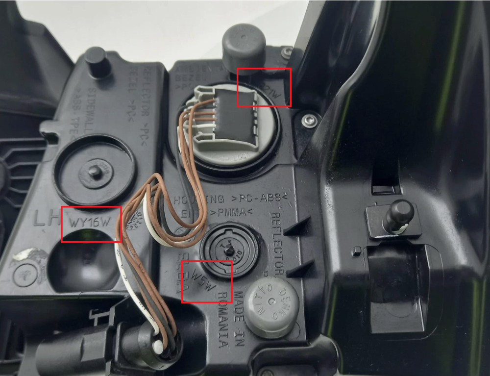

27 minutes ago, DerekU said:
though the specification of the bulbs themselves is not stated
Can generally be found molded into the plastic of the bulb holder, for example:

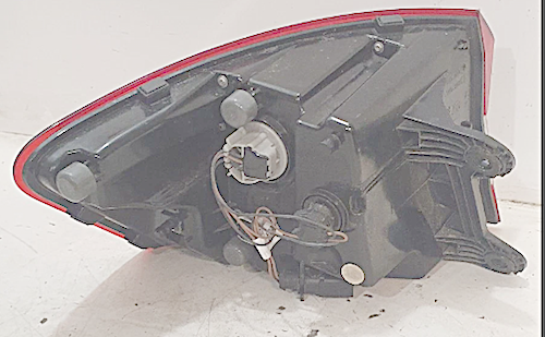

This was asked about here in 2023, but did not elicit the information requested.
An image in the "Tail light assembly" section of Fabia Mk4 Owner's Manuals SUGGESTS that the light-unit has 3 bulbs (which, as the unit provides brake, direction and position functions, would make some sense).
On my 2024 car the direction-indicator bulb is easily visible. It is amber and 'round-headed' (so possibly a PY21W type). The other bulb(s) are impossible to see with the light-unit in situ.
I've studied several photos showing the rear of the light-unit (example here)
but (so far) I have not been able to identify any obvious bulb-type identification markings.
Many (pessimistic) car owners will either carry spare bulbs or at least record the bulb-types that are needed should replacement be required.
As the "Replacing light bulbs" section in the Owner's Manual begins "You may replace the following light bulbs yourself" and only bulbs in the front fog-lights and in the tail light assembly are referred to, one might reasonably expect the Manual to specify the bulbs that would be needed, rather than a Fabia owner having to remove a failed bulb in order to identify it.
If brisF1 is going to replace a bulb in his car's rear light-unit, perhaps he could check whether the unit carries any bulb identity-markings, or (if not) check and identify the bulbs themselves.
