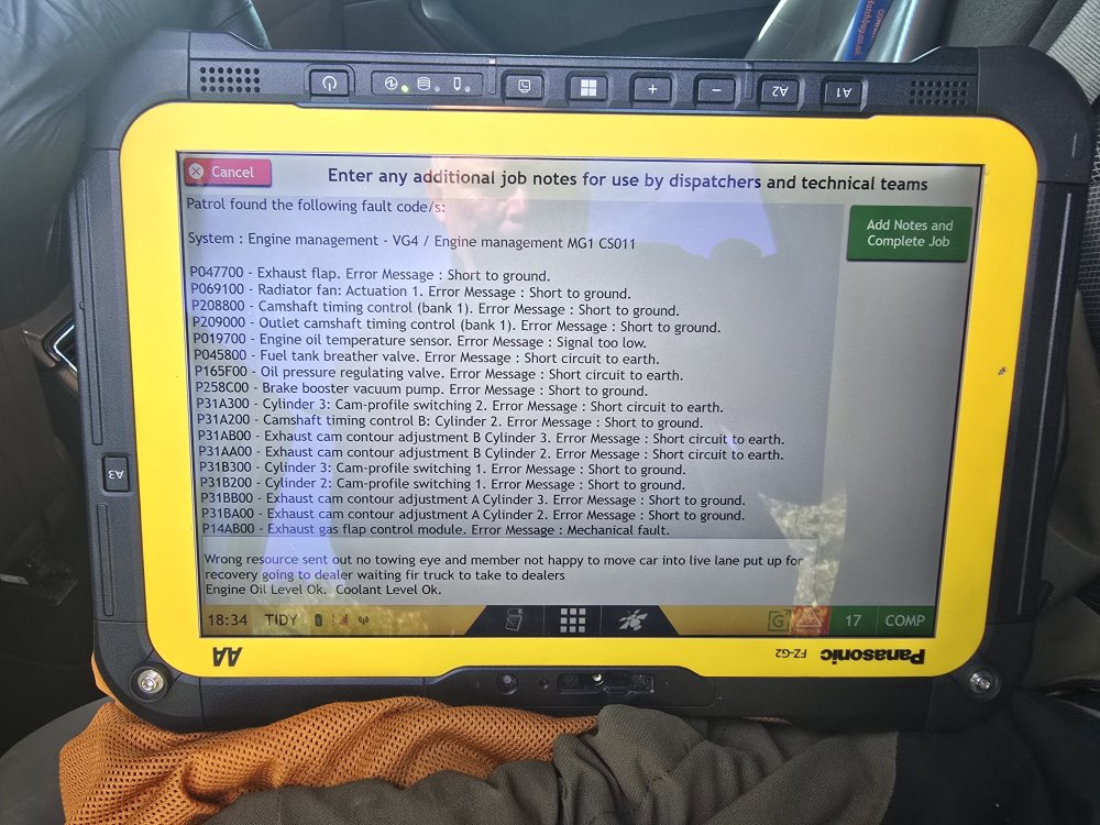

Here are the codes the Aa downloaded.

I'm no expert, but looking at the data on the AA scan tool there appears to be quite a few 'short to ground / earth warnings. I would be looking for possible damage to a wiring harness.

This might help.
Thats a lot of short circuits etc. Might be worth checking if the oil pressure regulator shares an earth with any or all of the others.
