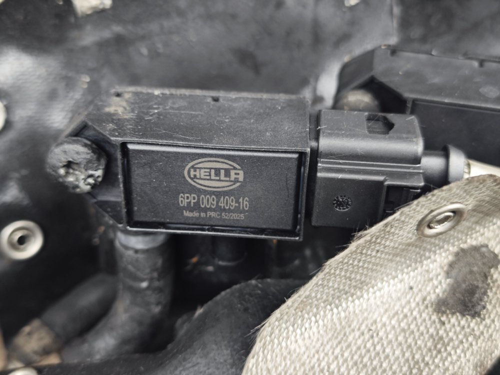

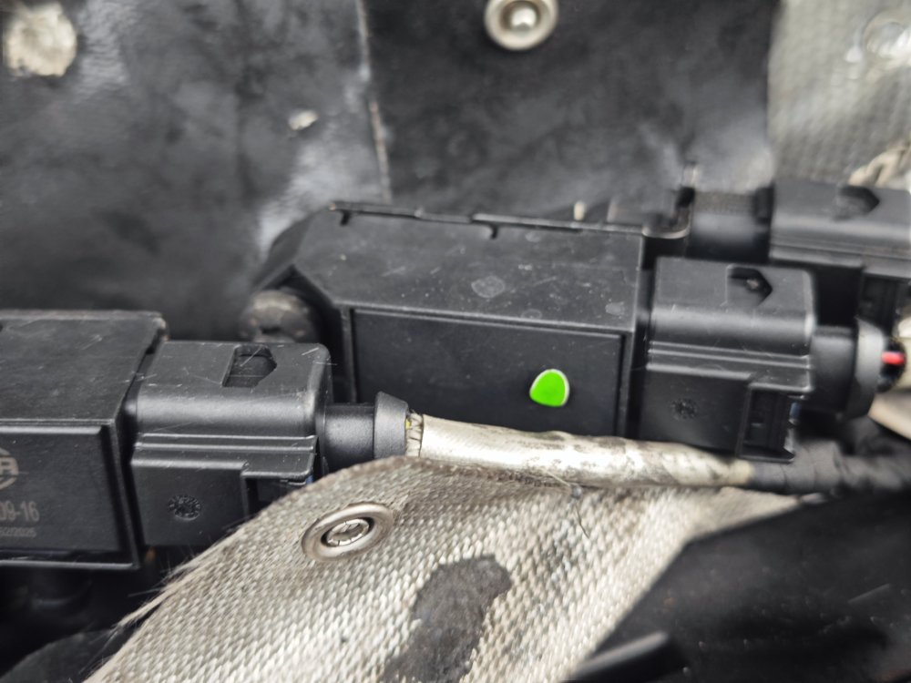

I had a look for the Exhaust Pressure Sensors, seem some one has been having a play already, to me it looks like they are both non original, there is pipe clips missing and the heat shield was ripped!
Is there a site I can find out what are the original part numbers are?
I looked at the PDF values to i think my oil matter levels are high, will the kind of DPF cleaner you add in via the sensor tube clean oil out of the DPF?
Well I found the part number, AI FTW when searching for such info:
  1. Hella part: 6PP 009 409-161
  2. VAG OE numbers: 03L 906 051 B / 03L 906 051 D (03N906051B/03N906051C are the same physical sensor under a later superseded number, also cross-listed)
  3. Confirmed fitment includes Octavia III with CUNA (184PS) 2.0 TDI — so this is the correct family for your car, and genuine part numbers for this Hella unit are 03L906051B, 03L906051D, with Hella's own number 6PP009409161
I ordered some replacements from eBay that said they were compatible but they had the wrong connector so they were sent back! I removed and swapped back the ones that are installed and while doing so found out they were not fitted very well, so swapped they around and tightened up all the bolts and added a new spring where one was missing. All seems to be working right now after clearing the fault and going for a little drive it did not return so I did a forced driven regen.
