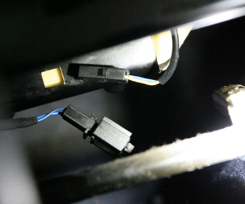

Sorry for the massive bump but... It was also driving me insane and unplugging the connector has worked a treat, thanks! Took me a few goes and was a bit of a struggle (I was trying to do it alllll wrong at first), so took some photos and will bash them up tomorrow.

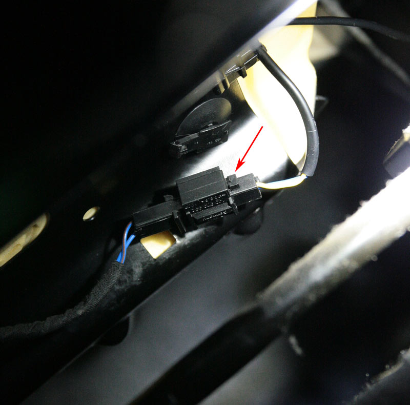

I read a tip about jacking the seat right up (which was useful - thanks) but for some reason I tried to get at the clip from the rear at first - fail. It's much easier from the driver's footwell, with the seat pushed back a bit.
To give you an idea of where it's located, you can see the handbrake top right of the photo (sorry about my light being in the way confusing things). The clip is pretty much in a direct line with there the light is pointing, fixed to the underside of the seat.
The assembly is fixed under the drivers seat. Red arrow points to a clip that you can spring up allowing you to slide the assembly off and get a bit more room to play with.
Once that's off, there is another spring clip holding the two components together. I pulled this back with my fingernail while tugging on the left hand side of the assembly (pulling it from right to left of the photo). Once the cable is pulled tight it comes apart easily.
Success! No more bonging! I fitted the larger clip (bottom one) back under the seat to stop it waggling about.
