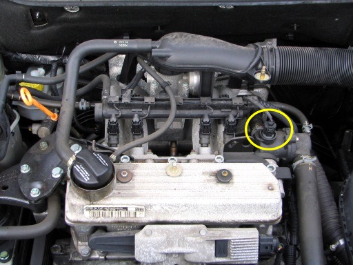

2a. The coolant temp sensor is here on a 1.4 MPi:

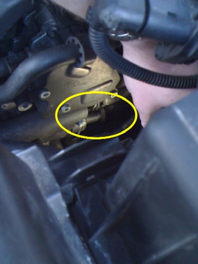

2b. ...and here on a 1.9TDI PD, on the right-hand side of the engine, tucked away, facing the back of the engine bay and with the socket release catch facing away from you! :doh: :
(This post shows where it is on the 1.4 16v, but, I've not done the job any other cars to say where theirs are. All the same, if you follow the fat coolant hose back from the radiator and along past the right-hand side of the engine, you ought to find it!)

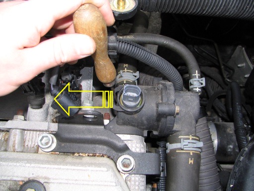

4. Unclip the sensor from its plug, and separate the two:

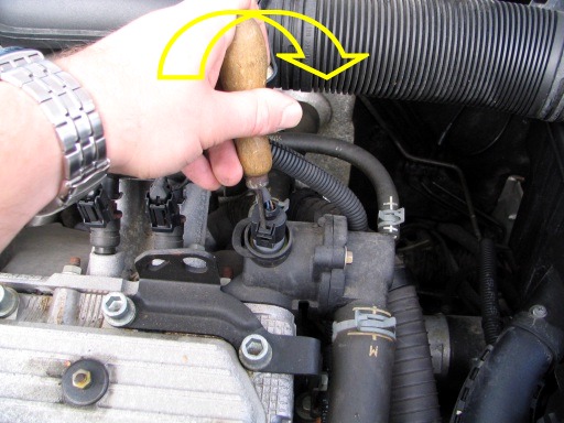

5. Remove the circlip holding it in place:

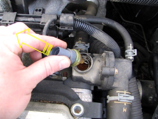

6. Give the sensor a bit of a jiggle and it will come out:

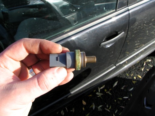

7. The offending article:
8. Put the new sensor in, and put your car back together following the above steps in reverse order. It's a good idea to leave the engine cover off and start the car and leave it idling for a minute or so, just to make sure there are no leaks around the sensor. Once you're happy, you can put the cover on...
9. If you have access to VAG-COM, clear the fault codes. If not, the coolant system seems to work OK regardless, but warn your garage that it's been done, otherwise when THEY read the fault codes they may want to put in another sensor!!!
