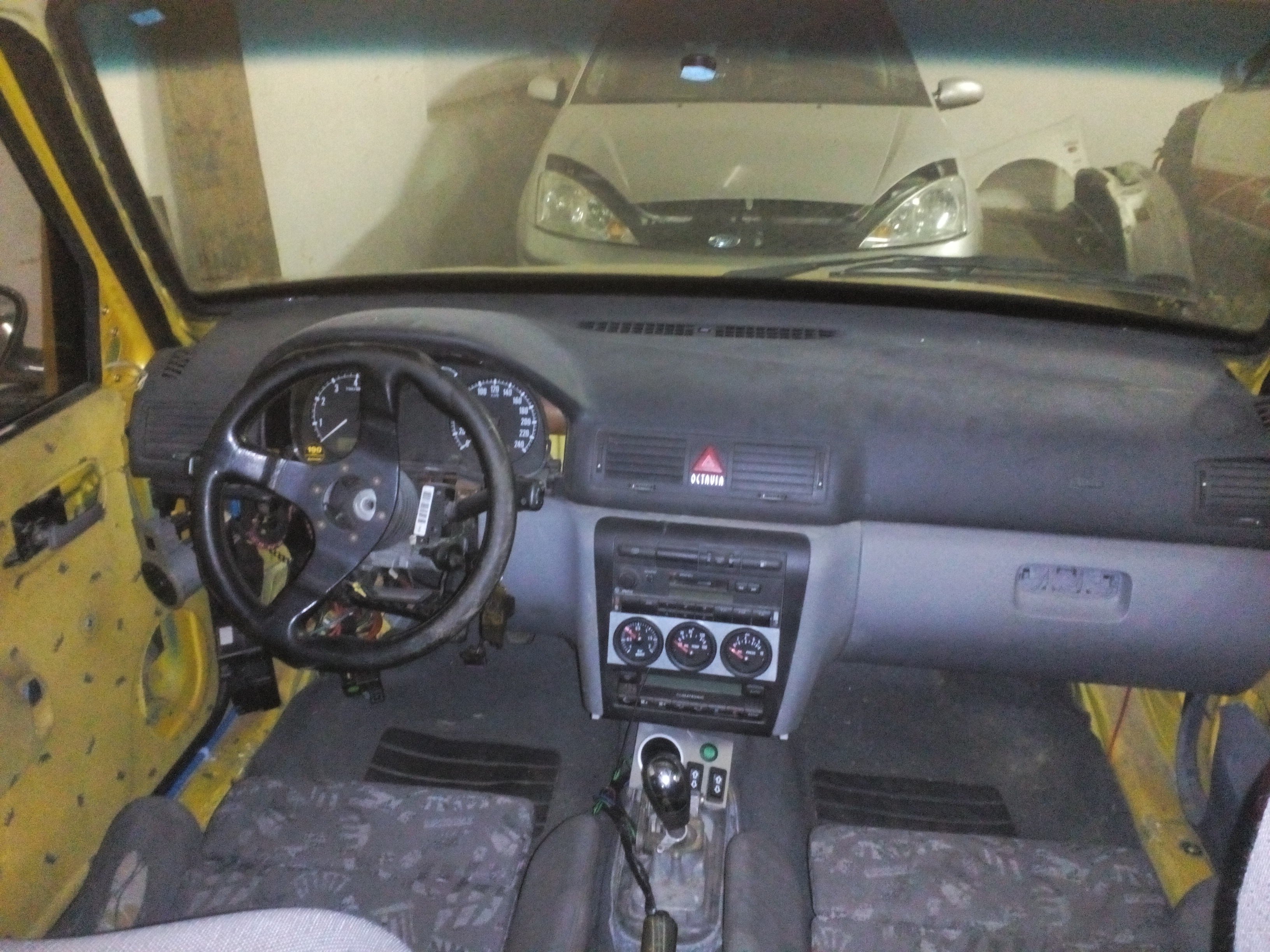

Here's some photos from modification of front part for engine and photos of interior. Engine and silentblocks - Octavia, gearbox - Octavia, shifting - Octavia, steering - Octavia, complete electric and dashboard - Octavia, custom half-axis, custom exhaust (meantime 54mm), cooling radiator - Mondeo Mk1, FMIC - Mondeo mk2... Because i bought new rims with pitch 5x100, so rear brakes was replaced by brakes from Golf VR6 (5x100) and front hubs are custom, brake discs from VR6. maybe calipers from Corrado G60 will be replaced by calipers from Nissan S13 (four-piston capileps)....

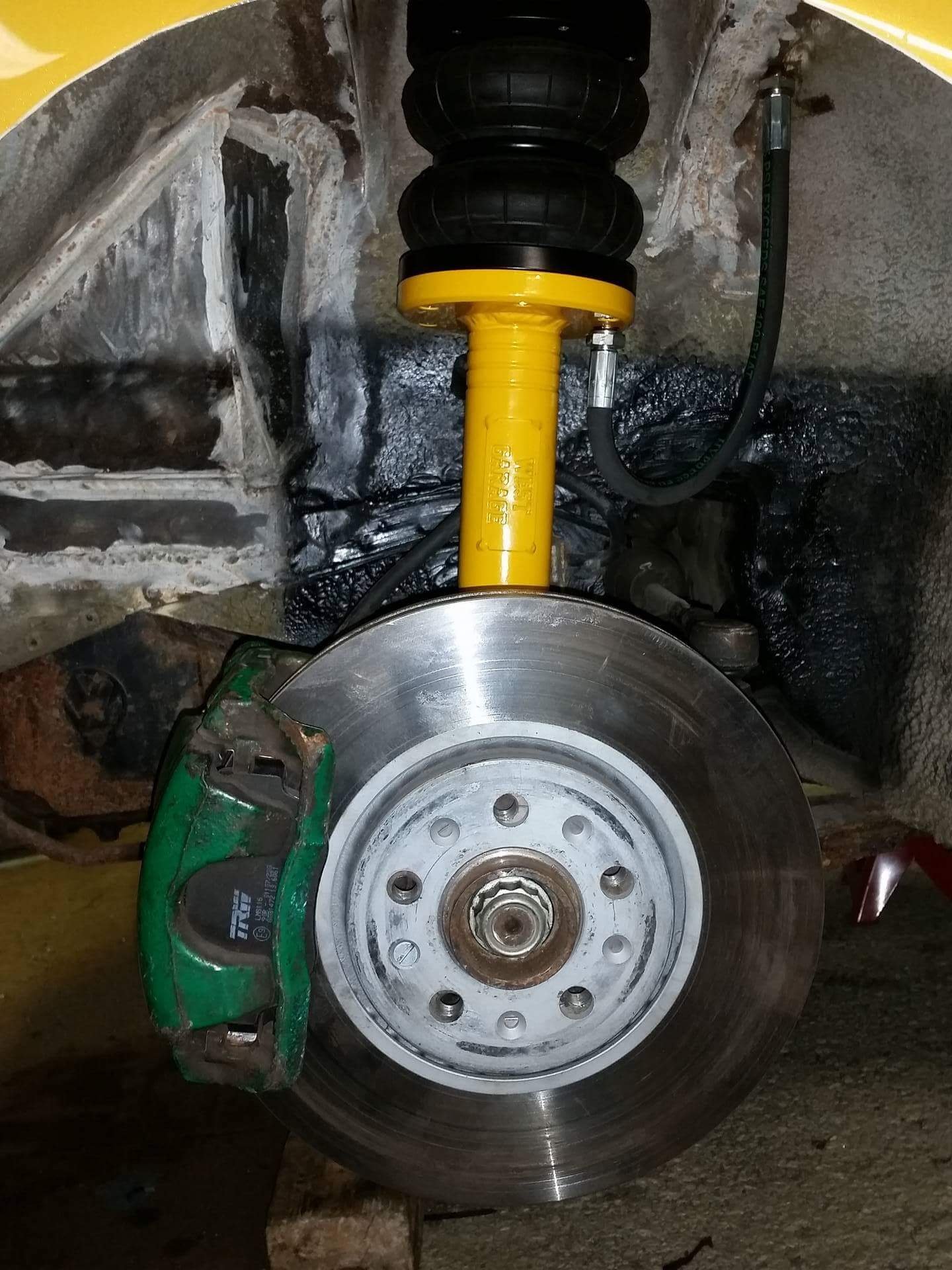

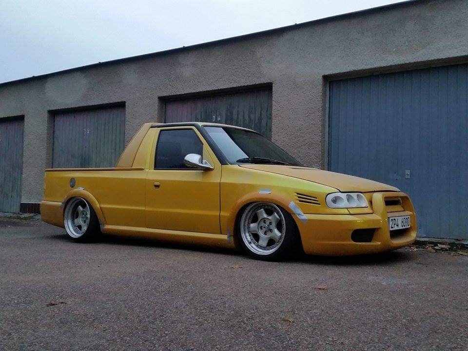

Some newer photos, one year ago. :-)
