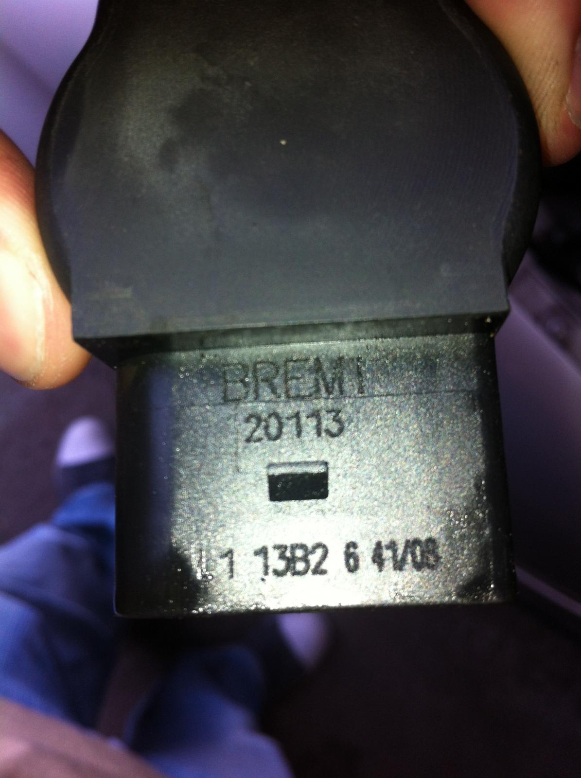

Ok so it seems all four of my coils are different.
If I had to hazard a guess I would say that one of them is genuine, the rest aren't. One had a code on it that ended in a 'K' (I assume this is an original), one had no marking on it at all, but did have a letter engraved on to the metal, one was a Bosch coil and the final one I have pictured below, I assume this is an aftermarket replacement?
This leaves me with two final questions, am I right in thinking every single coil, if original, will have the same markings on it? Finally, does anybody have some original coils hanging around they don't want?

the one in the pic above is def not genuine
