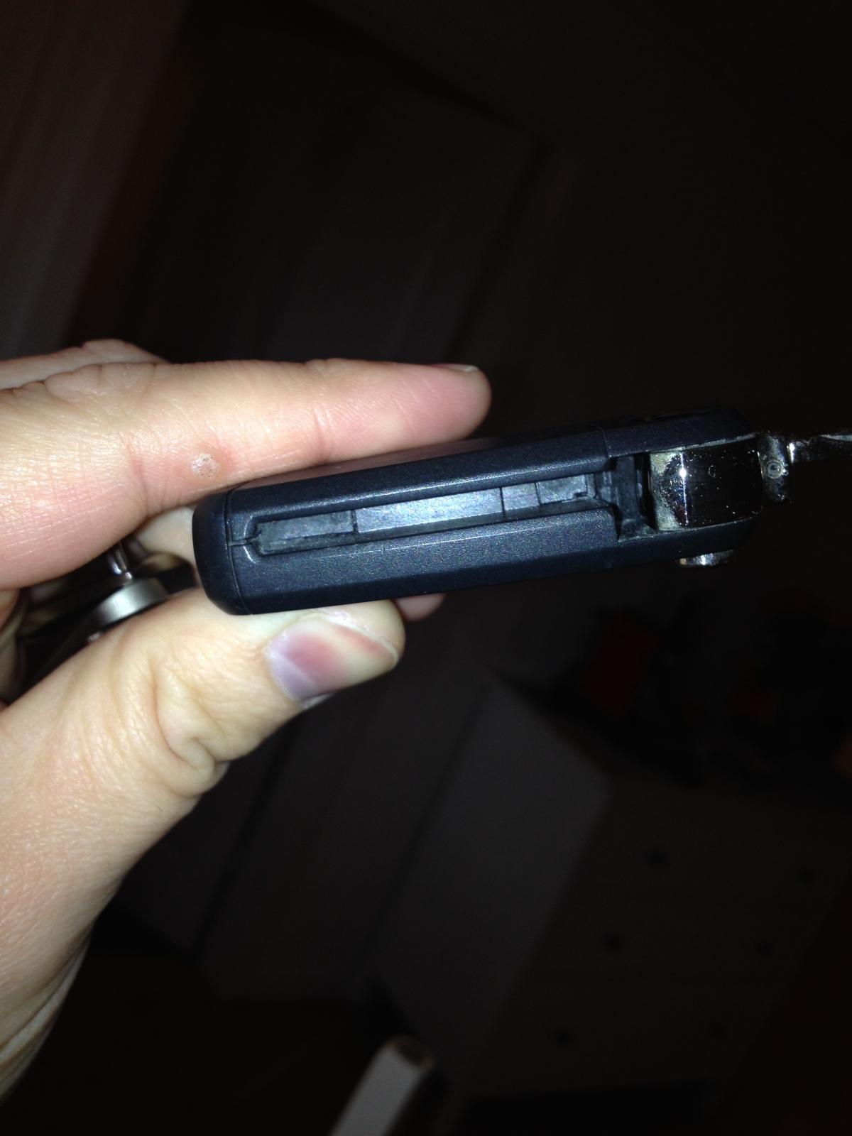

The owners manual sugests that you bring your key to the dealer, or try with a small screwdriver - but where is up the gods to know.. I've tried several times.
I guess its as easy as everything when you know how, but I dont want to apply force without knowing where..
can you post a pic of your key?
We will tell you where to seperate it then :)
EM
Unfold the key, stick a coin in the slot where the key was and twist. Simples.
This is how my key fob looks like.
Not even close to all the ones on YouTube and other DIY's..
Got it!! It was as simple as Neily03 said!
Put something in between and twist!
