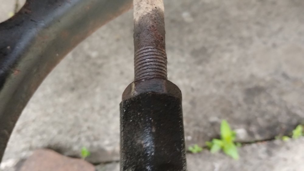

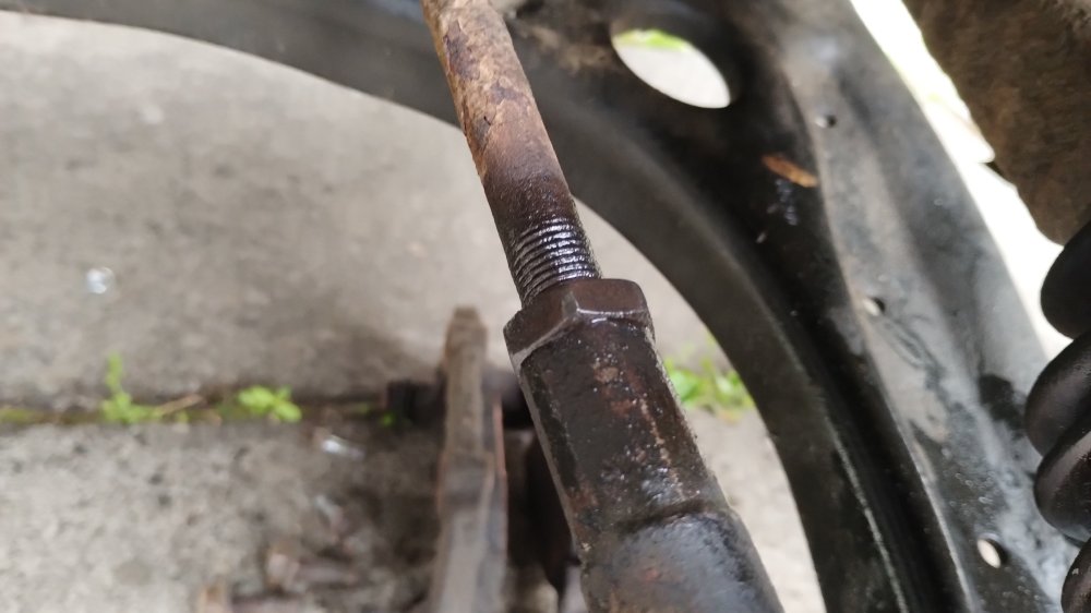

Hi guys,
I'm at desperation stage here. Changed bearings on the car. Ball joints also changed.
The threads on my TREs were goosed from getting the busy off, so I bought new ones to replace them.
My issue is the jam nuts. I have watched/read pretty much everything that's out there, yet these things won't budge.
Tried heat, spray etc.
Is it definitely clockwise for both to loosen them off you are looking at the hub from the outside of the wheel arch?
Lefty loosey when looking from the inside of the wheel.
Drivers side loosen by turning towards the front of the car and passenger side turn toward the rear of the car.
I can't really get much purchase on them as the wheel arch is in the way. Zero progress so far.
Any ideas?
I have considered replacing the inner rods too, although it will be a full car rebuild at this rate!

Which bit are you holding still and which bit are you trying to shift?
Leaving the lock nut stuck where it is, and attempting to unscrew the TRE off it may be easier than trying to move the lock nut inward along the track rod?

Your logic was correct.
Easier to get it right if holding track rod and lock nut still while unscrewing TRE, cos then it is anticlockwise as viewed from where you are. (Assuming outboard of everything is where you are).
If you held the track rod by the flats on it, while trying to shift the nut inwards along it, you would see that as clockwise if sitting outboard of everything.

Turn the steering wheel full lock, so that the TRE is outside the wheel arch.
Use a long spanner and gently tap the other end with a mallet.
HTH.
