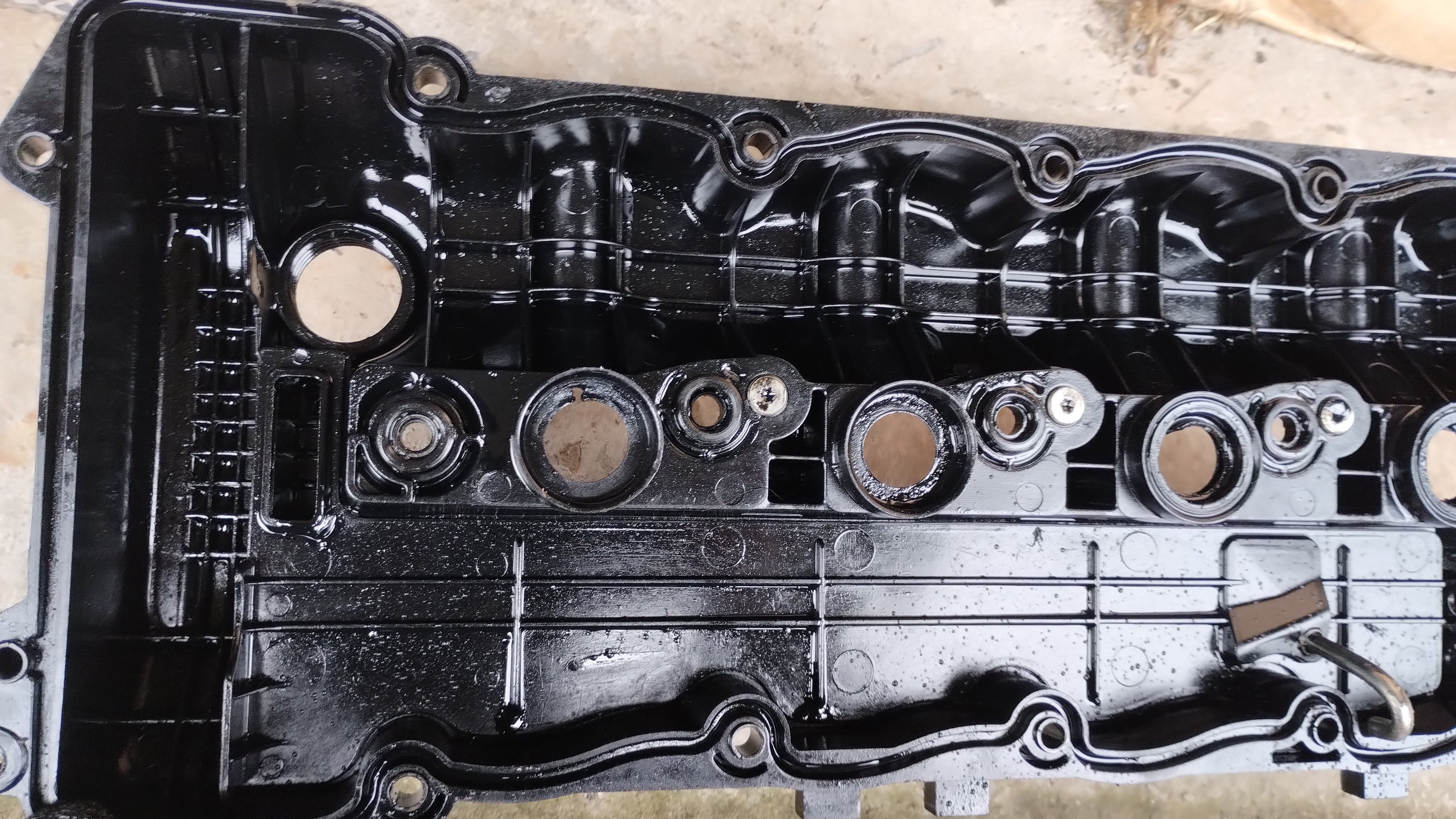

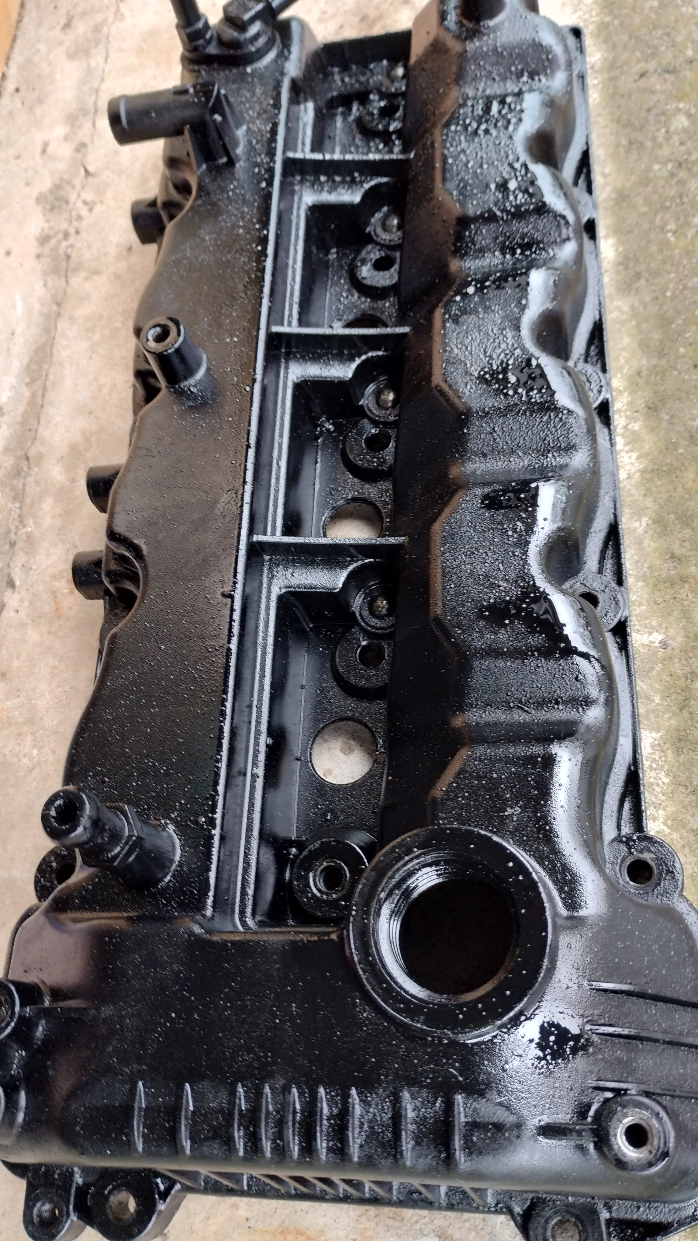

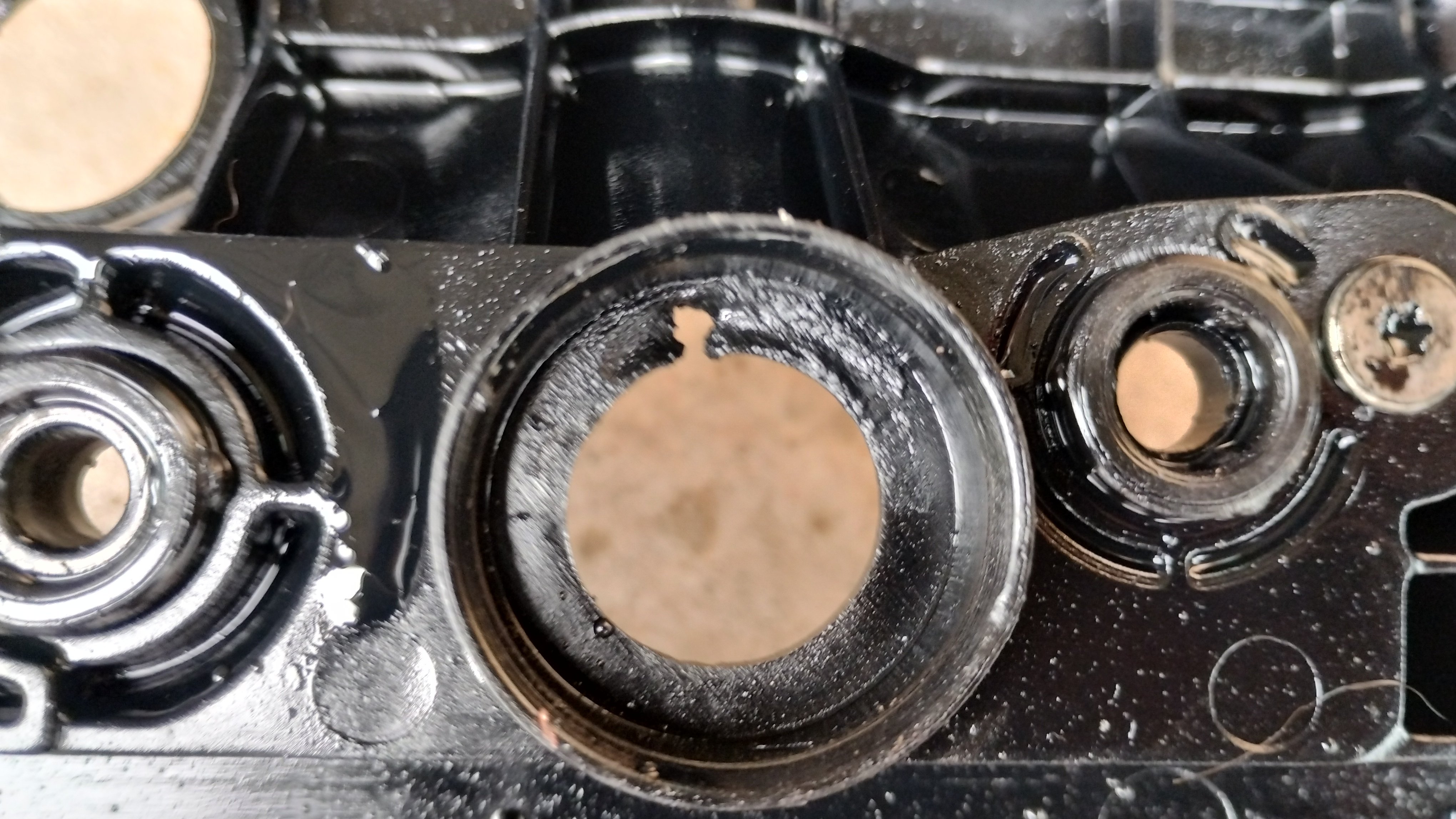

A few picks of the rocker cover. Under close inspection, I can't see any major holes, so I assume the issue is the tiny hole at the injector housing.
Hyundai i40 Rocker Cover Injector Replacement
The car is a 2012 2.7crdi. It's in really good order other than this issue, so ideally I would like to repair it and save a few quid. Missus currently pestering me to pick up another car, as we live in the middle of nowhere and we are sharing a car. First world problems! I will post a photo of the rocker cover/injectors.

Hi guys, Firstly, apologies if this is posted in the wrong forum. Mods, please feel free to move to the correct place! Having owned several Skoda's, 7 in total, for many years, I bought an i40 as I needed a car quickly about 18 months ago. It currently needs a new injector and rocker cover. I have a really good local garage, amazing in fact, although they couldn't source a rocker cover anywhere. I had the car recovered to my house. So far, the rocker cover is off and the injectors removed - by my garage. One injector is goosed and a hole has been burned in the rocker cover, as a result of the injector issue. If I can source the parts, can anyone tell me exactly what I need? Needless to say, I need a rocker cover and recon injector. It is more about the seals etc. Do I just need an injector seals kit? Or do I need additional items? Watched a few videos, so I have a fair idea of what is required to replace the rocker cover/injector. Just want to be sure that I have all of the kit. That said, any pointers to relevant videos would be gratefully received! Used this site many times for sage advice, so hoping for the same again. Alternatively, willing to pay a reasonable amount for fitting if any competent DIYers are nearby in the Scottish Borders. Thanks in advance, Joe.

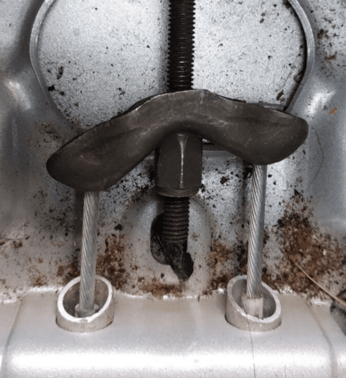

Hi guys, I am back with another issue with our Roomster. The handbrake is not working on one side. It seems like the cable may have stretched and the handbrake does not work on the drivers side. Can anyone give me a starter for 10 on the fix required? Is it DIYable with a set of axle stands? I have all the tools required. I just need the know how! I have attached a pic of the situation. The cables keep coming loose from the the little housing bracket that keeps them in equilibrium. Not sure of the exact name! When you pull the handbrake, one side pulls right out causing the bracket to be totally lop sided and occasionally both cables drop out of the bracket. If you pull the handbrake gently, it will engage on the left hand side, although the bracket is again very lop sided. Hope that makes sense! Cheers, Joe.
