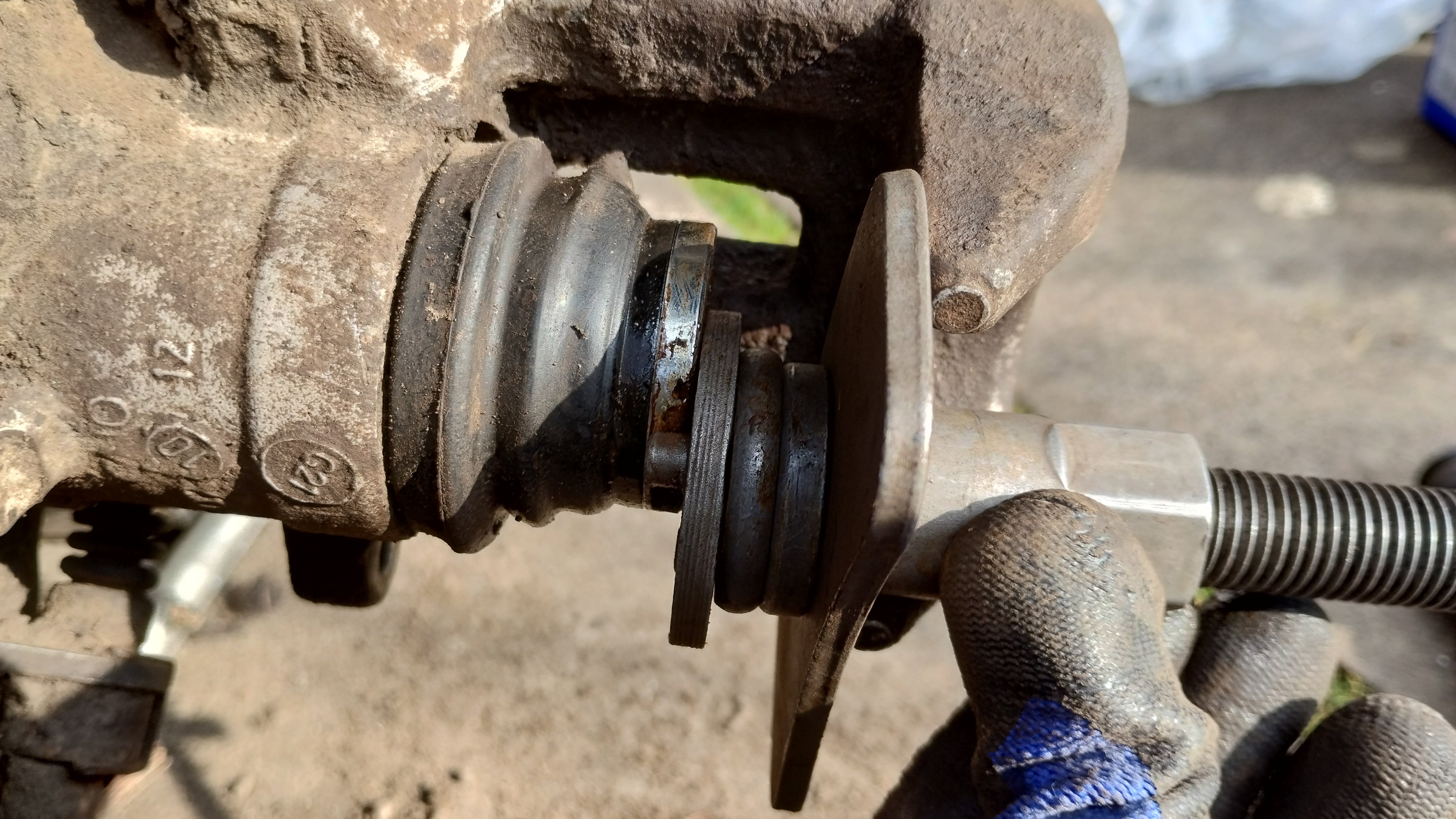

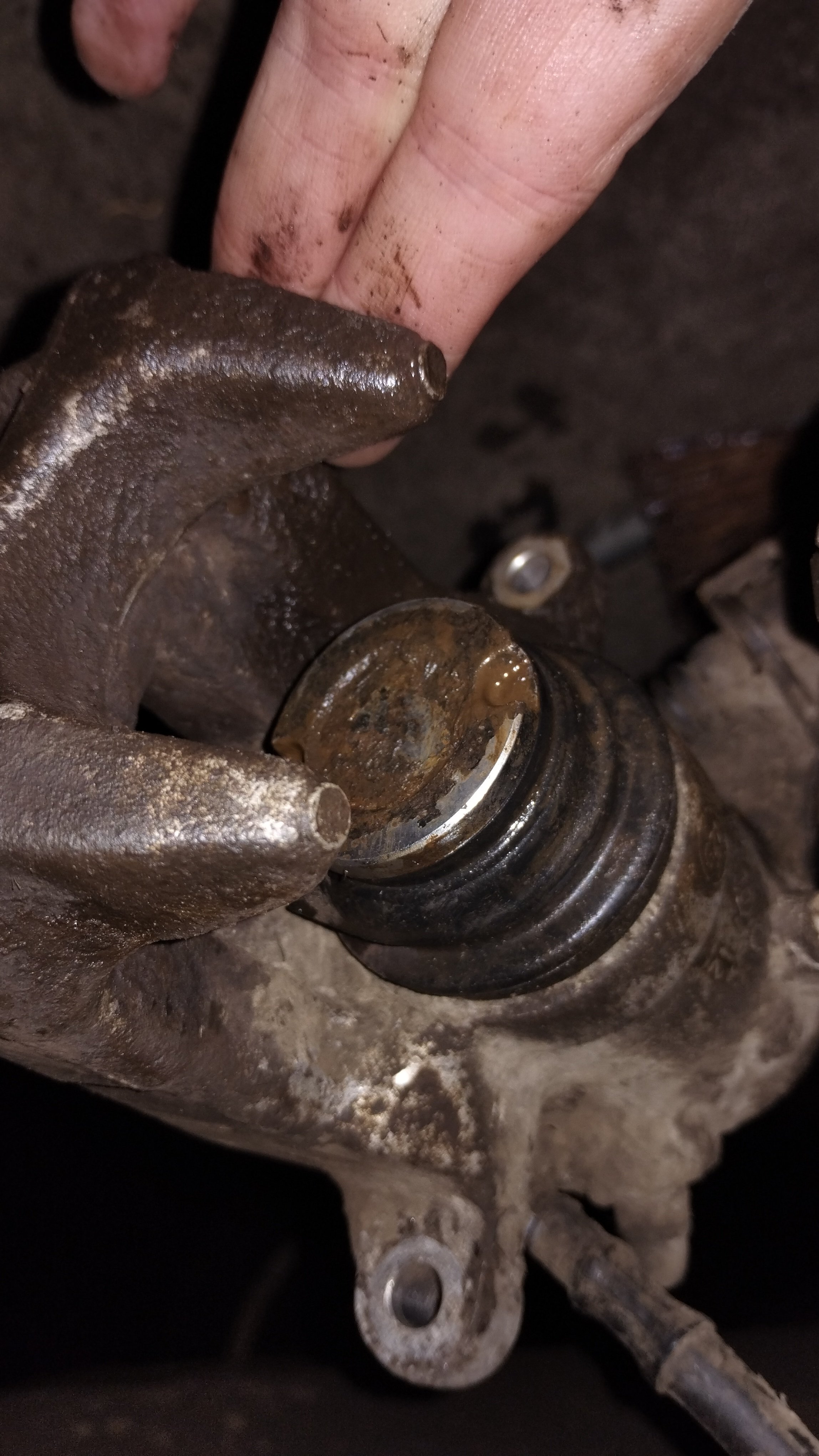

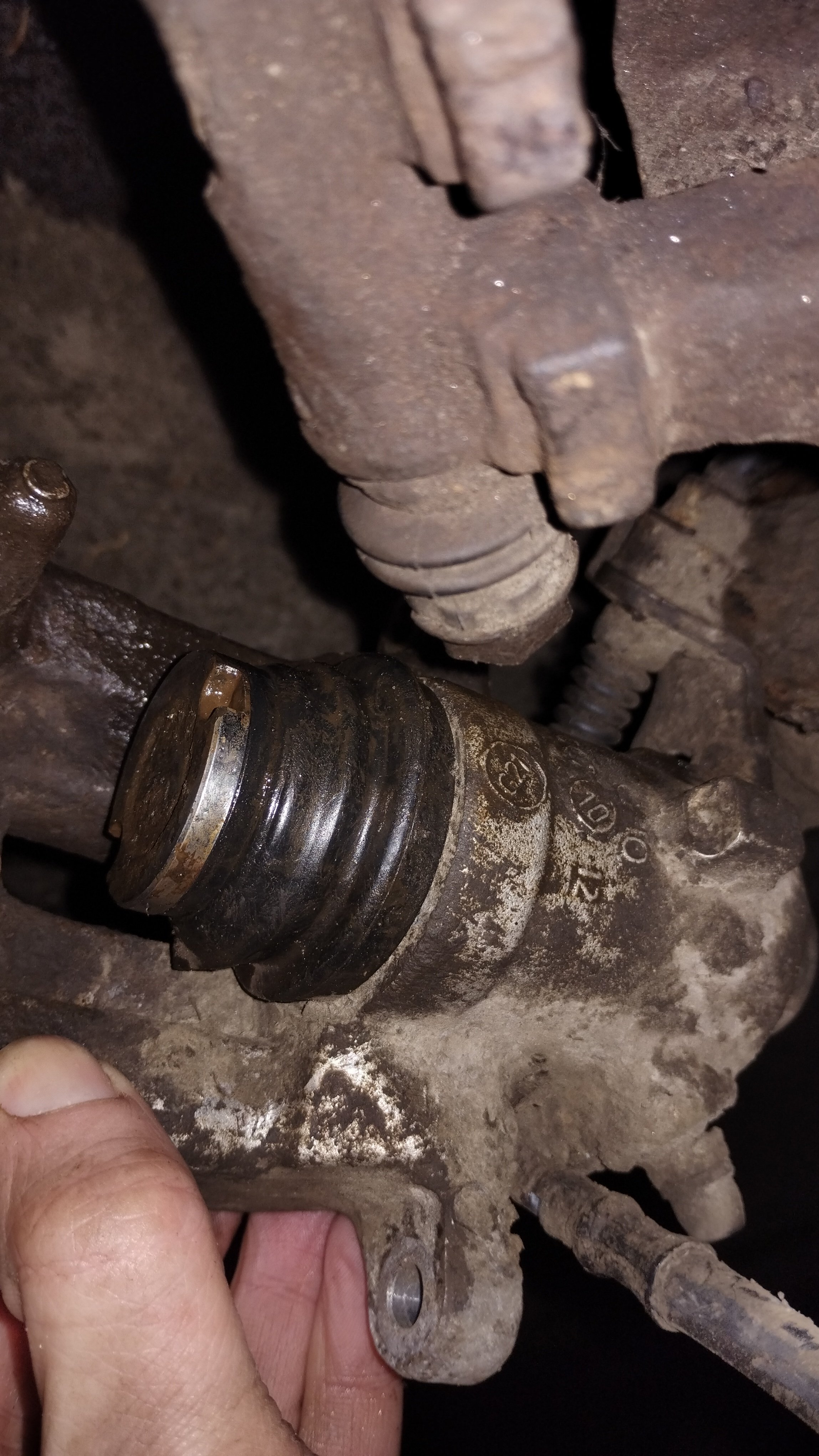

I have hit a bit of a snag with rewinding the piston. It doesn't seem to be winding in fully. The piston is not loose, yet it keeps turning when the Tommy bar goes clockwise. It comes out when going anti clockwise, so I'm fairly certain that it's being turned the right way.
If you loosen it, it gets loose, then clockwise will get it tightened so far, but it stops winding in yet it keeps turning. Not sure I explained that very well!
Any advice on how to get it fully in?
There is a nut behind it on the caliper. Does this need to be held firm as you wind to get it fully in? Otherwise, I'm stumped!

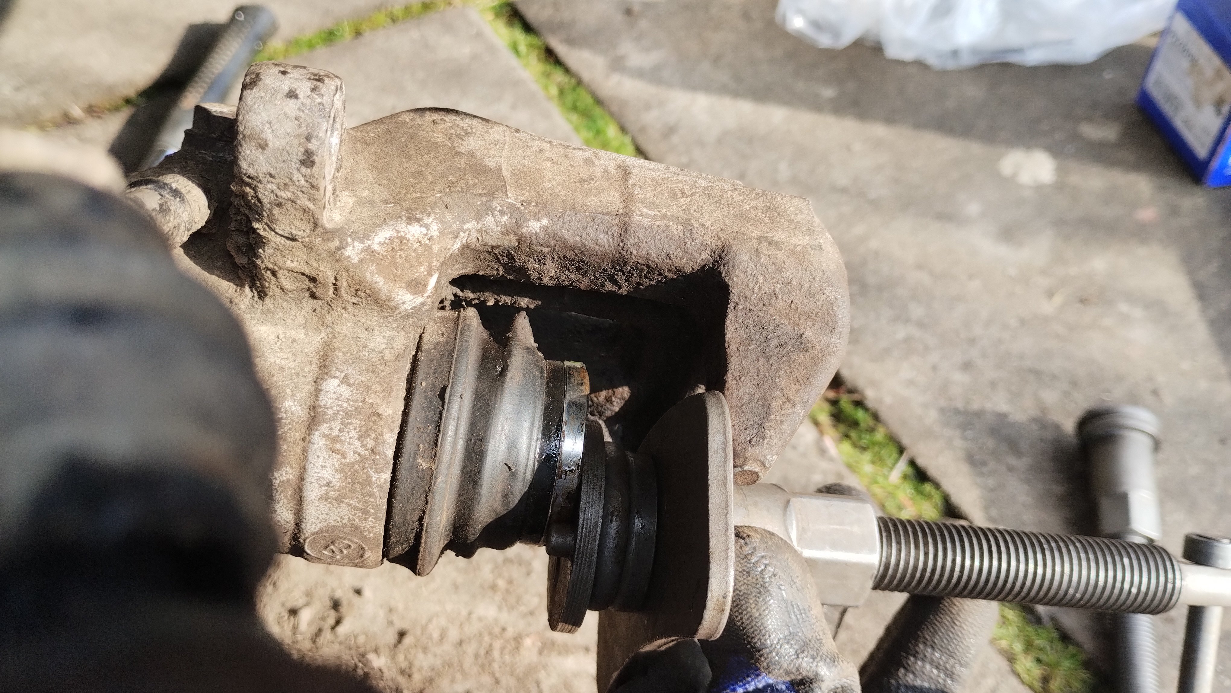

Can't get the plate for the rewind tool in to use it properly due to there not being enough of a gap between the piston and the caliper.
Any ideas?
You can probably get it started in the right direction with a bit of rough improvisation. Use a pair of water pump pliers to wiggle the pot round a bit, give it a tap inwards with a little hammer and a bit of wood, or a squeeze with the windback with the adaptor taken off. Take baby steps, and repeat at length. If that doesn't work, try applying slight pressure with the windback took as you wiggle the pot round.
The alternative is a wind back tool that's meant for these calipers only, so you should get a bit more clearance to get the tool in with not having to use an adaptor.
Edited by StevesTruck
Remove the plate, preload the adjusting screw with a G clamp, wind the piston in a little then use the plate.

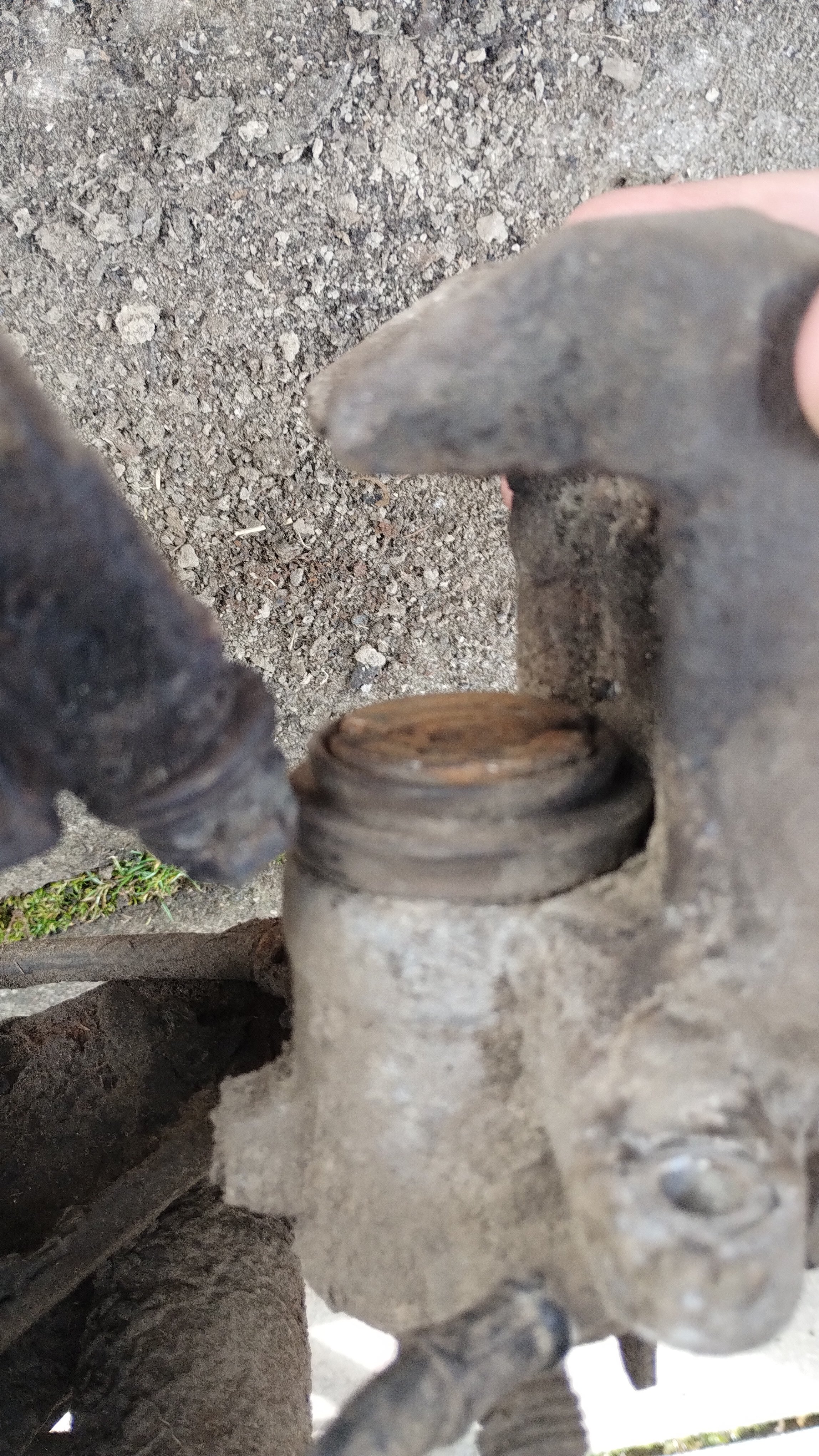

This is what the RHS looks like with everything removed.
Is that piston already wound in enough?
Edited by joeninho
Changed the RHS without issue after winding the piston in a bit.
Still stumped on LHS. The piston just keeps turning but not going in. Must have done hundreds of revolutions.

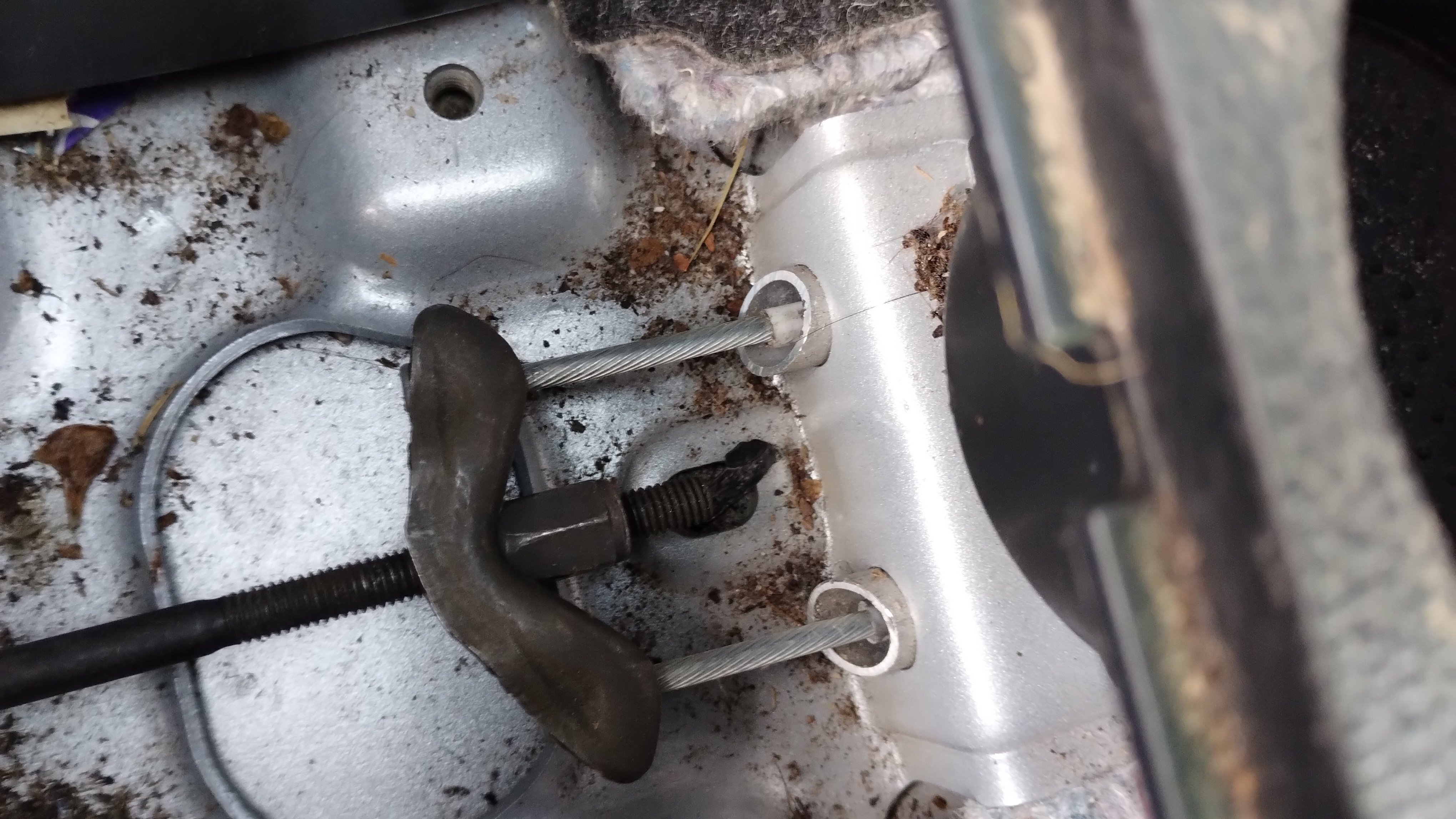

One side of our handbrake doesn't work.
Would that have any effect on this?
Edited by joeninho
Is the handbrake off?
Thanks. AG Falco

Success! Managed to change both sides.
Some serious brute force was required to wind the rear left piston in.
If anyone encounters the same problem, it helps massively to attach the caliper back on with the screws tightened a bit. This keeps the piston fixed on one place, which allows you to really apply some force when rewinding it. Once the piston was on a bit, I then had enough space to use the rewind tool.

If you have a problem with the handbrake self adjuster on one or both calipers attend to that before bleeding the brakes, look at the lever compensator, it should be normal to the cable axis, do not adjust the slack cable before ensuring the self adjusters are working properly. With the handbrake pulled up hard both caliper levers should make the same angle, critically they should both return to the same angle when the handbrake is released.
Return springs were fitted to the levers on some models, these can be fitted to others to help if everything else is free.
