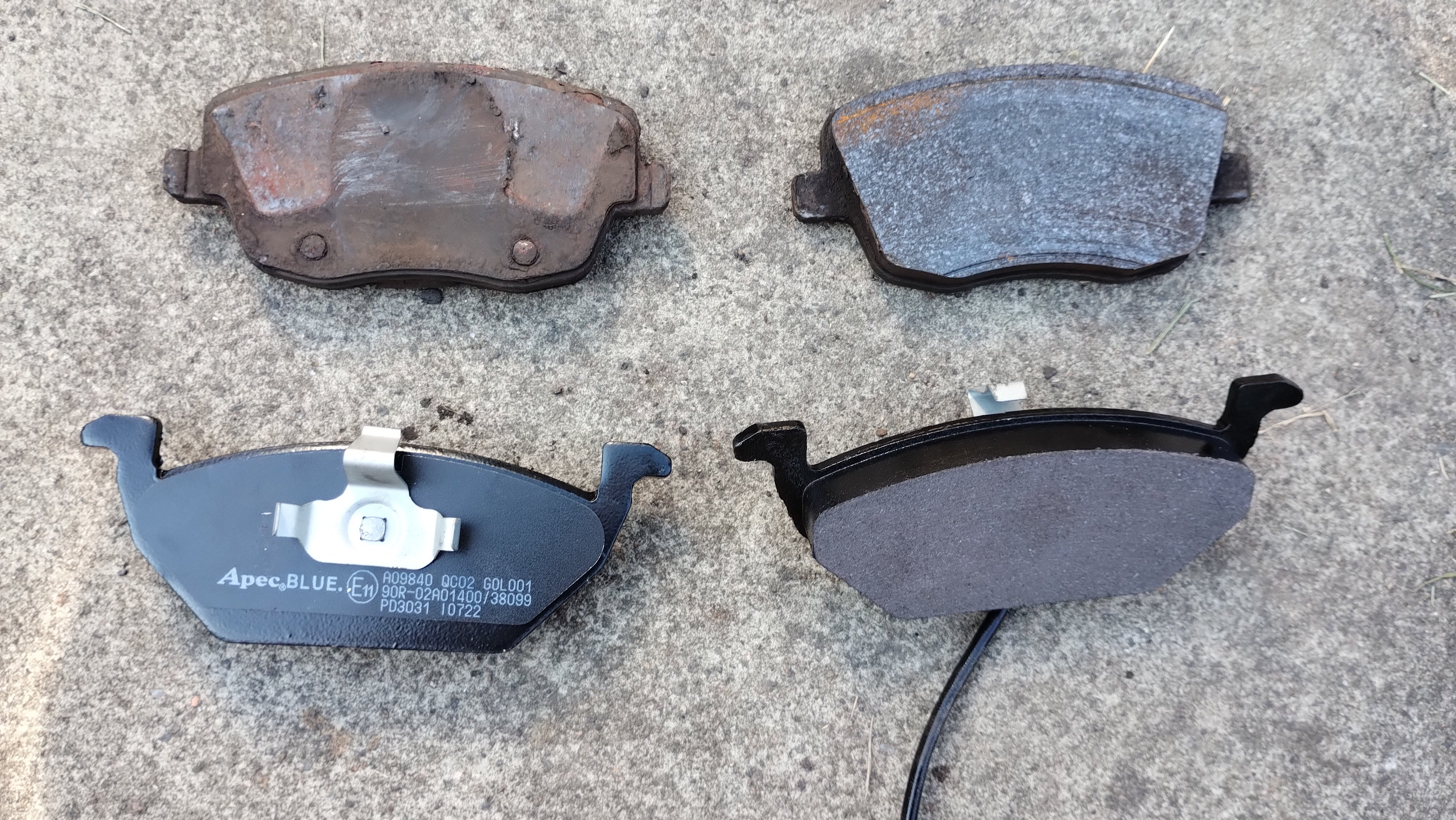

I ordered the correct discs, which appear to fit well - 25x288mm. My issue is that the discs/pads came as a package and the pads do not fit. I am having a real parts nightmare. New pads now required.

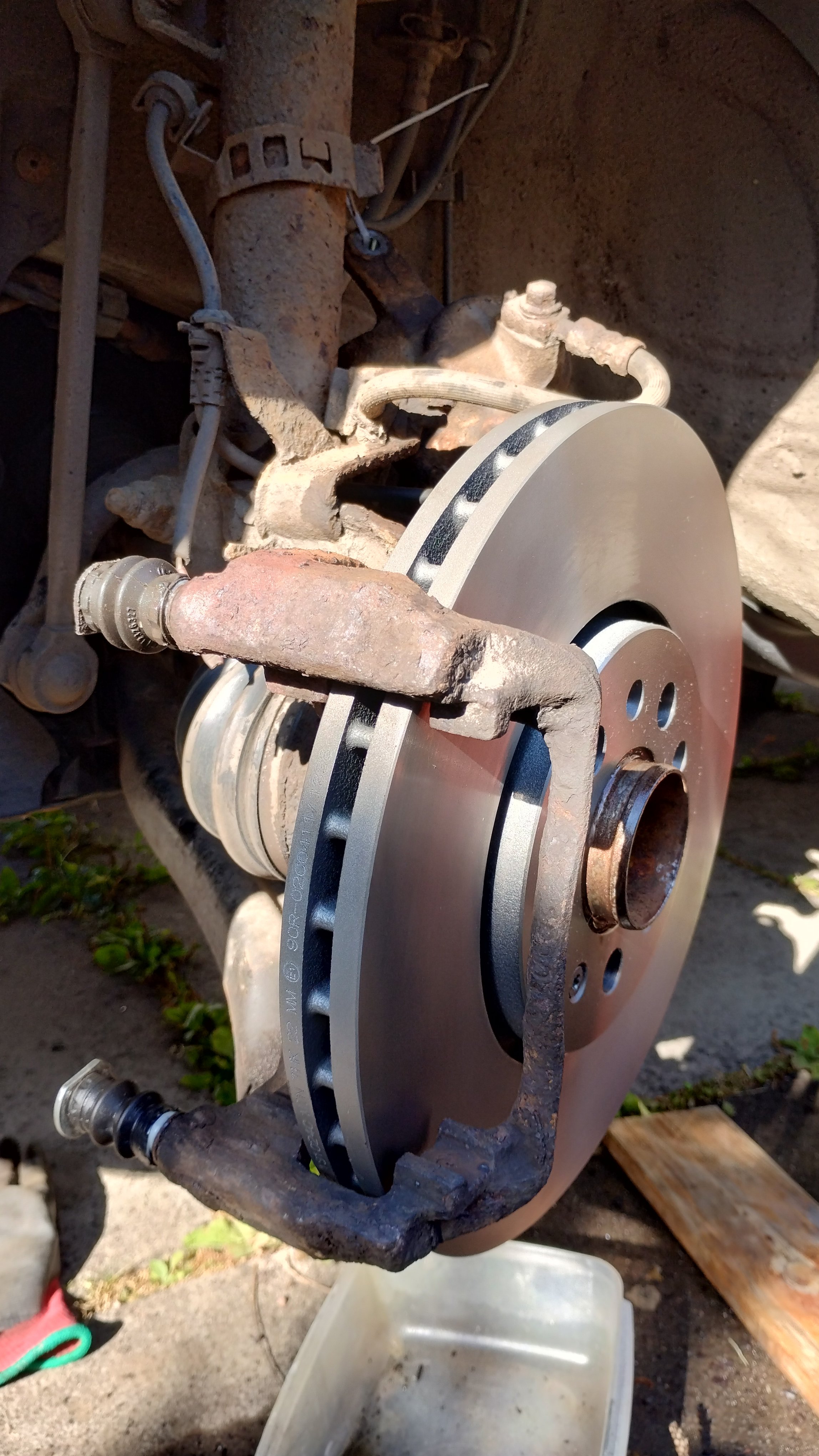

I have posted pics of old and new pads together with a picture of the new disc I have fitted, IMG_20250817_164534249_HDR.jpgand the old caliper that needs to be replaced.

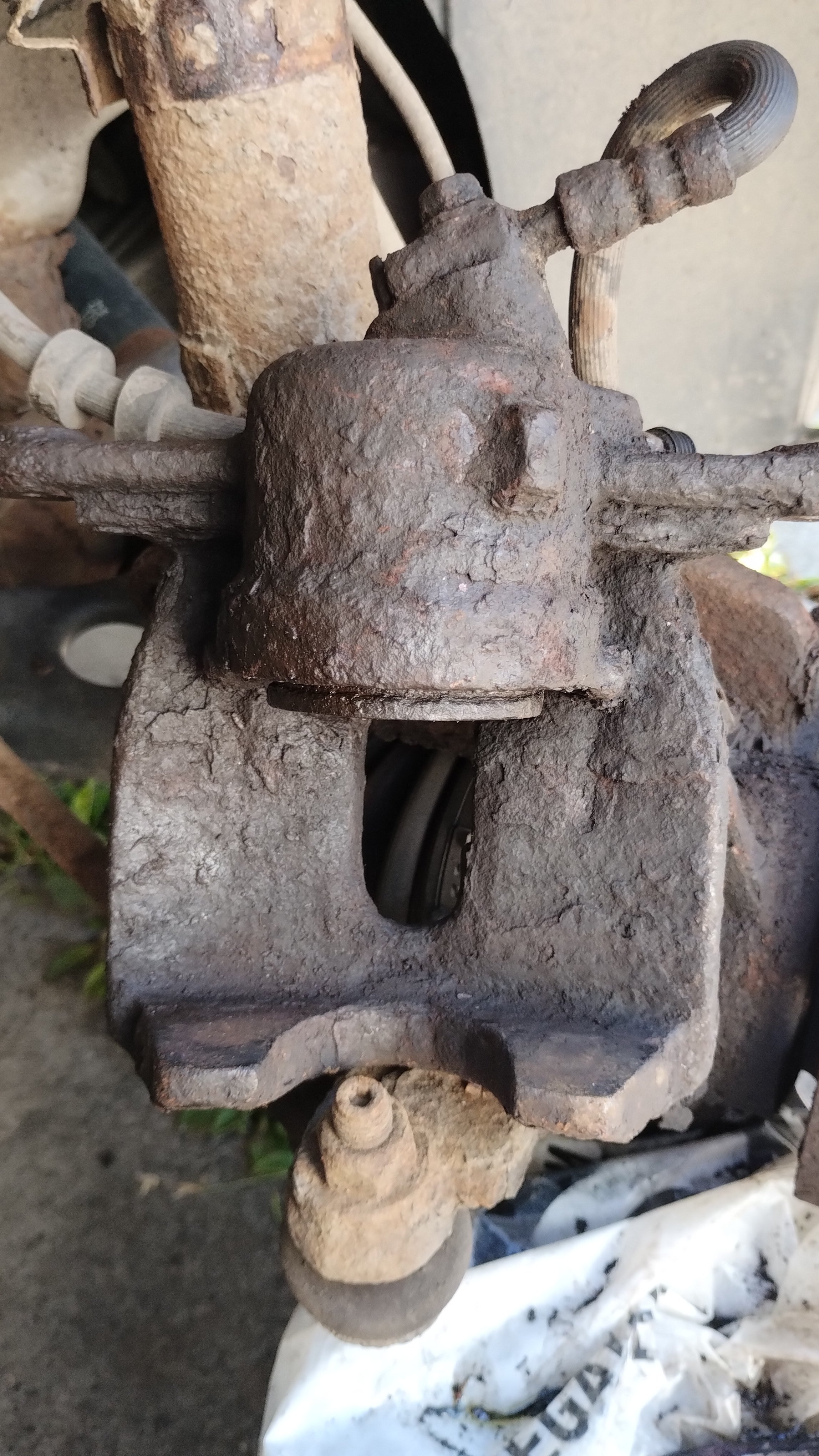

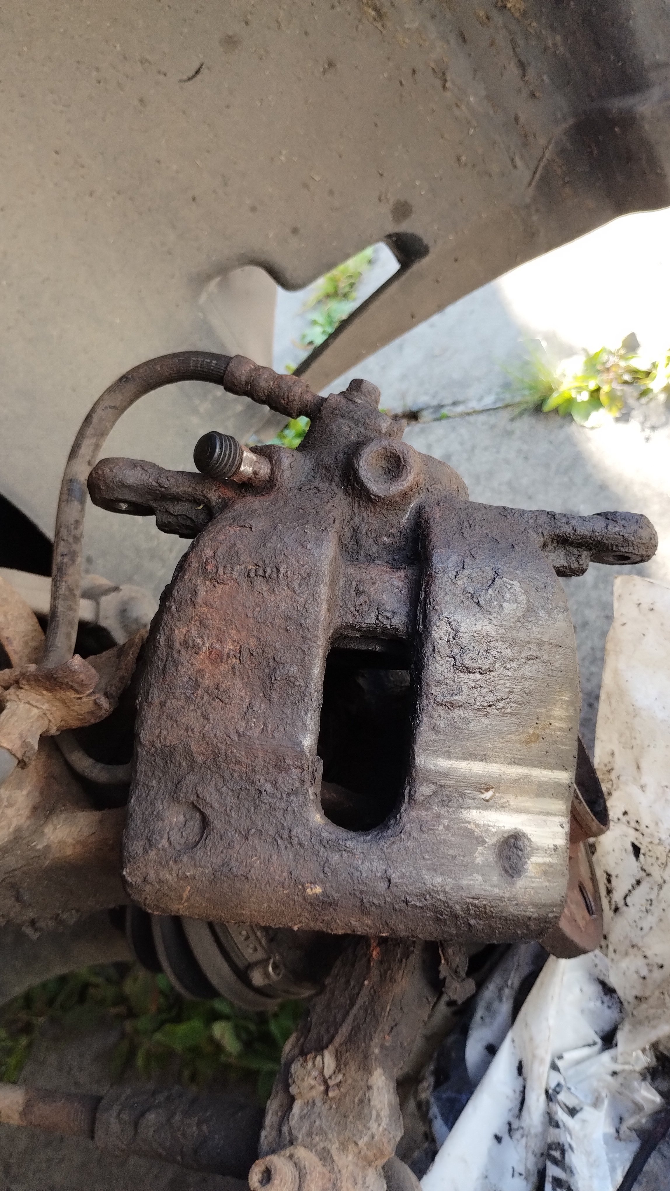

Old caliper to replace.
There might well be a part number stamped into the old caliper somewhere underneath all that crud.
If not, @Breezy_Pete is having fun with his own Roomster at the moment and he may well be able to look up the correct part/s for you if you ask hime nicely ;)
Thanks, Lee.
There is something there, although I can't make it out.

In the interests of clarity, my reg constantly returns 'this item does not fit your vehicle' for the pads I have just taken off and 'this item fits your vehicle' for the new ones I have that don't fit. 🤔

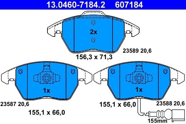

There are two types of front brake calipers on the 288x25mm front brake discs fitted to the Roomster.
The earlier type (TRW front brake calipers) was fitted to model years 2006-2010, and the later type (ATE front brake calipers) was fitted to model years 2011-2015.
The front brake calipers for the earlier type come with either brake pads WITH a brake pad wear warning contact or brake pads WITHOUT a brake pad wear warning contact...as shown in the diagrams below.
Front brake pads TRW GDB1472 (with wear warning contact) 6Q0698151C
Front brake pads TRW GDB1414 (without wear warning contact) 6Q0698151A
Front brake pads ATE 13.0460-7184.2 (with wear warning contact) 5K0698151

Front brake PR code for this car is 1LN. That should help disambiguate, I think.

Just to be clear, I now need a TRW replacement caliper for a 25 x 288 disc?

PR code 9U1 also seems relevant, with wear sensor.
