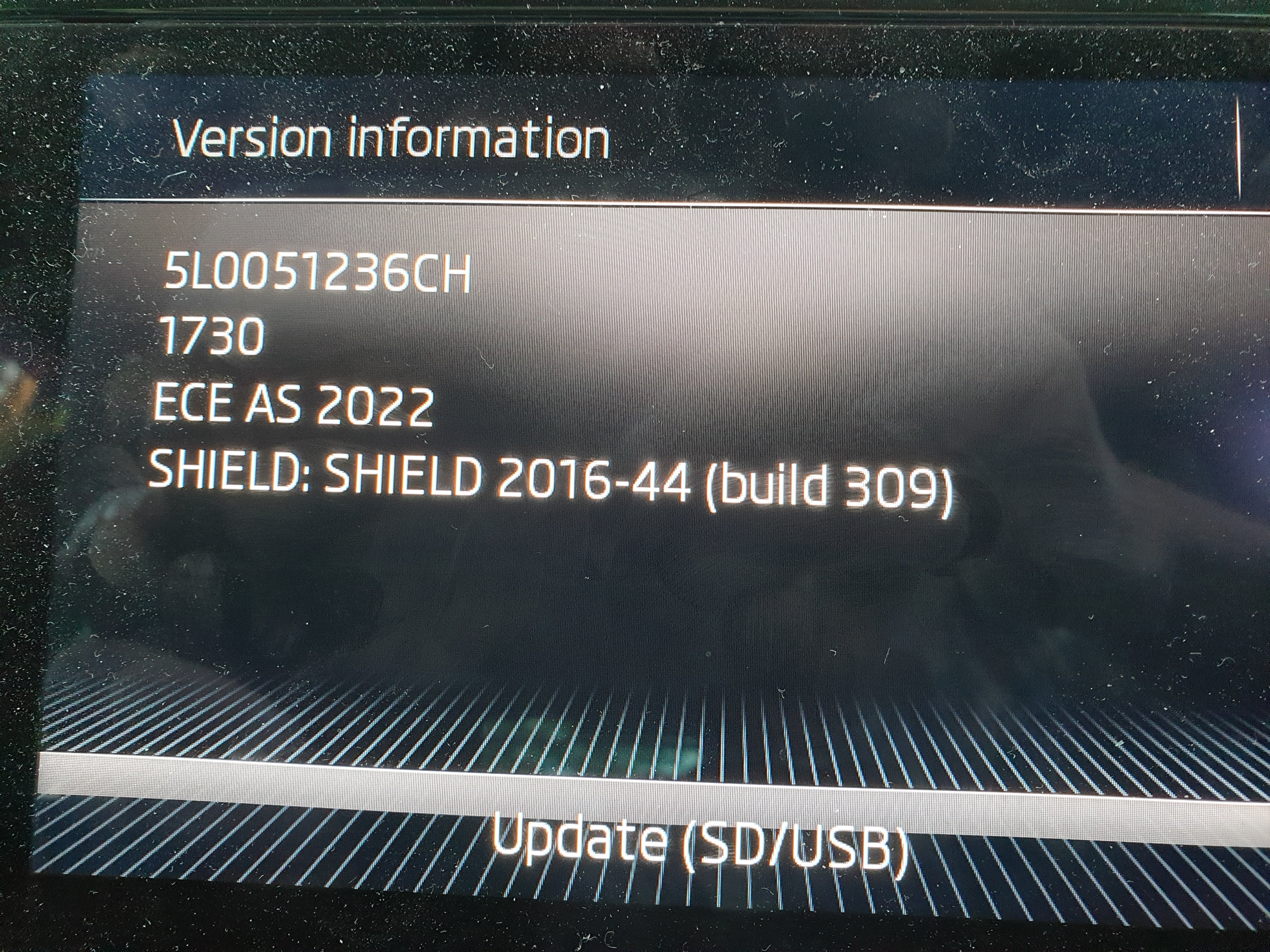

  5. This is what I get when checking version information.
  6. Ditto for me, but if you look at the line above it says ECE AS 2022
