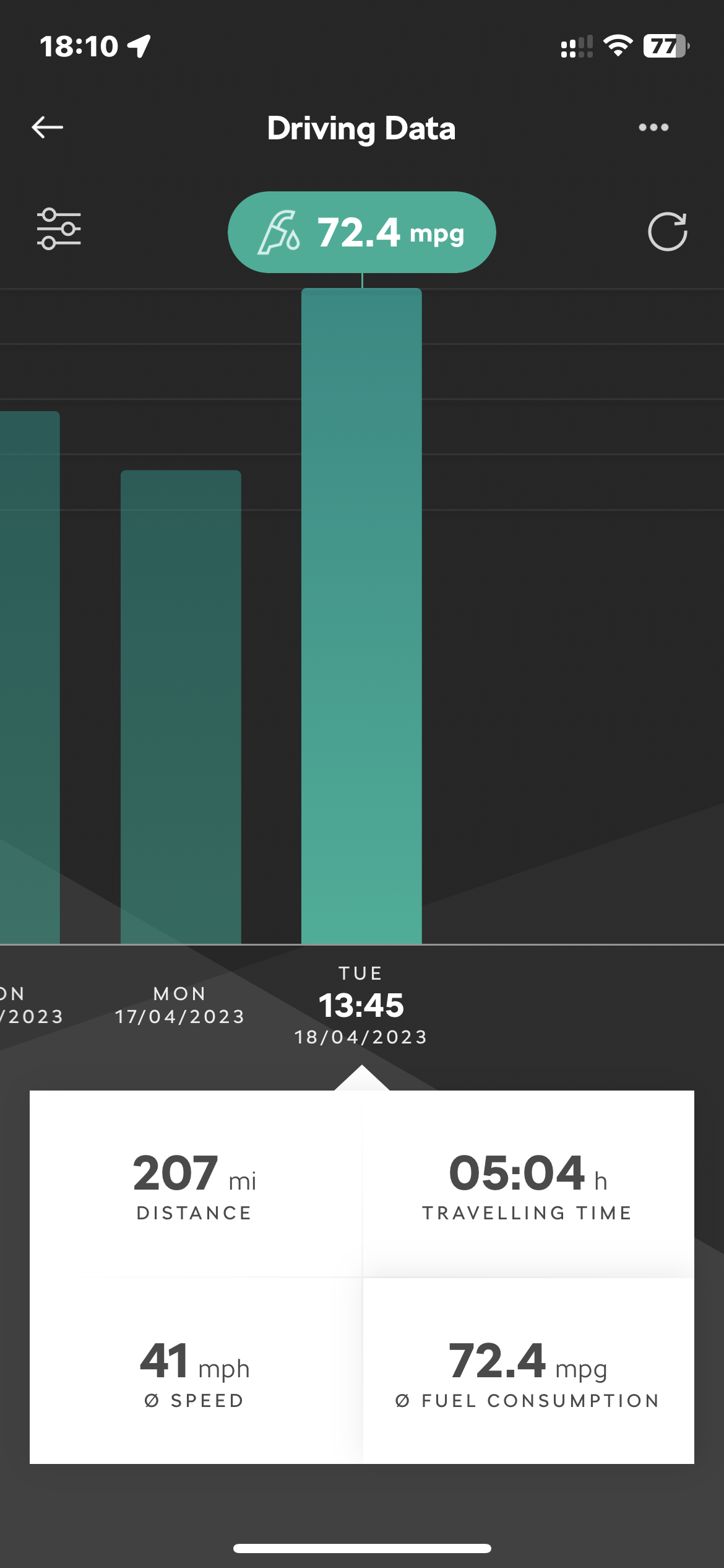

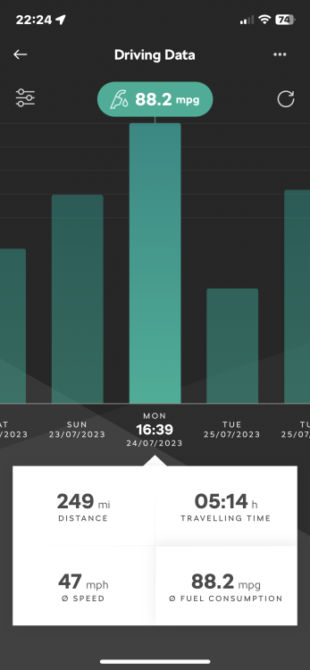

Hi, My vRS 2WD estate, I generally travel long distances, eg yesterday North Yorkshire to Norwich, 70ish on the A1 and somewhat variable on the A17 and A47 204 miles 72mpg ,
