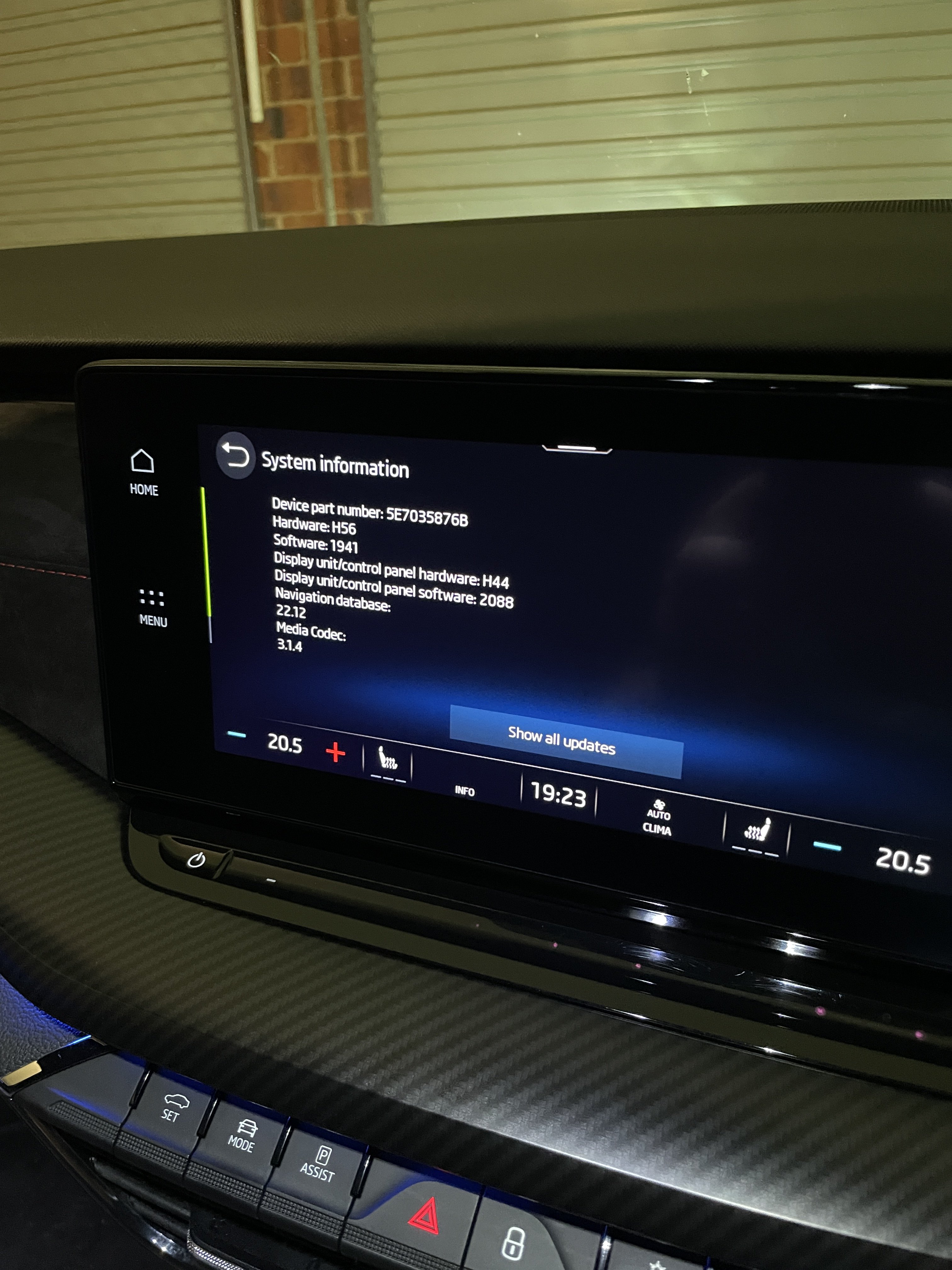

Did an OTA update today with the rather exciting message about feature updates (I think it said) . Anyone know what these feature updates were? It managed to screw up the calendar as updates always seem to.
What is your software version? 1941 is the newest known version and has been around for close to 12 months now.
1969 has been spotted by SEAT owners - but I doubt that will have been pushed out OTA yet.
It's unlikely it will have even the same software revision number.
Even if it appears shortly I'd be nervous about installing it, in light of the previous software debacle.

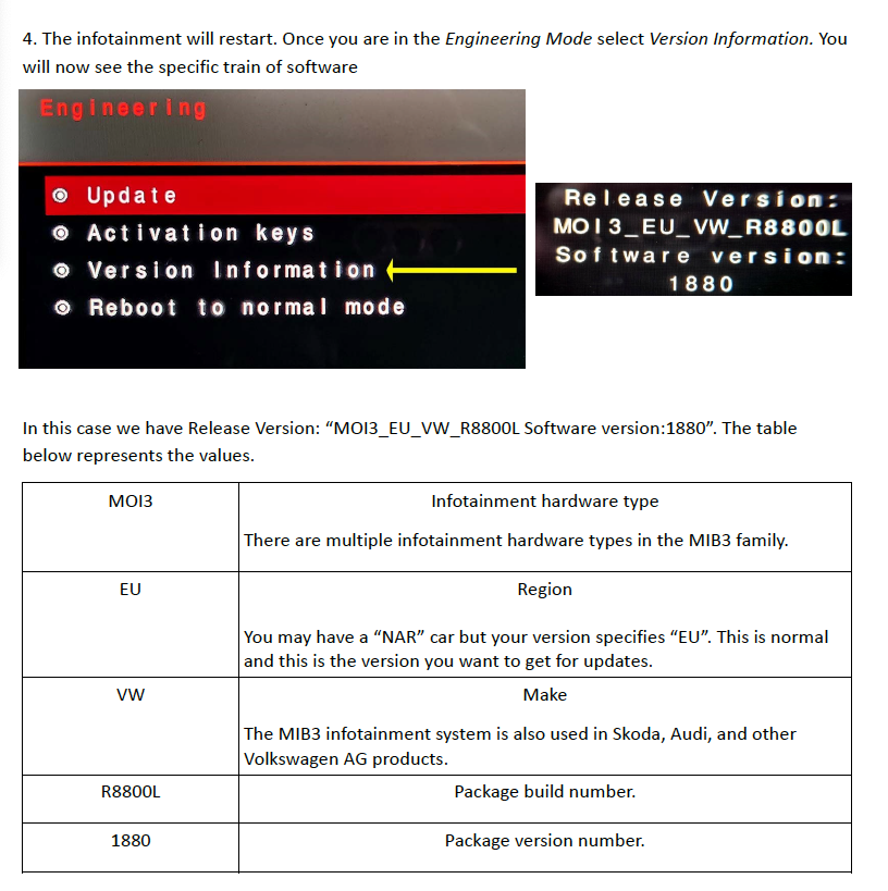

Incorrect. You can't use the update package from a Volkswagen in a Skoda (maps and radio database updates excluded). But the actual software versions are shared.
Just like the Golf 8, Formentor, and Leon our Octavia's use the LG MOI3 system which I believe is also known as MIB3 High.
Anyway, I have attached a screenshot explaining how to decode software trains.
Initial feedback seems to suggest 1969 is the most stable and responsive version yet, so I'll be keen to see it released.
