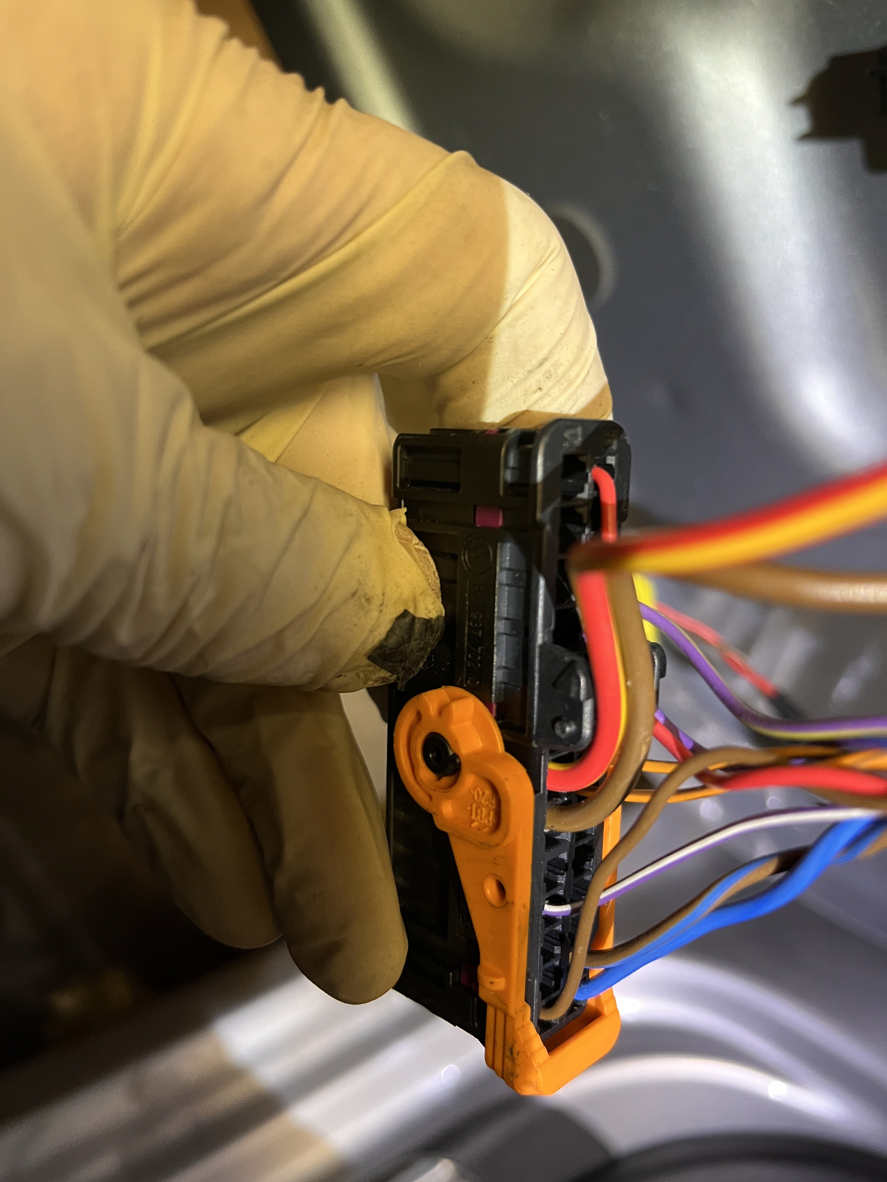

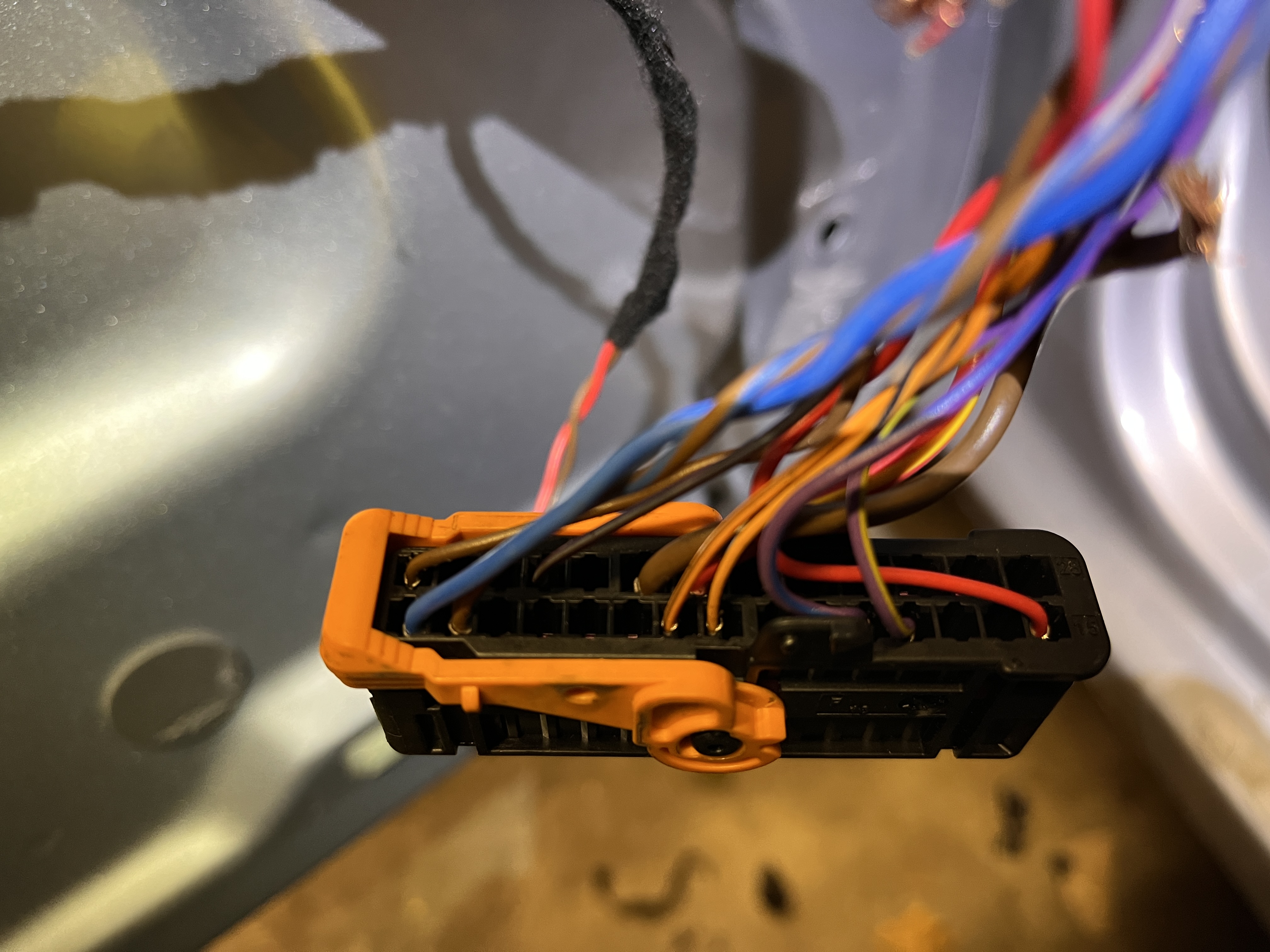

Thanks for the pointers. I had a go at this tonight and unfortunately didn't have much success. BTW, this got worse to the point where all 4 electric windows and the central locking (bar the boot) doesn't work. There were broken wires on both sides from what I can see. On the driver's side, there was a broken thin purple wire. On the passenger side, there were two broken wires - the two thick wires - brown and red/orange. Since the wires on the passenger side look more substantial (I'm guessing power?), I did that first. I bought this kit of Amazon - https://www.amazon.co.uk/dp/B0C4JSY6BZ?psc=1&ref=ppx_yo2ov_dt_b_product_details. I really only need the replacement wires and the pins. I decied just to replace the damaged wires - I de-pinned the broken wires form the connector and added new wires that connect to the loom inside the door. I soldered them and checked that they were secure. To get this far I had to obviously remove the door card, the door stay and then push the loom back into the door so I had room to work on it. Removing the old brittle insulation tape was the worse and longest part. When I reconnected the loom, the windows and central locking still don't work. The passenger door speaker is working and the airbag light triggers when I pull the harness with the ignition on, so somethings working. I can reset the airbag light so not a biggie. Does anyone have a pin out wiring diagram for the Suberb II? Any pointers as to what else I can try? Is it possible I have to fix the purple wire on the drivers side to get everything working? I would have thought the passenger side window would at least work with the wiring in tact on that side. BTW, I did check the fuse for the windows and central locking and it's fine.

Hi, Experiencing an odd problem with my wife's 2013 1.6D Elegance. Electrics on both passanger side doors have stopped working. This includes mirror, windows and central locking. I'll do a scan later, but anything obvious that could be causing this? Thanks,
