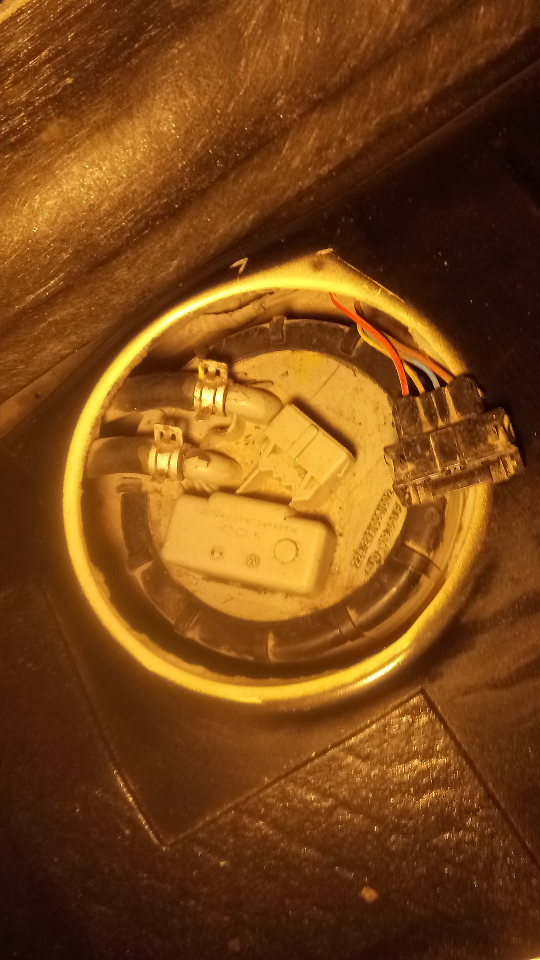

Thanks - I saw an arrow on the top of the pump assembly and a corresponding arrow on the tank, which I've aligned. With the tank out of the car I managed to get the top screwed on. After a lot of struggling I got the tank back in place, but the top of the pump assembly seems uncomfortably close to the floor of the car - not sure if the top is crewed down cpmpletely now 😞 There is a seal where the pump assembly sits in the tank, but I believe I got that situated right. I'll have another look shortly - still got the exhaust to refit.......

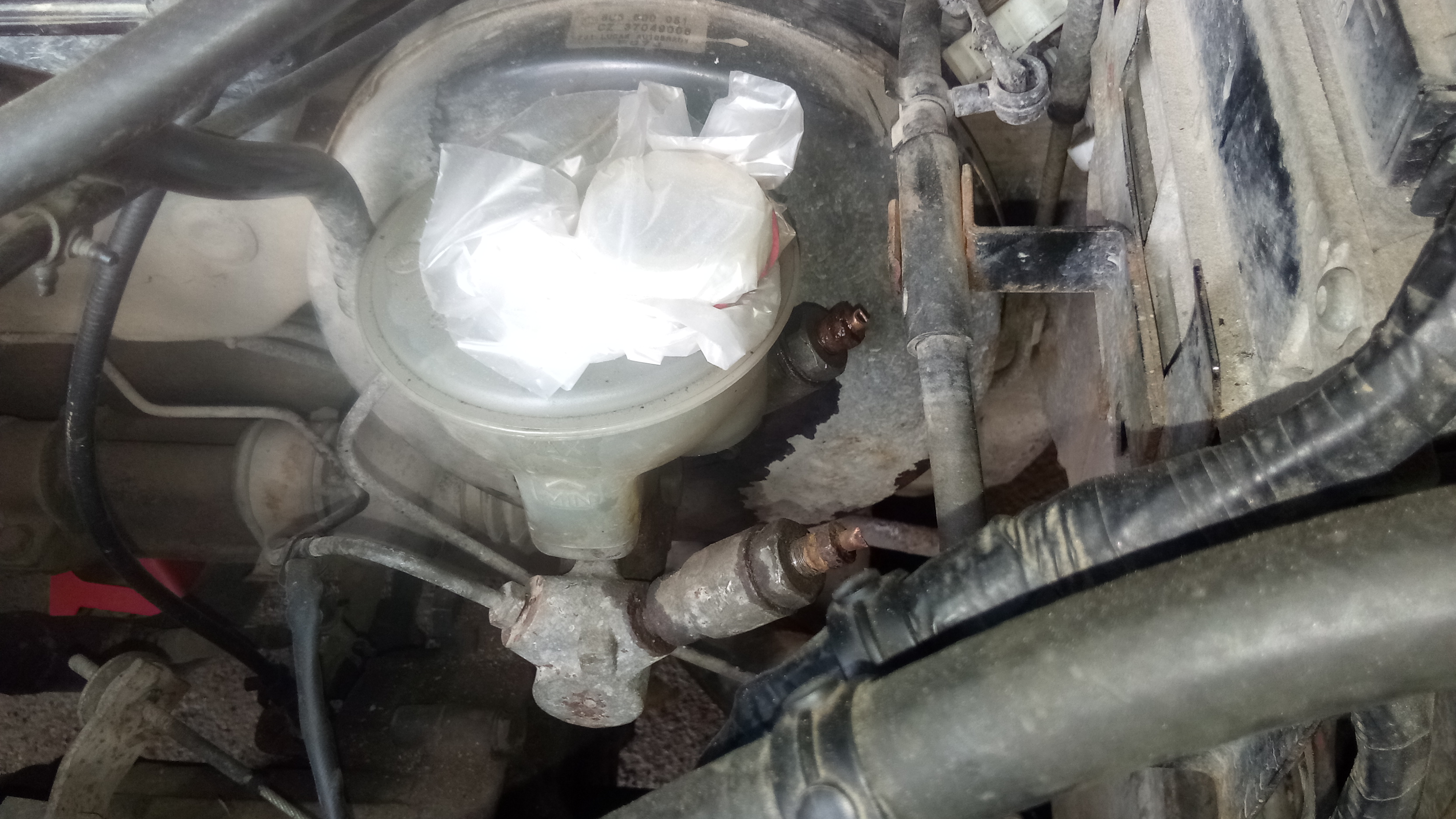

Thanks for the replies - I eventually figured out that it was a cross braking system so as advised I connected the pipes so that the right front/left rear work together etc. Hardest part was threading the new pipes from the master cylinder to under the car. And taking out the fuel tank to get to the cross body pipe, which was well corroded. Also fixed a vouple of corroded fuel lines while I was at it. Next problem is getting the fuel tank back in place - having problems getting the fuel pump large 'jam jar' type screw retainer to connect properly - it keeps popping up when I think I've got it screwed on properly......

This may be a silly question. I'm renewing the brake pipes to the rear brakes on my 1999 Felicia 1.3 non ABS and I foolishly forgot to note which pipe from the master cylinder goes to which rear wheel.... Is it critical and if so, which connection goes to which rear wheel? It looks like one side of the master cyclinder goes to the front calipers and the two outlets on the other side (on the right in the attached photo) go to the rear cylinders... I'm expecting to have some problems feeding the new brake lines down from the master cylinder to under the car, does anyone have any hints on whether it's better to start feeding the new pipes down from the engine compartment, or is it better to work from under the car and feed up the shorter amount to the engine compartment? Any and all advice/hints/tips more than welcome... (I've already rebuilt the rear brakes with new shoes, cyclinders, springs etc. together with new pipes and hoses and removed the fuel tank and exhaust system to make it easier to get the long brake pipes installed) Thankyou....

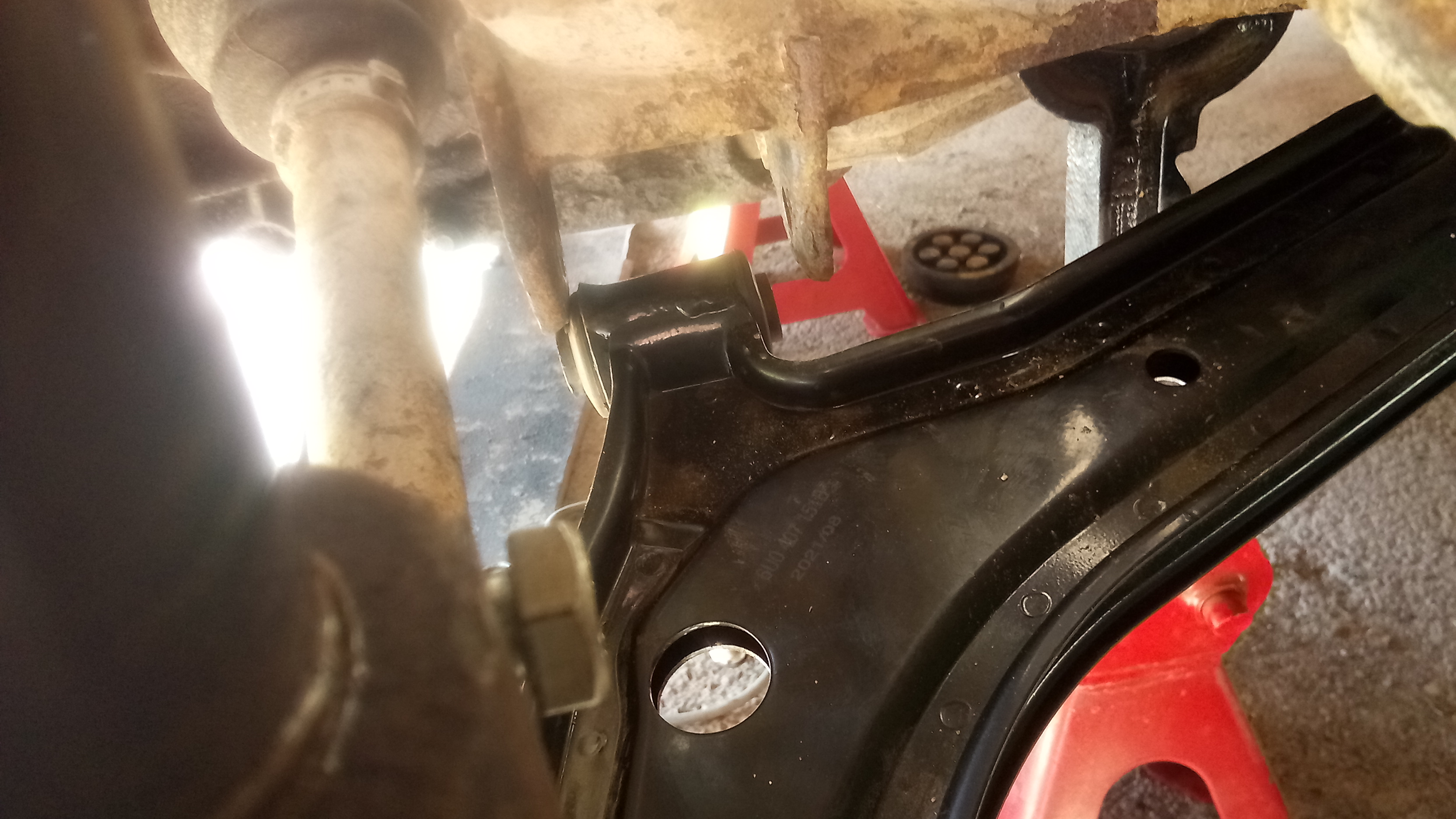

I managed to press the control arm further onto the bush and with a bit of wiggling managed to get it into p+lace. Thanks for the suggestion......

A couple of photos - the rear bolts loosely in place and the ball joint. As you see, the front bush doesn't line up with the chassis......

Hello everyone.... I'm busy doing work on the front end of my Felicia following the registration check - which advised replacing the lower control arms. I've removed the old ones and am halfway through installing the new ones but wonder if there is a recommended method.... My Haynes manual tells me to first fit the ball joint, then the front pivot bolt (loosely) and finally the retaining bolts for the rear pivot bush. My problem is that when I come to the rear bolts, they are around 1/8" from lining up with the holes and I can't get them in position. I then tried fitting these bolts first (loosely) but then I find that the front pivot bush won't line up with the chassis enough to install the front pivot bolt. It's as if the distance between the front bush and the rear bush is slightly too great. Do I just have to use more strength to try to pry the arm into position or is there a simpler way? Any suggestions very welcome, thanks.....

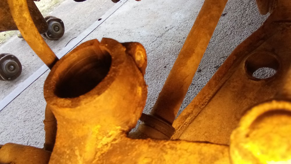

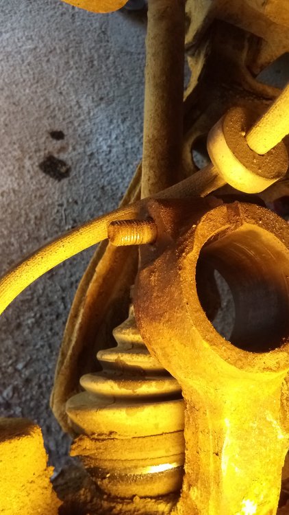

Thanks for the replies. I managed to get both bolts out by removing the complete hub assembly from both sides - lower ball joint, axle nut and steering linkage - then for the complete bolt I used my extra large hammer, and together with a slight backwards/forwards motion and an extension handle on the head of the bolt managed to work it loose. The bolt with the head sheared off I did as suggested and but off the bits of the bolt visible outside (and in the gap) of the hub, then used a drift and the extra large sledge hammer and eventually got both halves of the bolt to drive out. What a pain! Currently replacing the link arms on both sides - that's another pig of a job!
