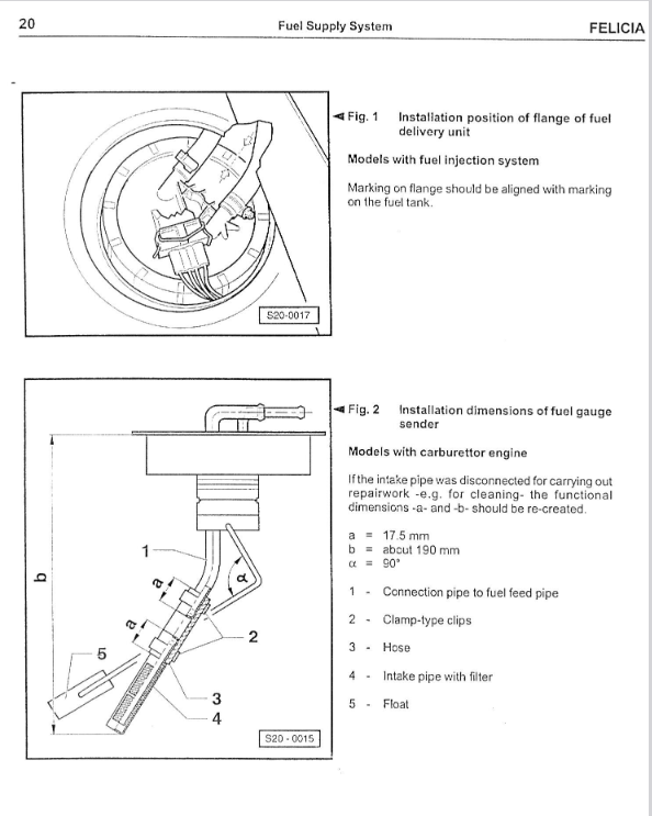

I've bought a set of replacement rear brake lines and hoses, including the long lines from the master cylinder. It appears that I need to drop the fuel tank to be able to get to the brake line that runs across the top of the fuel tank. I've been able to gain access to the top of the tank by removing the rear seat and cover plate (I've depressurised the fuel system first) but now I need to drain the tank, which is almost half full and would appreciate some advice on the best way. I've tried a flexible pipe down the fuel filler, but can't seem to get it into the actual fuel level to syphon it out, despite the pipe going down a long way. One alternative is to pull out the fuel pump from the top of the tank and syphon from there, but there is very little room to get the supply and return pipes off to unscrew the 'jam jar' lid as per the attached photo. But if that's the only way......

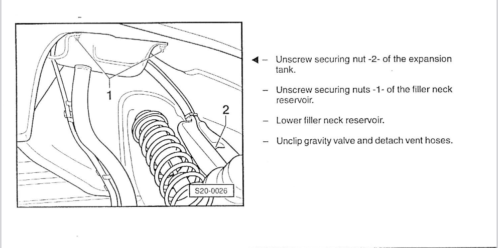

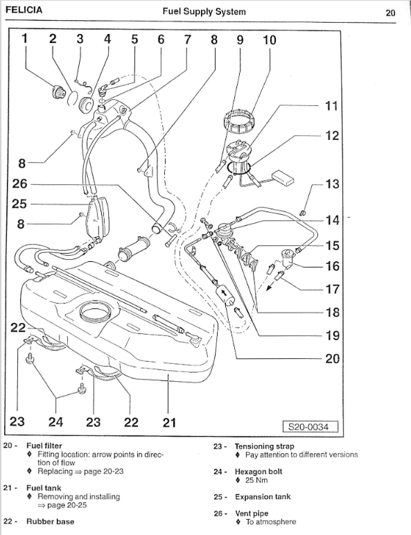

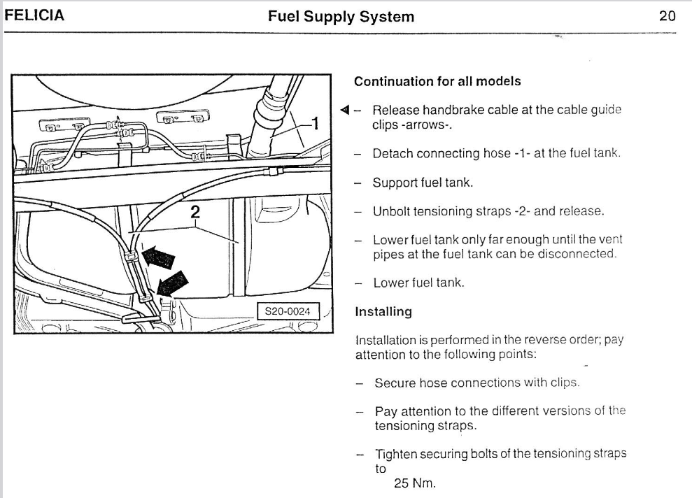

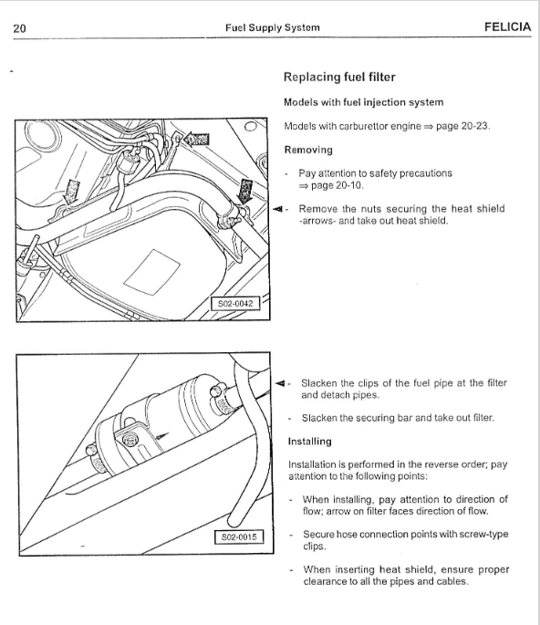

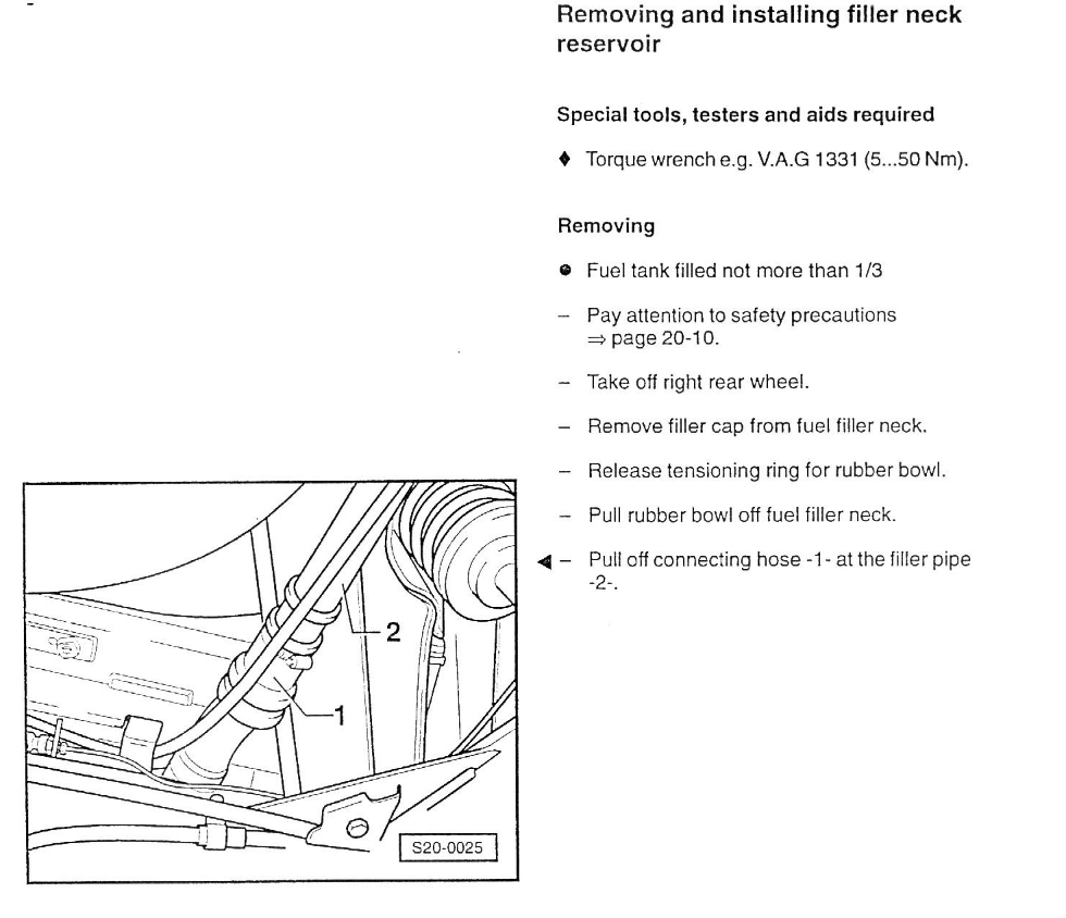

Does these attachments help?
Some more.
Thanks for those images - will certainly help when it's time to put it all back together. Taking a break now for today, carry on tomorrow.....
