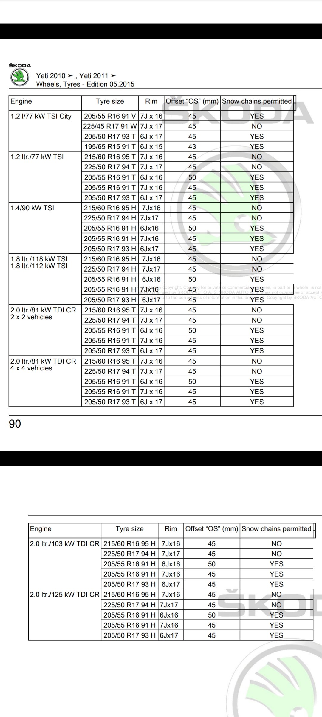

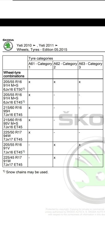

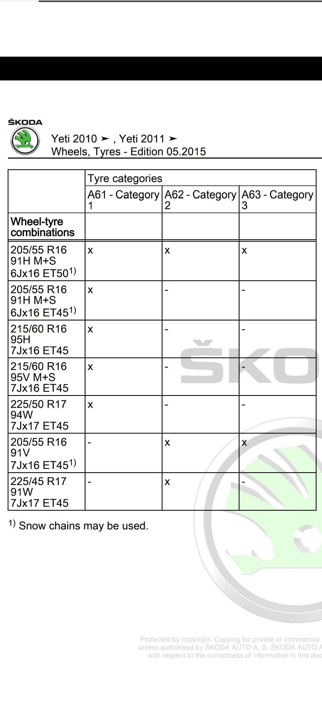

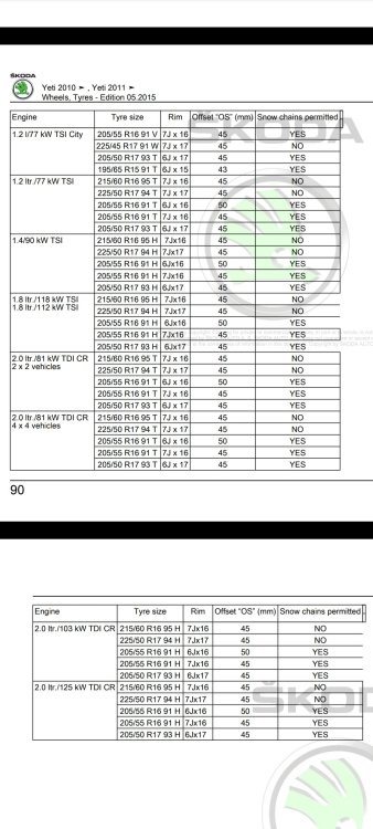

Here is some snaps from workshop manuals.
Screenshot_2022-07-27-10-29-37-152_com.google.android_apps_docs.thumb.jpg.28f5418e13692ca0f6b219a5f41e53cc.jpg
Screenshot_2022-07-27-10-30-34-130_com.google.android_apps_docs.thumb.jpg.045114d4fbd0780ece400841470cf1e2.jpg
Thanks for the info. Looking at prices there is only about £20 difference so may be better just having the Y all round.

Only thing I would check, is the book is 225/50
You have 225/55 fitted?
If so, at least the car goes faster.
Jokes aside, best verify what should be fitted with dealer and try to stick with correct profile if possible.
