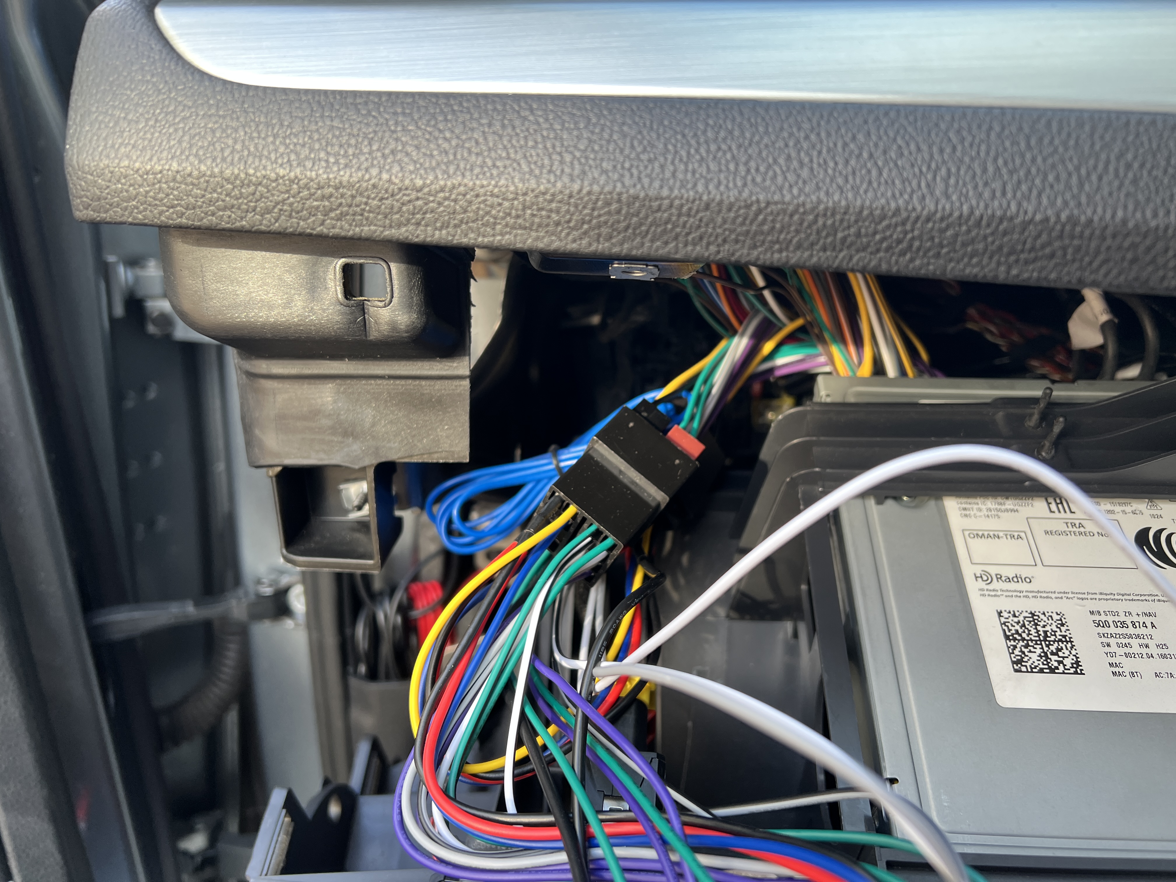

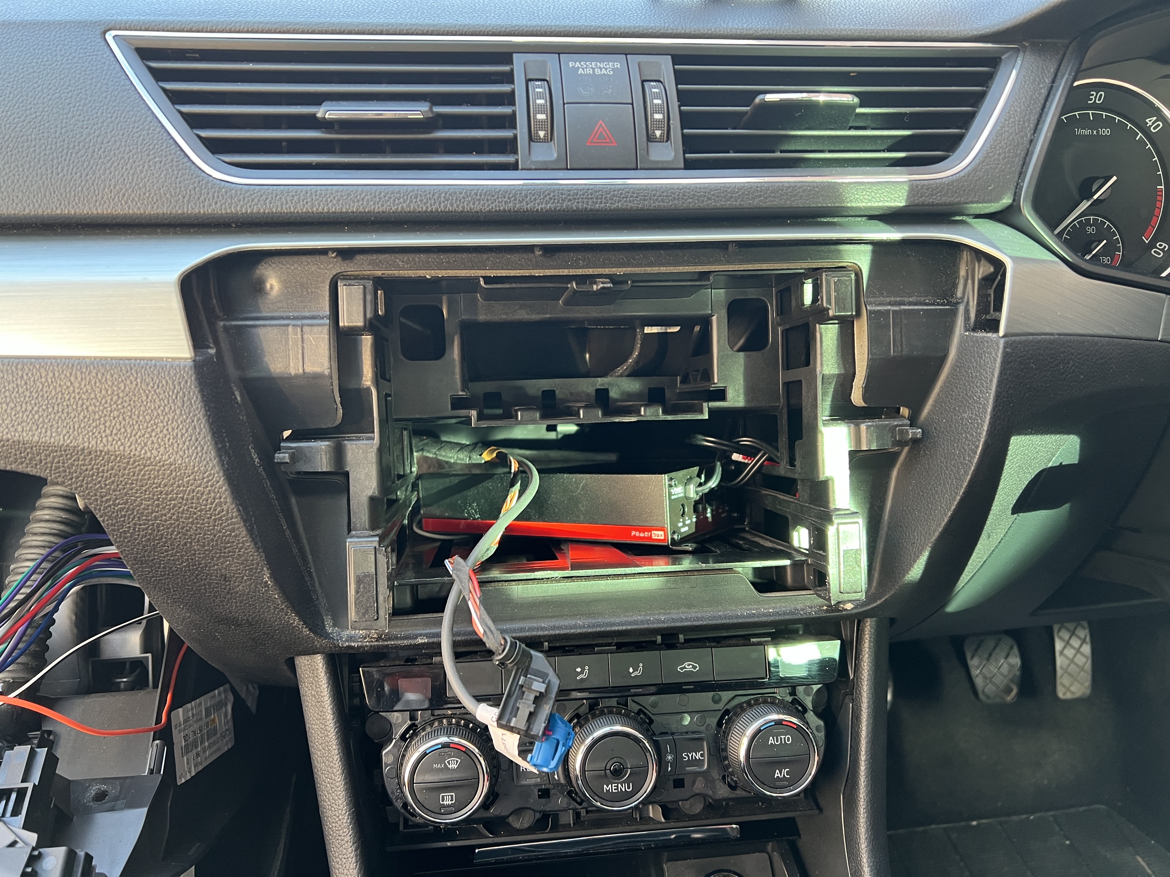

  7. Updating this, just in case anyone else is looking for it. Make sure you get the Vibe 65.4VW02 kit, as it was an erroneous order on my part that meant that the wrong harness was sent. With the correct harness it really was a matter of 5mins to fit the cables, it just took longer to chose a suitable home for the amp. In the end I realised there was a huge area of space behind the ICE screen, so have mounted it there. Pics below. The bonus of this was also it mean that there was a line-out option for the sub, so other than hiding the cables and feeding through the power feed from then fuse board it all works. The amp powers up from the original head unit, which in turn has a lead that tells the sub when to power up. Fingers crossed that will spare me from the inevitable flat battery.
  8. Fitted a Vibe 65.4 plug and play amp to my SE Business, as well as an inPhase USW300 underseat sub. No photos of the sub, will decide whether or not to keep it under the seat, or maybe move it to the boot. The amp was actually dead easy to fit, once I had the correct T-harness and on its own did improve the sound of the stereo. All fitted discretely, and hopefully without creating any new buzzes / rattles in use.

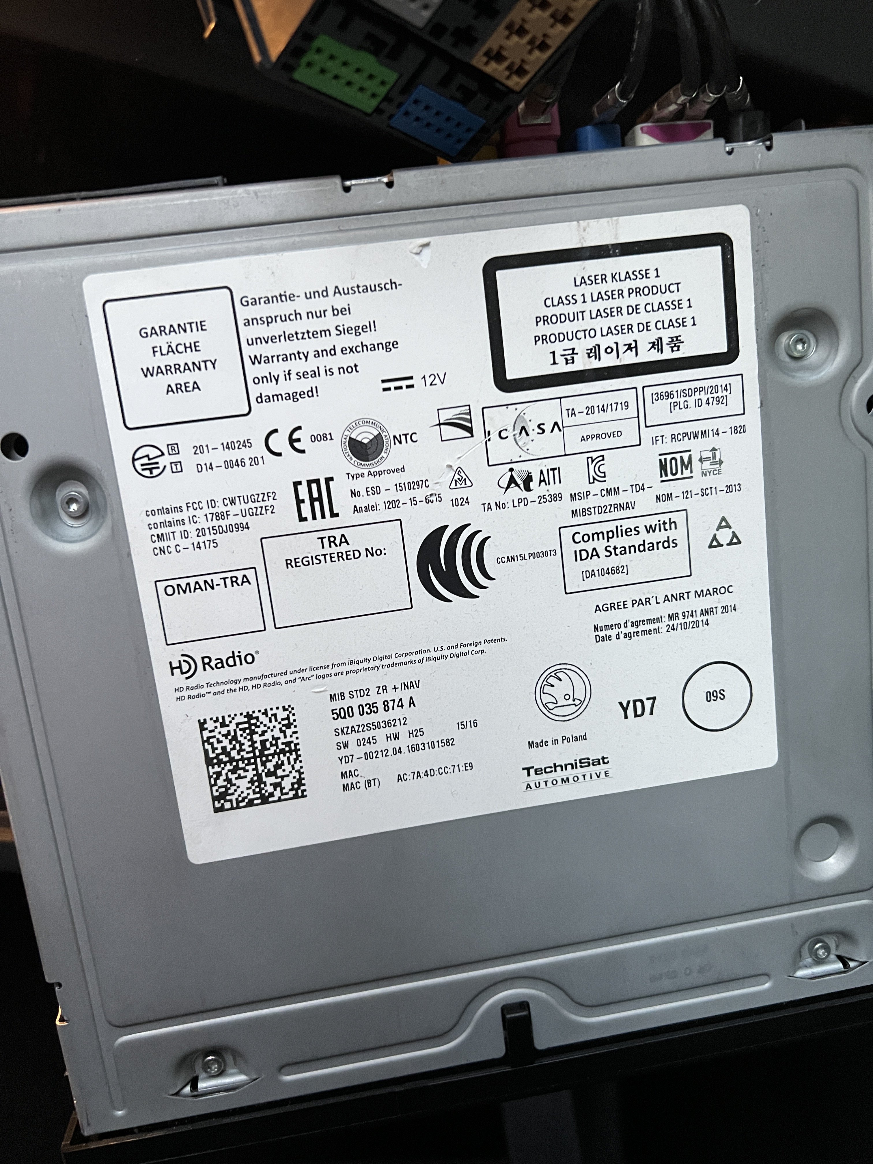

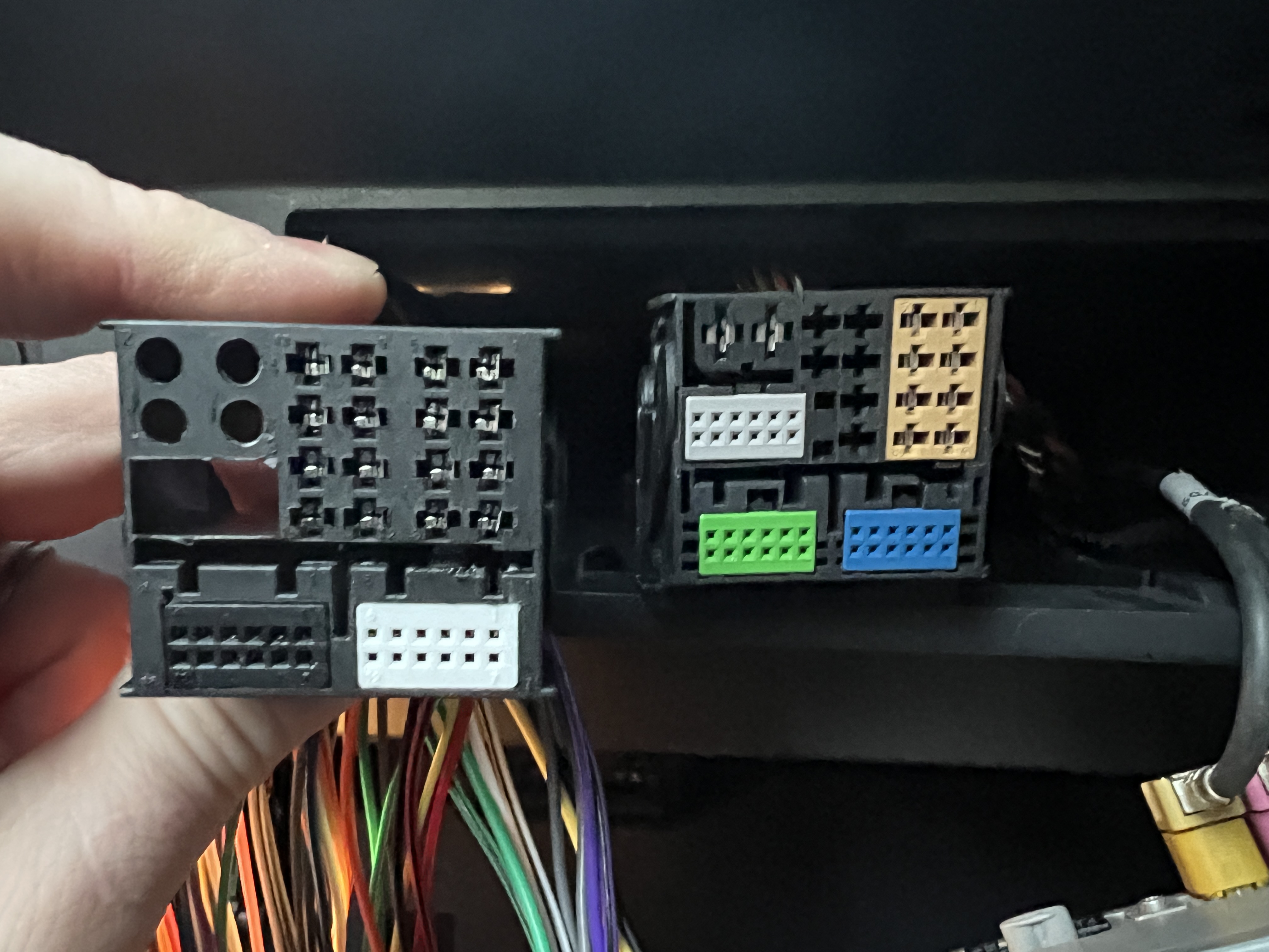

  10. Actually, having looked at something else… this may be a BMW harness (also a quadlock variant), rather than the VW harness
  11. Grrr… turns out the harness between Skoda and VW is slightly different. Or that they updated it along the way. The quick fit harness on the Vibe unit is different to the one in the car. There is a plastic tab between the two top pins and the grey block in the back of the stereo. hmmm…
