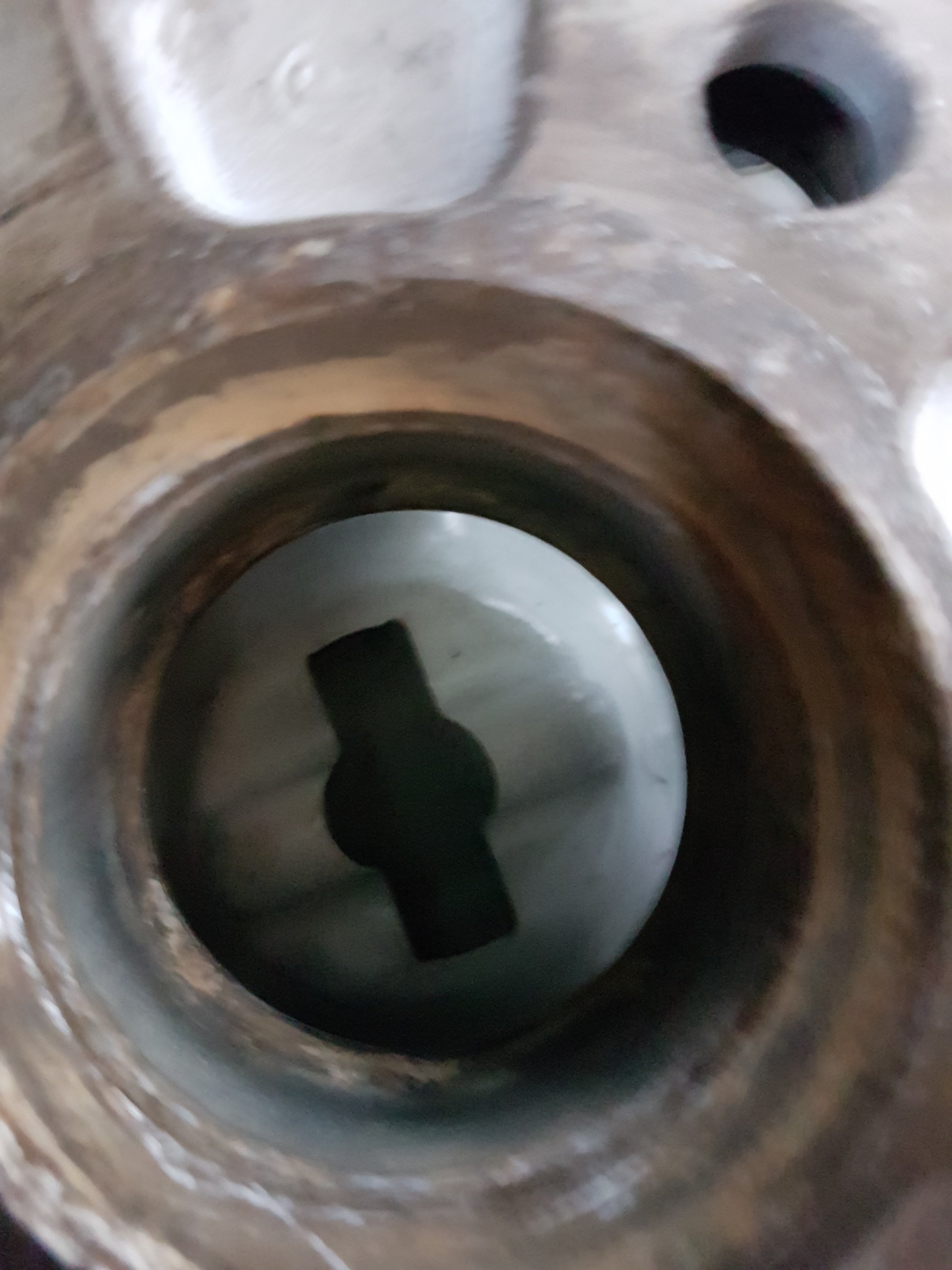

  3. Like JR RS Ivan and others I have replaced the space saver on my Sportline 4x4 with a full sized 235/40/19 spare. Not having a dremel to trim the plastic edge, it does still fit snugly by inserting/lifting the furthest edge of the tyre first when removing/replacing. I had to trim the foam toolholder a fair bit with a long bladed knife so it didn't sit above the tyre edge. I had a flat recently and when placing the tyre back in the boot I knocked and broke the plastic securing thread (the key section at the base sheared off). I ordered a replacement (A$26) but was there was no noticeable movement or noise from the unsecured tyre during this period, likely due to the snug fit. @Newbie69 on mine the key on the mounting screw fits into a raised/domed sheetmetal fitting which sits proud of the boot floor, yours may be the same but I can't tell from your pic. Here is a crappy pic of mine and yes i couldn't be bothered to remove the tyre this time.

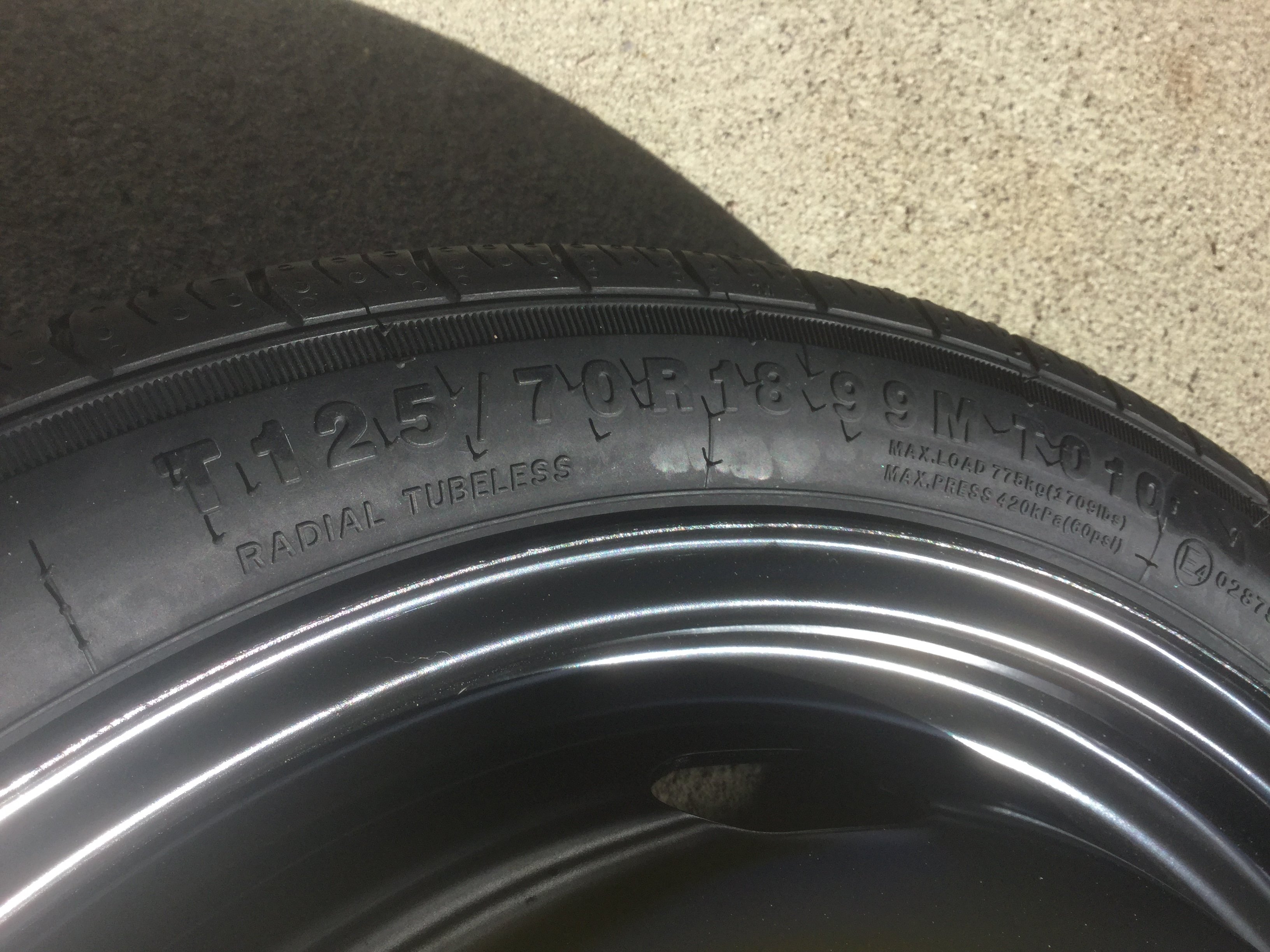

  5. Space saver profile is 70 on 18" against 40 on 19" for the normal full size wheel, I assume that Skoda have this within the acceptable tolerance
