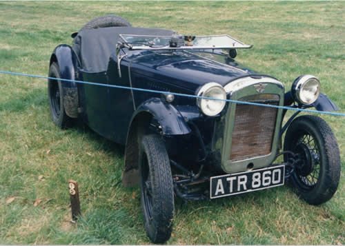

Thanks to all for info and advice. I now know what is involved and could probably do it myself.  But am fully committed to getting my Austin 7 Nippy special rebuild finished for the Austin 7 Centenary celebrations in July 2022 so no work time to do anything else.  Yeti will have to wait till I can take to local garage to do the job.
