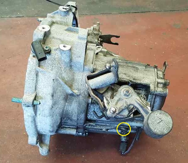

You probably can't be bothered with the gearbox oil given your other problems, but I'll post the info anyway. The gearbox oil filler plug is 17mm hex and is just above the reversing light switch on the front of the gearbox. Oil level should be up to the filler hole. Very early cars also have a drain plug but no drain plug on later cars.
Filler plug location....
