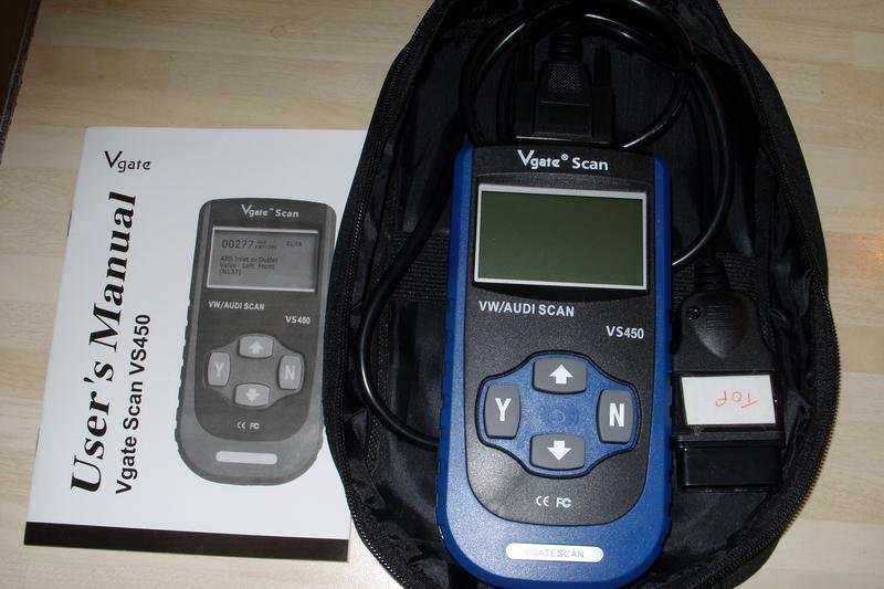

I've been looking at the ancel vd700,
https://www.amazon.co.uk/ANCEL-Functions-Vehicles-Diagnosis-Injector/dp/B07WGFWMYH/ref=sr_1_1_sspa?dchild=1&keywords=ancel+vd700&qid=1613487685&sr=8-1-spons&psc=1&spLa=ZW5jcnlwdGVkUXVhbGlmaWVyPUFQV0YxTklPWFMwRlQmZW5jcnlwdGVkSWQ9QTA3MDUwMTMzSDJZUTU5NUJORDQmZW5jcnlwdGVkQWRJZD1BMDM1Mzk3ODFVSEtJTVVNWjFZQTEmd2lkZ2V0TmFtZT1zcF9hdGYmYWN0aW9uPWNsaWNrUmVkaXJlY3QmZG9Ob3RMb2dDbGljaz10cnVl
Does anyone think this is any good or have any experience with ancel?
What odb tools do you all use? this one has special vag functions. (it also as throttle body adaptation)
I've been using a cheap obd wifi dongle, and various apps on my phone, but there clunky, and dont work very well
Edited by MinkyMike
Looks decent. I use VCDS-Lite which is a free version of the full VCDS. You just install it on a laptop and use a VCDS cable to connect to the car. I also have a cheap scanner which seems to work OK for basic use....

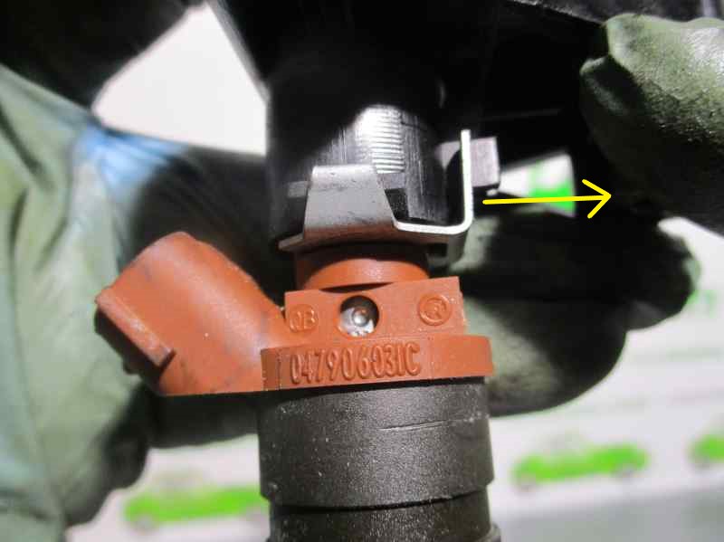

I dunno, I really am stumped, Going to see if the code comes back, ill try again tomorrow, is an injector easy to change? is it just a case of pull it out and push the new one in?
Try swapping injectors round and see if the misfire follows that injector.
First you have to remove the injector rail with all four injectors attached. Then they are just held to the rail with metal clips. Remove the clips and pull the injectors out of the rail.
Edited by TMB
Ah, brilliant idea, if the code has come back, I'll definitely be trying this, also I've got new seals so I might as well use them. Thanks mate
Oh right , nice one cheers bud, it's a pretty easy job then, will fuel all spray out when I remove the injector ? Is it under pressure, and do I need to prime the fuel or anything once it's swapped or will it just start ?
