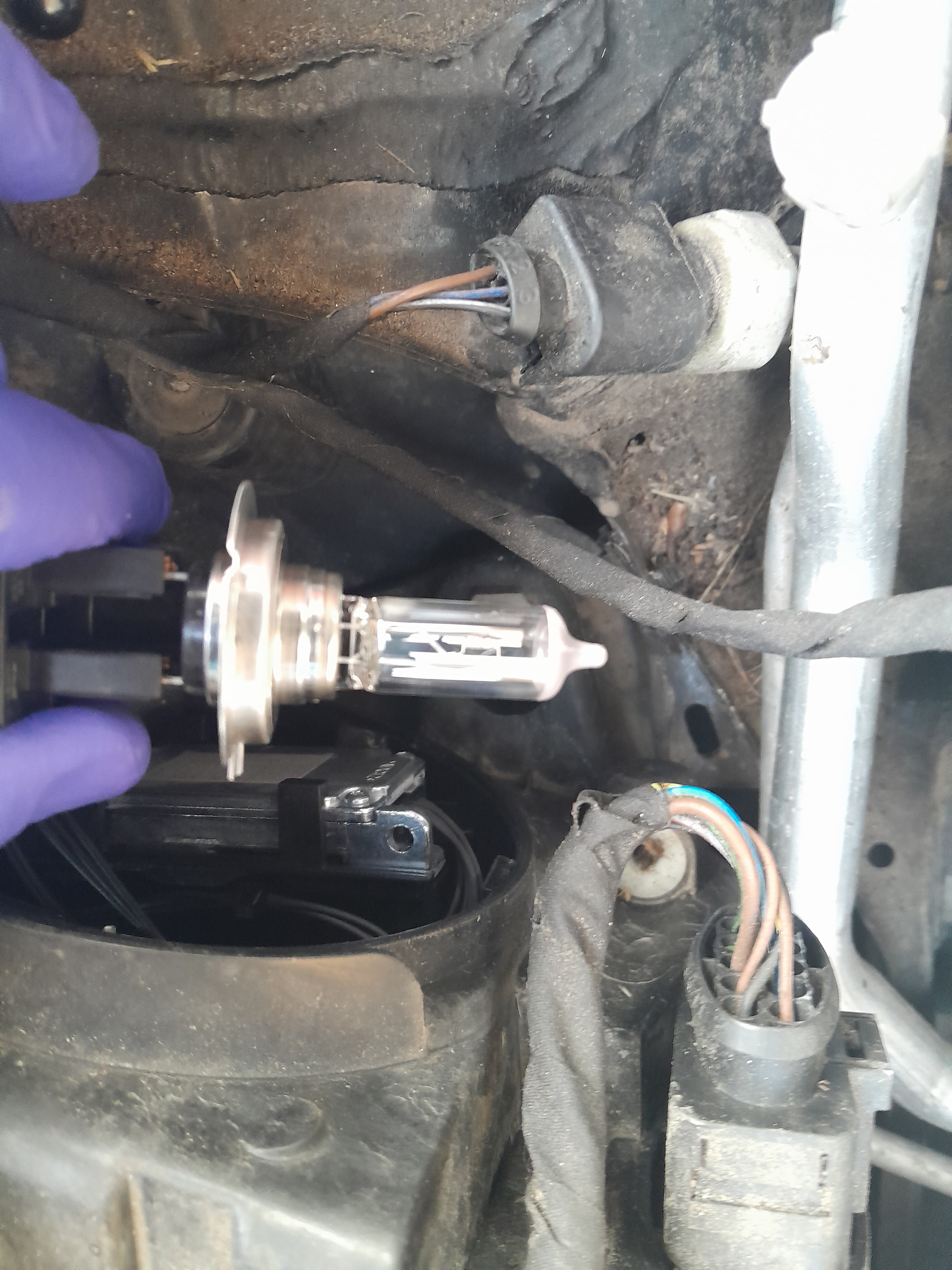

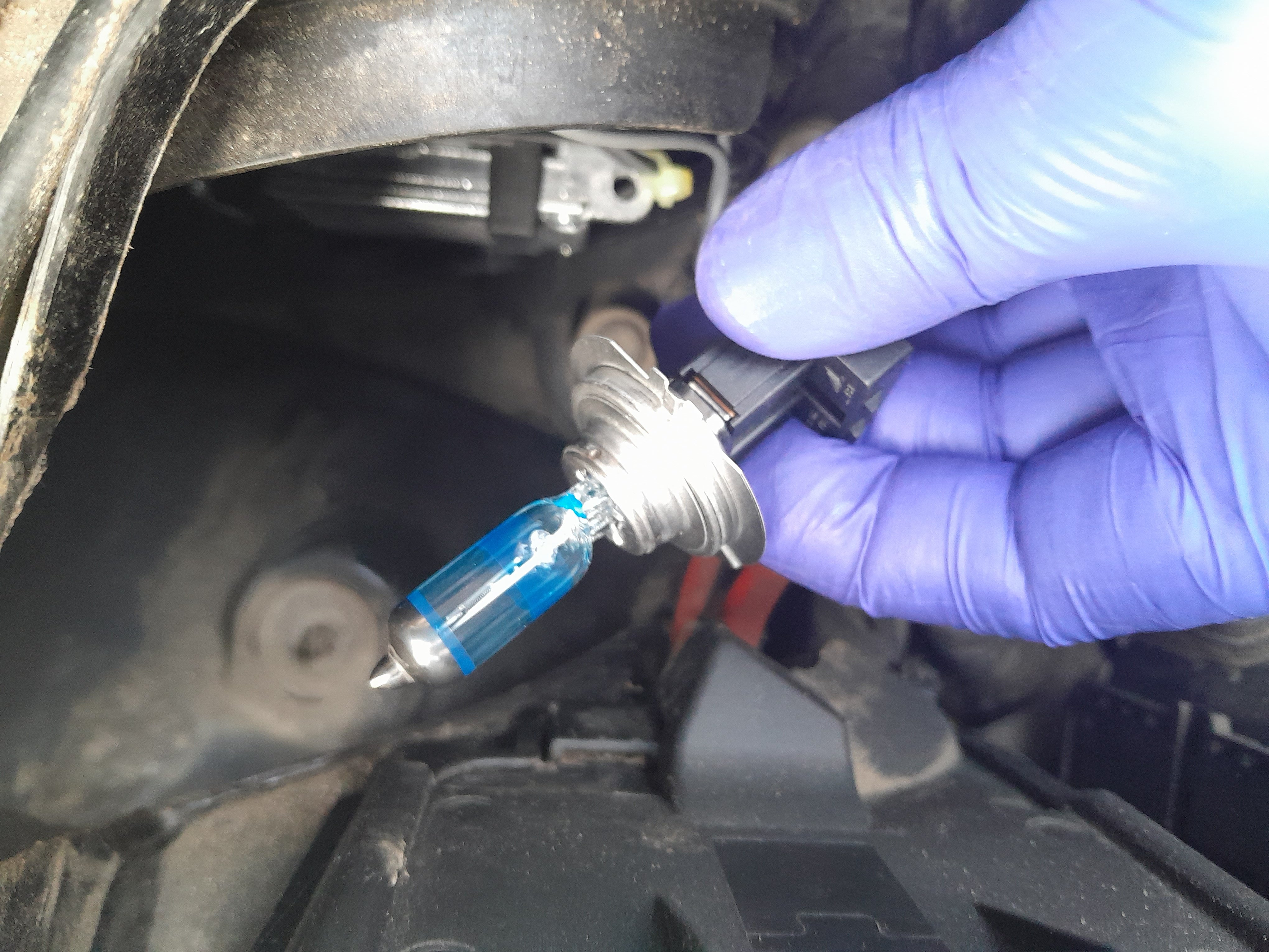

Hi Thanks everyone. I've just had  OSRAM bulbs fitted, purchased from Powerbulbs.
Night breaker Laser +150%  H7
Cool Blue Intense Next Gen H15
Both claim to be 120% brighter.
The wider spread of the H7 is noticeable as is the increased whiteness of both beams.
And yes, I've a manual thumb wheel adjustment -hidden by the steering wheel.

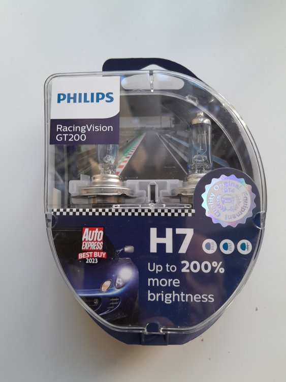

Just upgraded my h7 dipped bulbs with these, not that my original set were that bad, a bit extra won't harm. I've had a lot worse, previously owning mainly vauxhalls.
£20 for the pair of bulbs, can't grumble.
