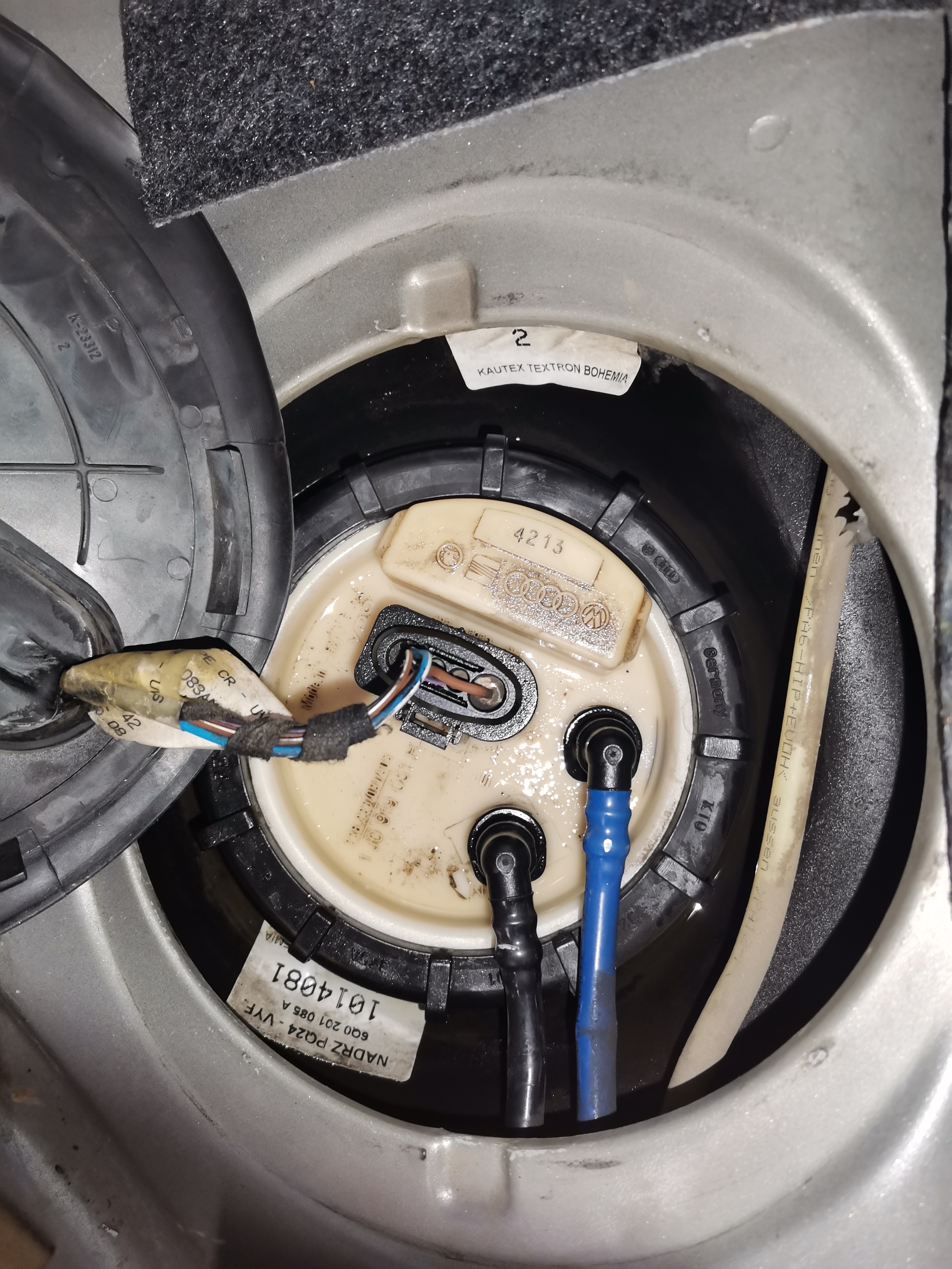

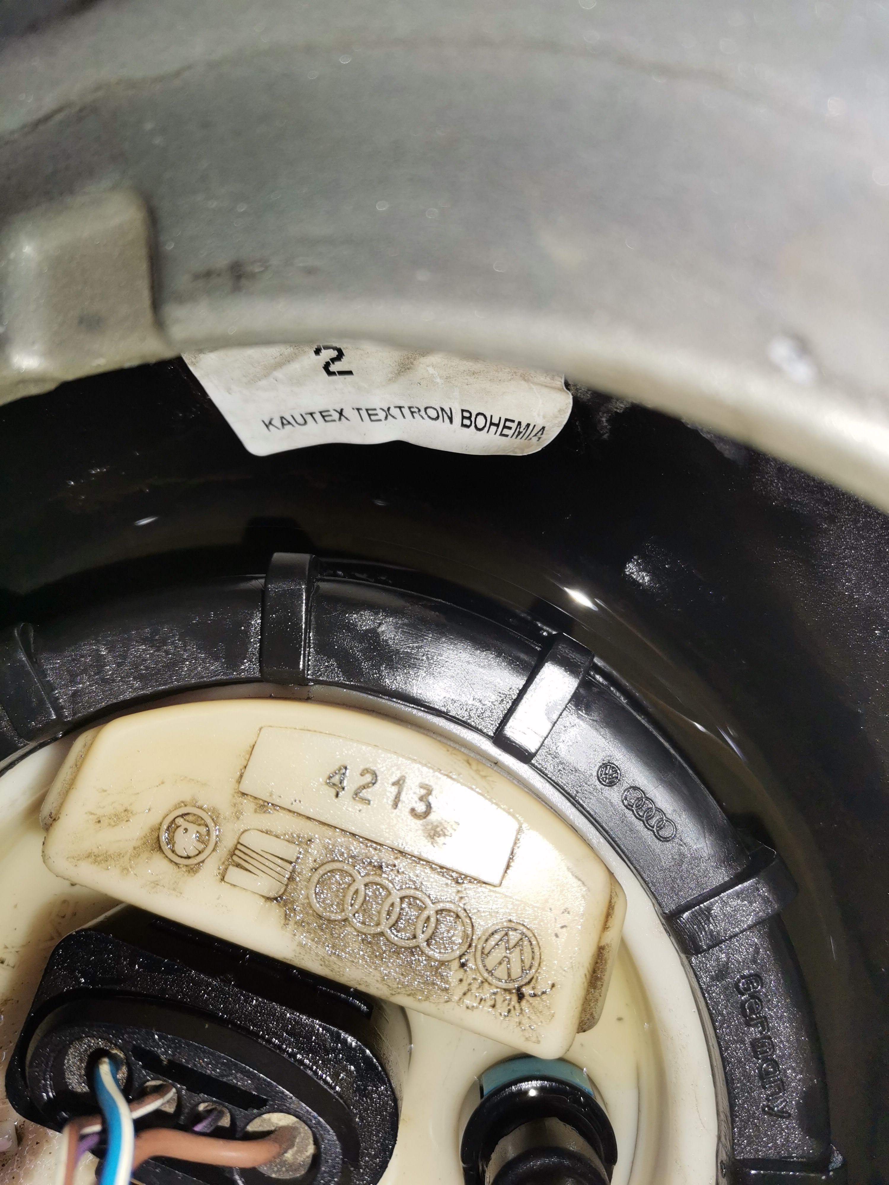

  2. Yes, I've checked it and it's quite tight. You're correct, rubber seal is next, plus a general inspection on the pump. Otherwise I'll have to drop the tank and filler neck I guess.

  4. Good day everyone, As per the title, today I noticed my BBZ 2007 Fabia sort of puffs blue smoke during road trips, when hot and after a few hours of continuous use, only after coasting. It only happens after long sections of downhill coasting with zero throttle input, but as soon as the throttle is applied after the fact, *puff*, blue smoke. The appearance of smoke is sporadic, the car doesn't smoke at idle, nor under load most of the time, only after engine braking has been used for long periods. Oil was changed two weeks ago, and even if oil consumption has been noticeable since I got the car (5 years ago) the smoke issue is new. Oil is Shell Helix Ultra if that matters, compliant with VW 502.00 specification. I change oils every 7500 km. The car has 141.000ish km now. I wonder if it's just a case of replacing valve stem seals (about time anyway) or it could be something more serious. About the fuel leak issue, it just popped up in the past two days. After a trip with my family to the countryside, we noticed a strong fuel smell in the cabin. I went to check the pump under the back, lo and behold, there's fuel pooled inside the top of the fuel pump and to the sides. Testing the pump in-situ didn't yield any obvious results, there aren't any apparent faults while pumping, so it looks like the fuel leaks while the car is moving, as it sloshes around or something. Is it common with these fuel delivery units to leak at the top? Fuel lines seem intact and everything is tight. The whole pump assembly was replaced two years ago for a genuine unit. As always, I appreciate your input on these issues. TIA.
