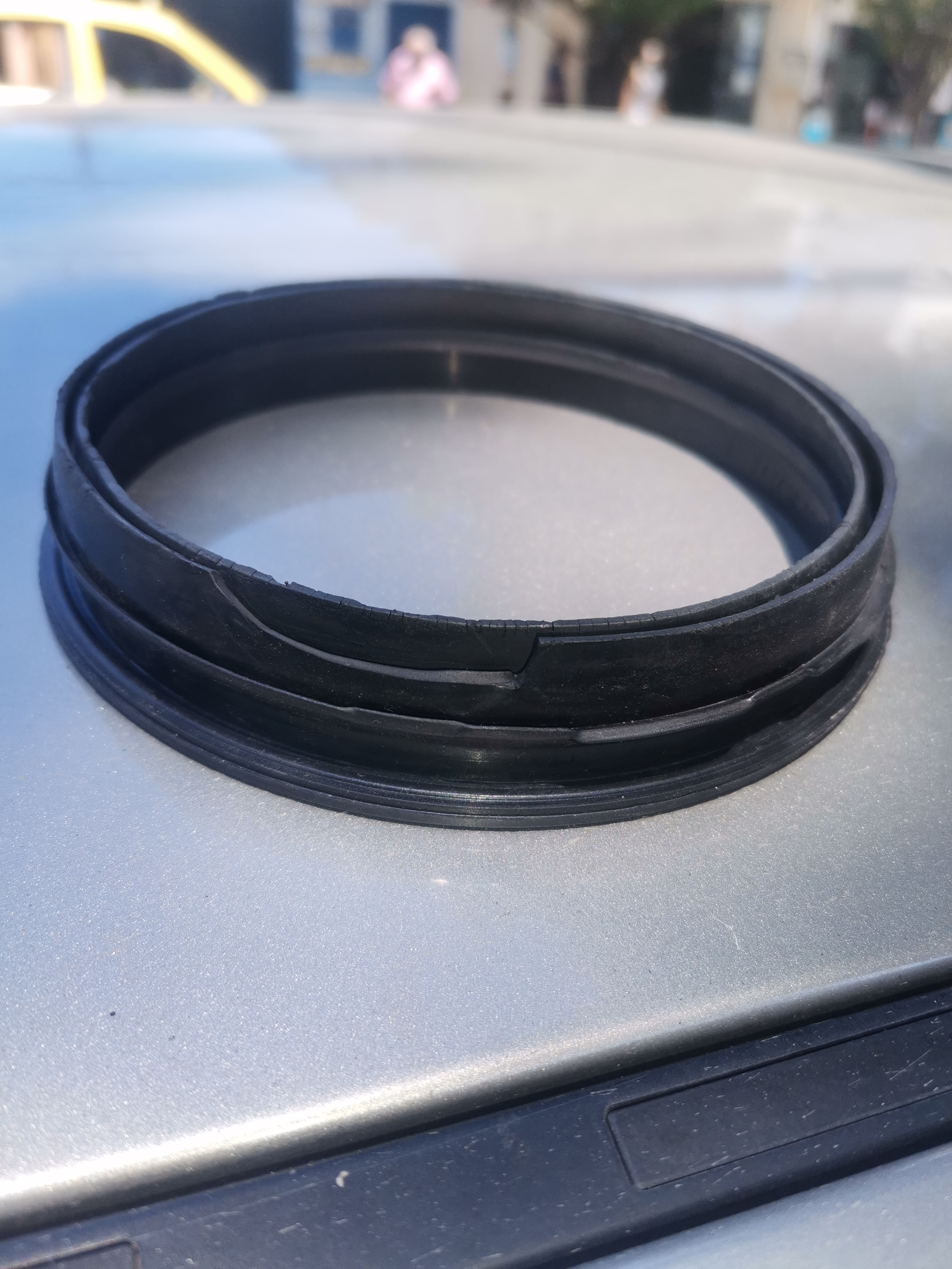

  23. Fuel leak solved. A very small crack in the return inlet was responsible for the pooling of fuel over the pump. A bit of epoxy resin did the trick, as I'm not in the mood for shelling out (again) the near £300 they are asking for a new genuine pump where I live.
  24. Turns out I was wrong. The pump gasket was indeed knackered, but it isn't the source of the leak. The pump inlets look healthy, so I guess the clips securing the lines to the pump itself are faulty. Since I have no means of dropping the tank or testing the lines or the clips to rule them out, I'll have to take the car to a shop and solve that problem.
