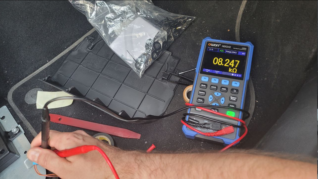

  9. So I tried to measure the OE micropohone, it only uses 2 wires, impednace seems quite high to me. I do not understand the logic of the described schema, if it is supposed to feed voltage to the microphone? Do the OEM units do the same thing?

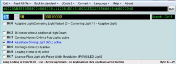

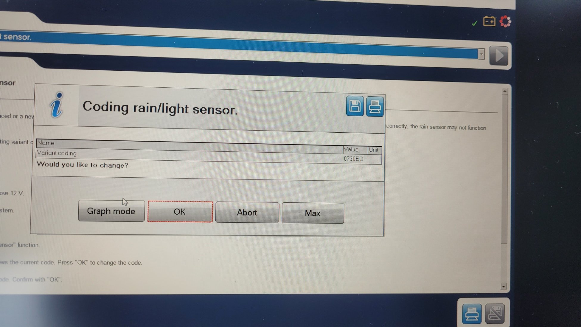

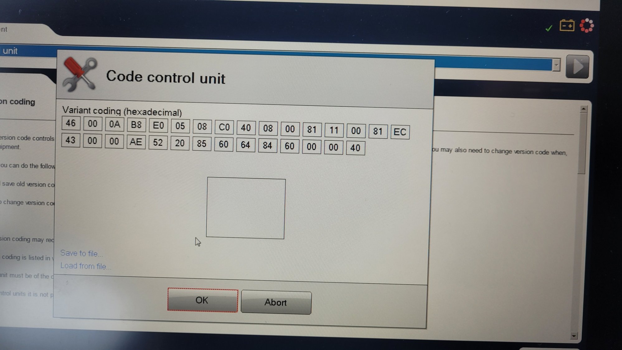

  11. Sorry for the screenshot quality, anyways .... ... I just gave up and got me VCDS EC 43 04 00 AE should be EC 43 10 00 AE I did not understand how bin to hex works (still don't), so I just did 000100 not worrying about the last byte, which clearly ones still need to sum(?). Anyways, now I do not need to use my brain, as vcds does it for me with all the nice descriptions. For others doing this without VCDS, this still might be helpful. In my case no wire was needed and I did test it throwing pizza box over the sensor and all works correctly.

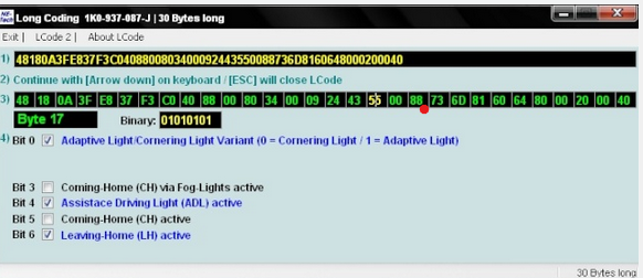

  12. Sadly again no way to edit or merge posts based on the screenshot from VDS that I have randomly found I have tried changing EC 43 00 00 AE to EC 43 04 00 AE I even accidentally verified messing with carista that it changed it to EC 43 08 00 AE as I tried enabling the coming home lights based on light sensor or something, so seems to be the correct byte but no luck, still in "live data" (or whatever it is called) it show that light switch automatic position is not installed and in "auto" it says that the switch position is implausible
