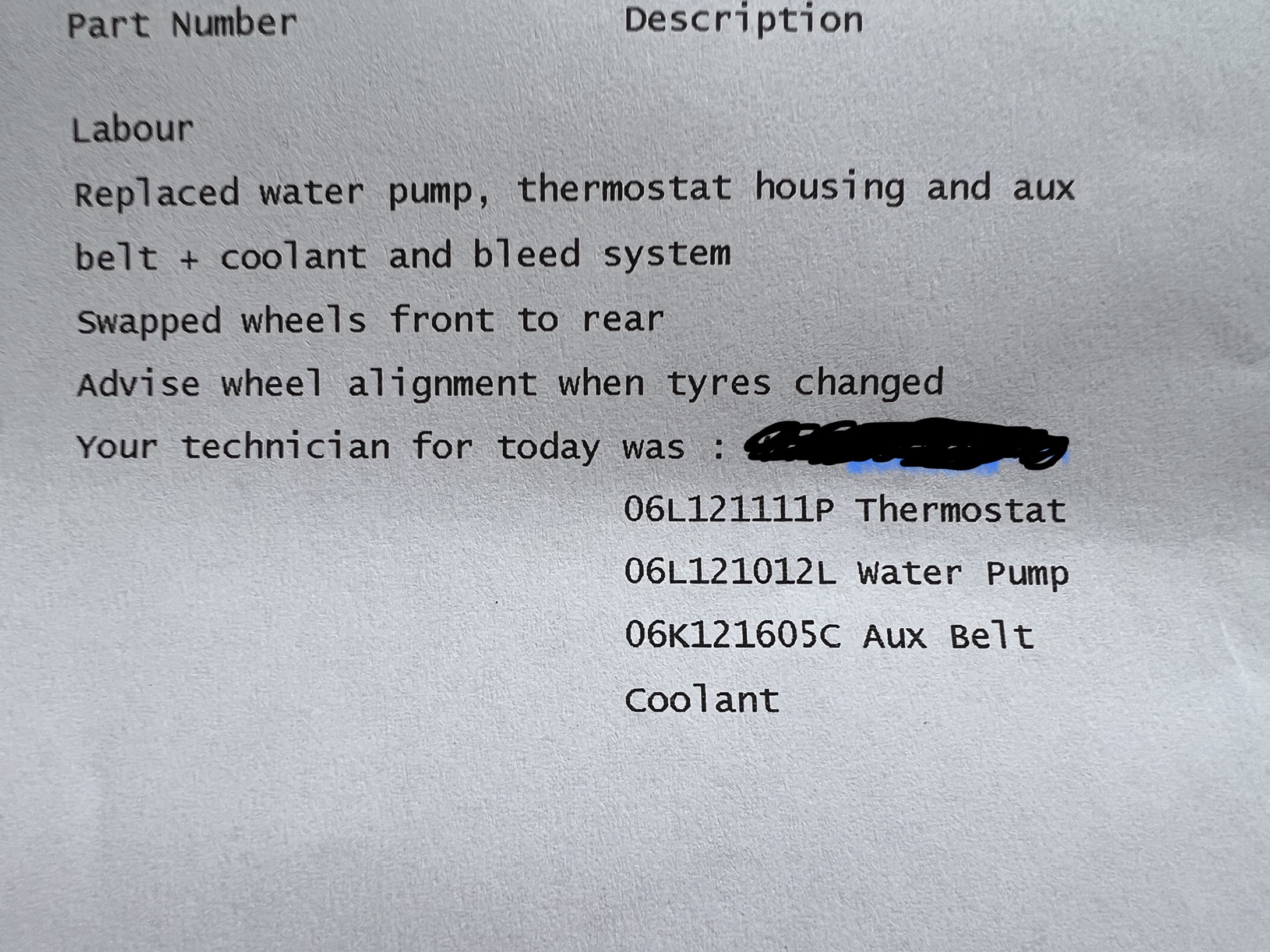

  2. Here you go, these are the parts that were done on mine. They did say the damn things were buried and a lot had to come off.
  3. Well, the job has overrun and I won’t get my car back until tomorrow. It seems as though it is being a pain of a job to do. I’ll see what I can get out of them when I pick it up, but I’m not that mechanically minded, albeit trying to take more interest. I’ll let you know what I find out tomorrow afternoon.
  4. If the parts list is on the invoice, I’ll happily attach that later for you. I didn’t bother asking for any contribution from Škoda, it’s a 2018 and I’m well out of my used warranty etc.
  5. As it happens, it’s getting done today. Dealer wanted around £1100 and my independent is doing it for £995 ish. That’s for the job lot, water pump, thermostat, coolant regulator and a belt in that area too. Water pump on its own was £375.
