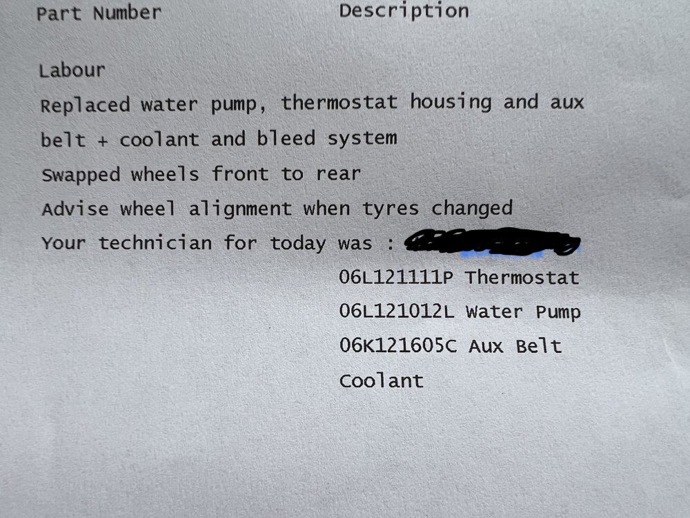

Here you go, these are the parts that were done on mine. They did say the damn things were buried and a lot had to come off.

If the parts list is on the invoice, I’ll happily attach that later for you. I didn’t bother asking for any contribution from Škoda, it’s a 2018 and I’m well out of my used warranty etc.

As it happens, it’s getting done today. Dealer wanted around £1100 and my independent is doing it for £995 ish. That’s for the job lot, water pump, thermostat, coolant regulator and a belt in that area too. Water pump on its own was £375.
