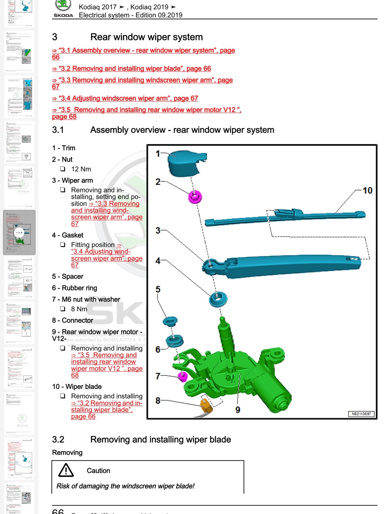

  7. Good evening, i believe the gasket on my rear wiper motor is leaking as i am getting a trail of water running up the inside of the tailgate glass when i fully open the boot. Does anyone know the part number of this item, (No.4 on pic) and can it be changed without removing the wiper motor or does the motor need to come out to replace the gasket. Thank you.

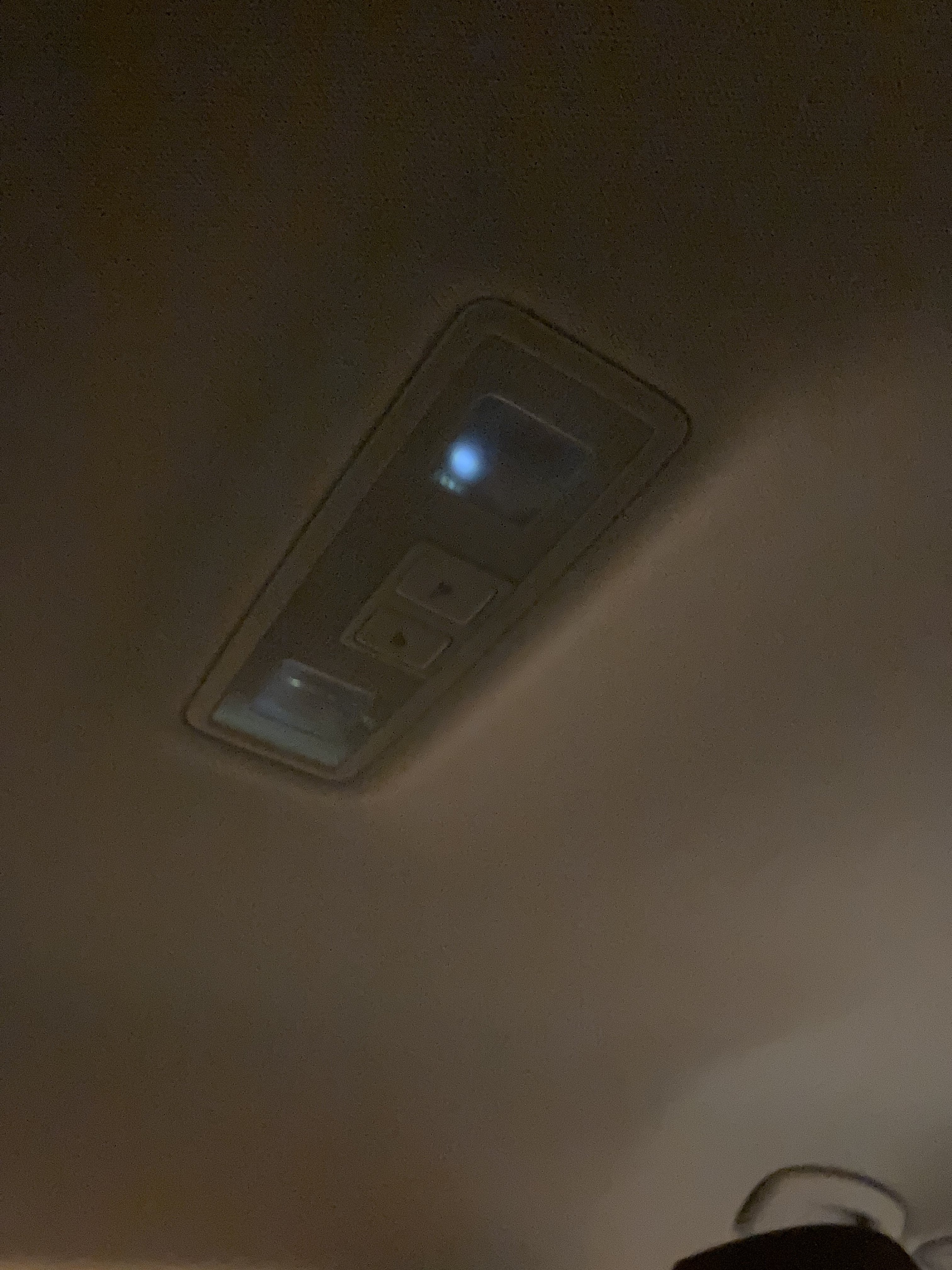

  8. I have tried this before on my 2018 se but didn’t have much joy. The bulbs I tried were great at lighting the interior of the car, but when the car was locked the bulbs wouldn’t fully go out, even after rechecking the car about 1.5 hours later they were still glowing dimly. Bulbs were canbus friendly but I just ended up putting the old bulbs back in. Not sure if the way round it is to change the full light unit for a LED unit, they are listed on eBay at the moment, just not sure if the connectors are the same.

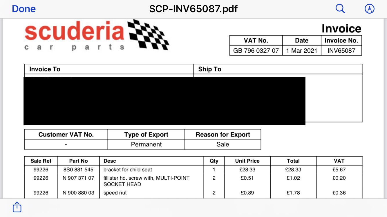

  9. I have a 2018 SE and have fitted one to my front passenger seat. I used a company called Scuderia car parts, they actually list the part numbers for a Bentley. The only part i didnt fit was the fabric cover over the bracket but the bracket is that low down on the back of the seat you don’t notice it. The part numbers i ordered are shown on the photo.

  12. Good afternoon, wonder if anyone has came across this before. Have just changed the interior 501 bulbs to LED ones as i thought the ones fitted were poor. The LED ones are a massive improvement, but just noticing that when you lock the car they are glowing slightly. The ones i ordered said they were canbus error free, which i presume means they have a built in resistor. Have left the car for about 15 mins now and it looks like they’re still glowing away. Not sure if they will sit glowing away all night and drain the battery although i imagine the current that is required to light them is minimal. The bulbs were just off ebay. Any ideas?
