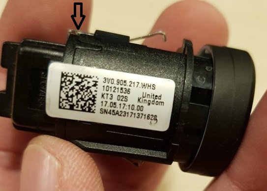

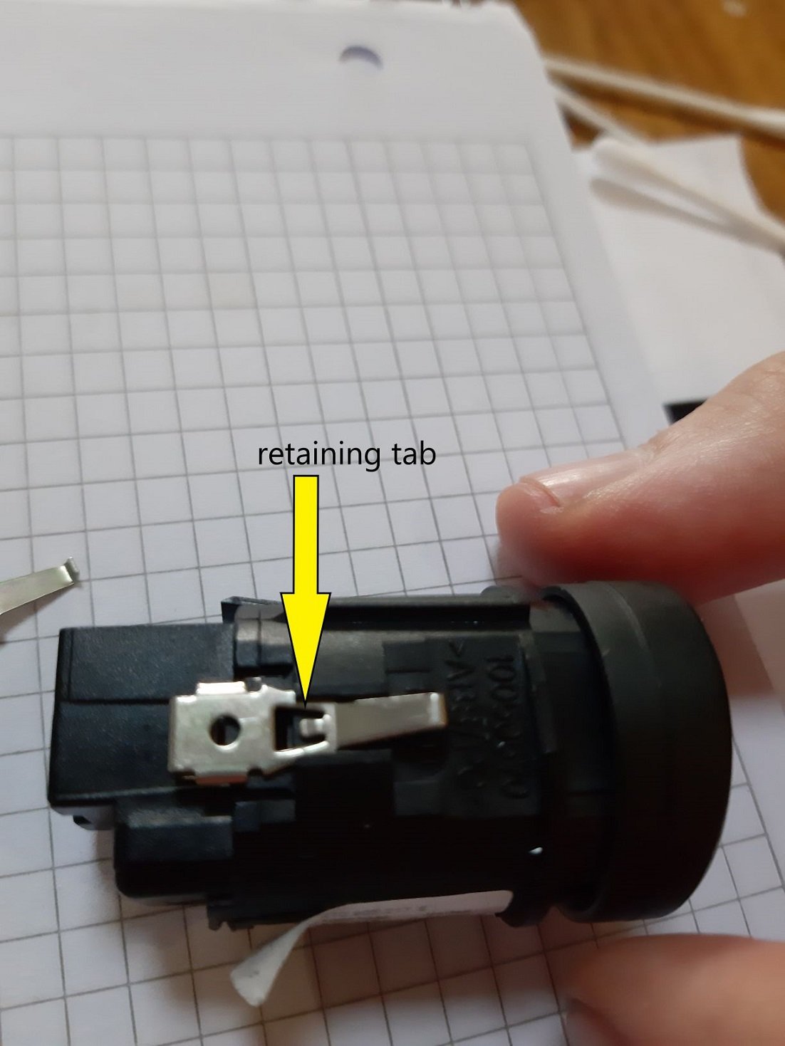

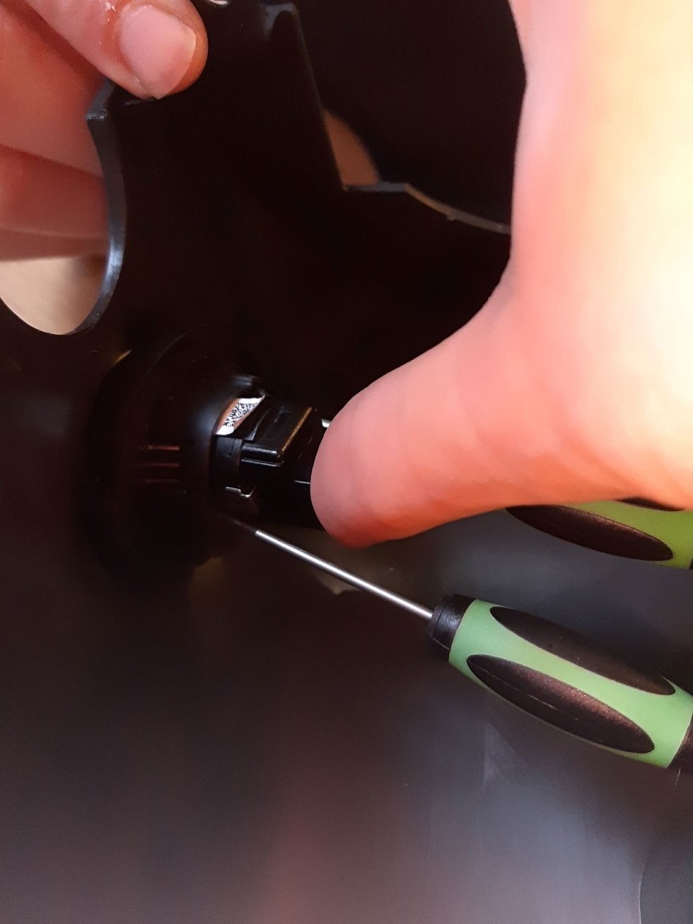

The 'four tabs to lift' had me stumped for a while as three of them are hidden at first! I've reattached JFCarters original image with an arrow to show where a gentle insertion and push of a small screwdriver will slide the holding clips on either side out of their grooves revealing two more plastic tabs. The fourth is under the part number sticker.
I'm sure there is likely an easy way for those in the know (and please post if there is), but those tabs nearly broke my heart. I eventually resolved it by inserting some fine plastic pieces under the tabs when I lifted each one. (Don't do this job if you're not in a good mood or if your well of patience is run low).

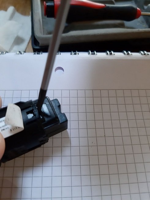

The plastic tabs are relatively delicate. I used 2 small screwdrivers to lift 2 of them and the other 2 with spudgers from a mobile phone repair kit.

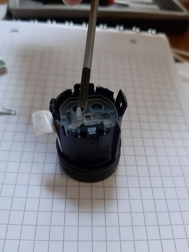

Anyway, I bought some contact cleaner from Halfords and got the car to myself this morning to crack on with the job. So, I fussed and faffed with the steering column shroud until I realised that I could pull the lever and drop the column away from the shroud, making it so much easier. Then, once I'd got the switch out I could only see two tabs (one partly hidden under the sticky label), until I sussed that I needed to gently prise the metal retainers backwards off the switch to get at the other two.
The tabs, the tabs, oh my giddy aunt THE %$**£@$ TAAAABS!
One of them already had a crack along its centre line so was effectively acting like two tabs! No small bits of plastic to hand - I believe that there was steam coming out of my ears at this point. What was to hand was my wife's sewing box, and eventually, brain in gear, I came up with a masterplan. Some fine pins, slid in under the tabs, and I emerge the victor!

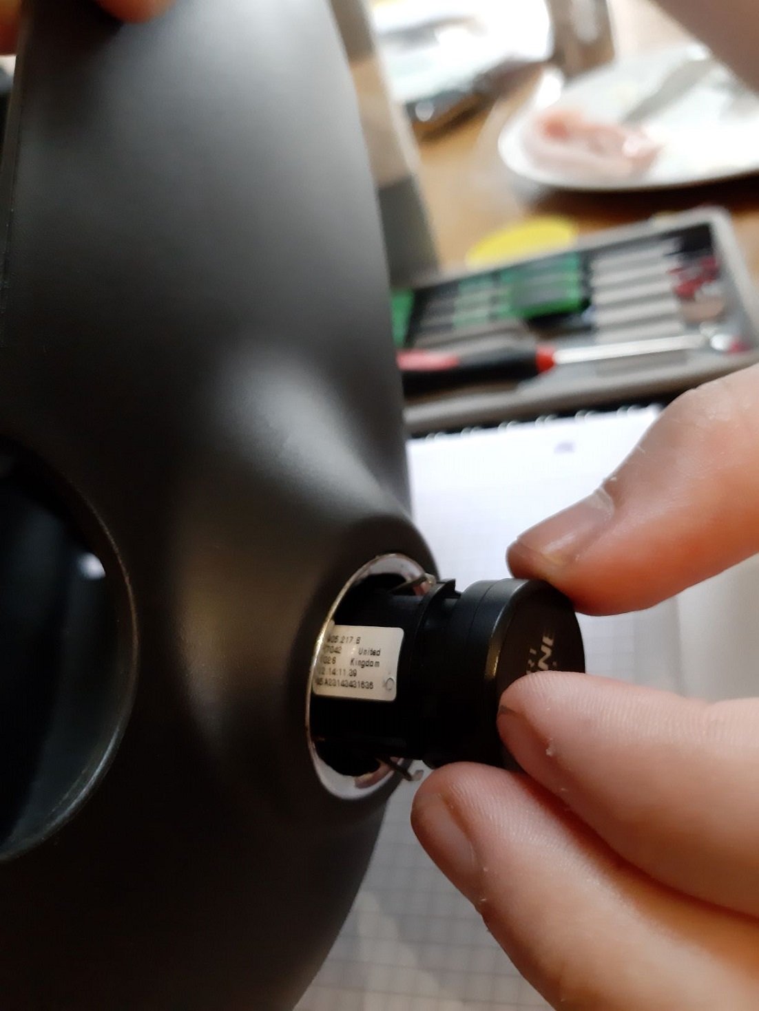

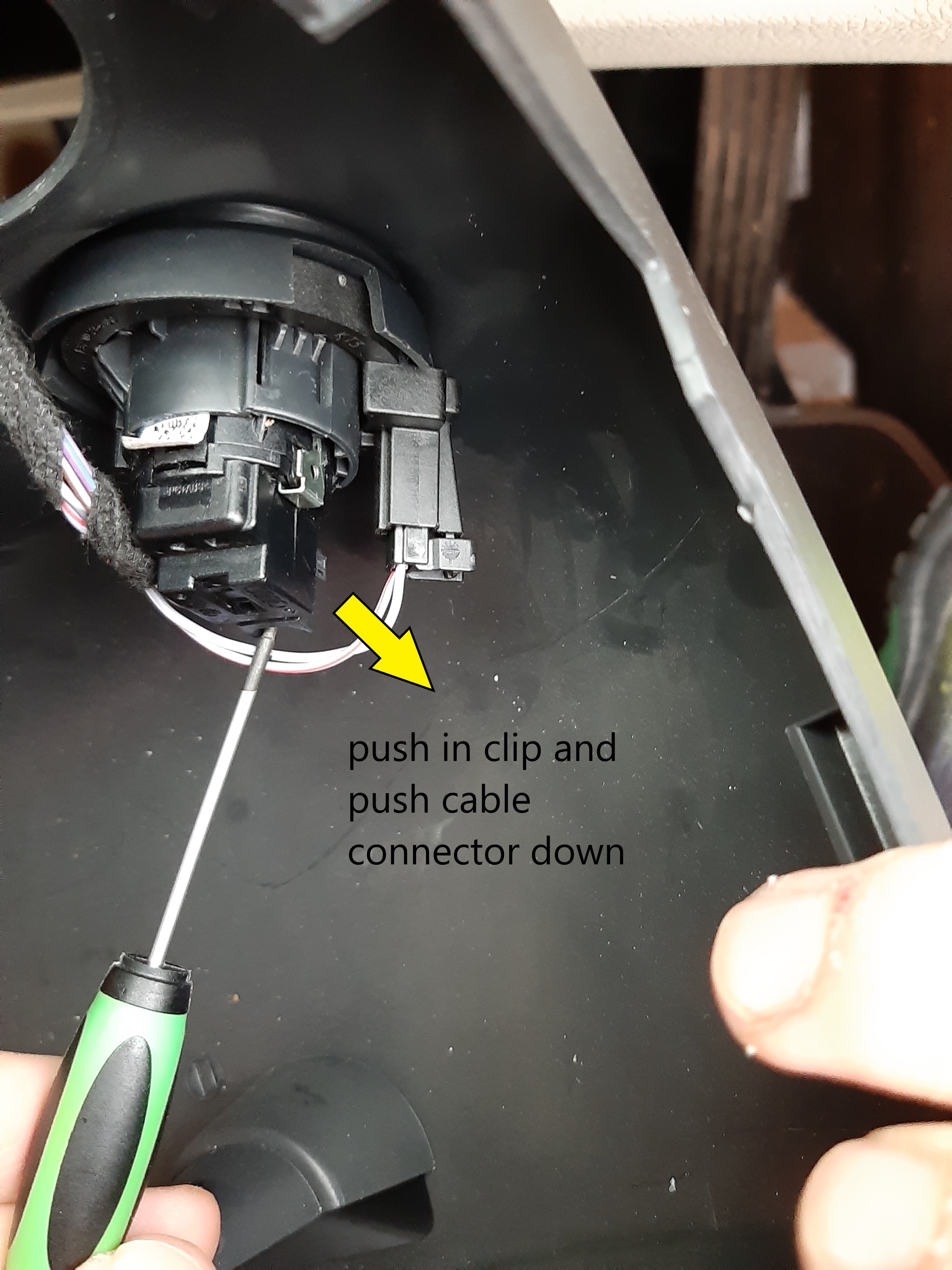

in addition to JFCarters instructions

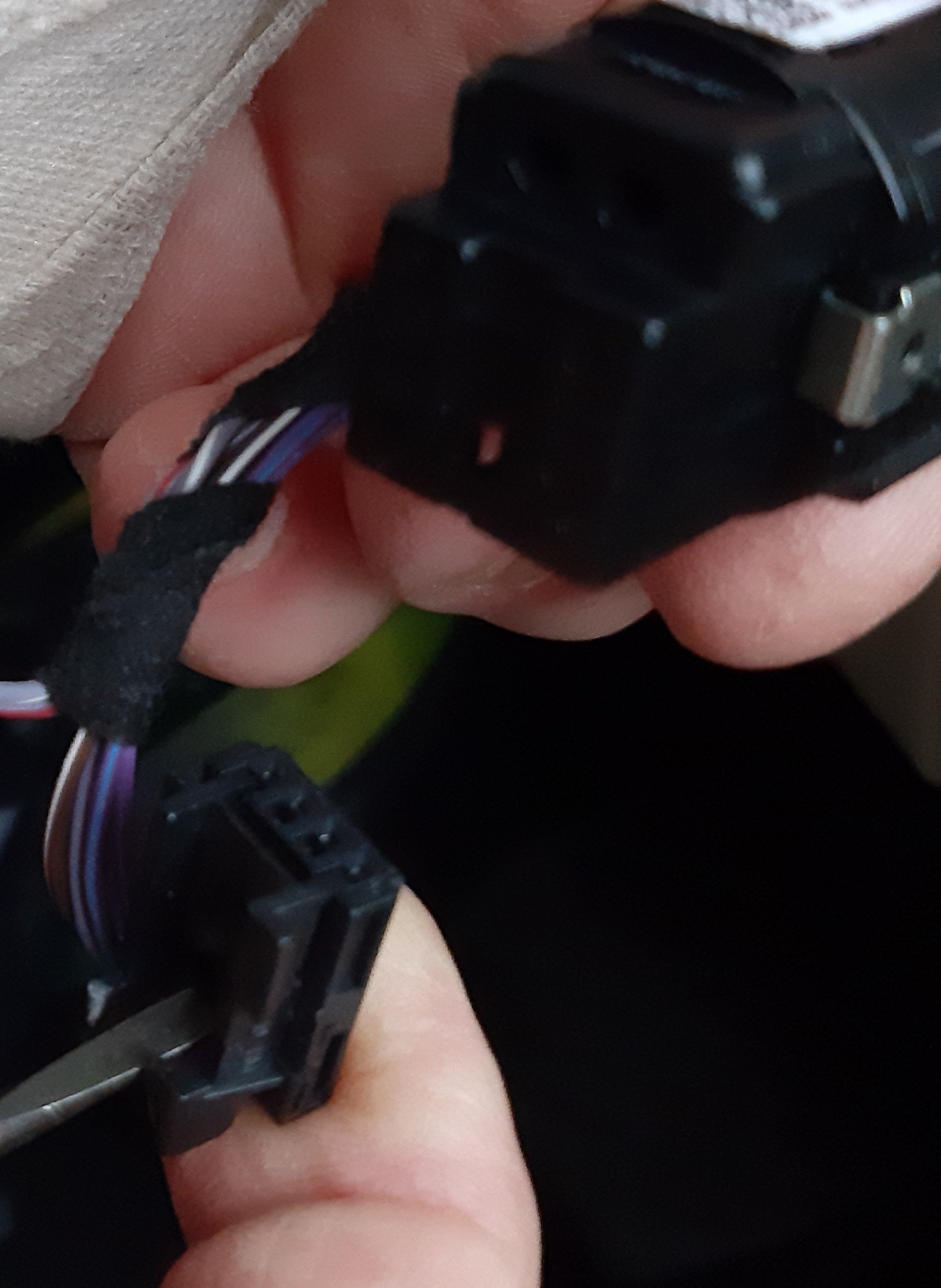

the cable connector is side mounted so you push down and away when you have released the cable clip.
then the button is pushed out from behind

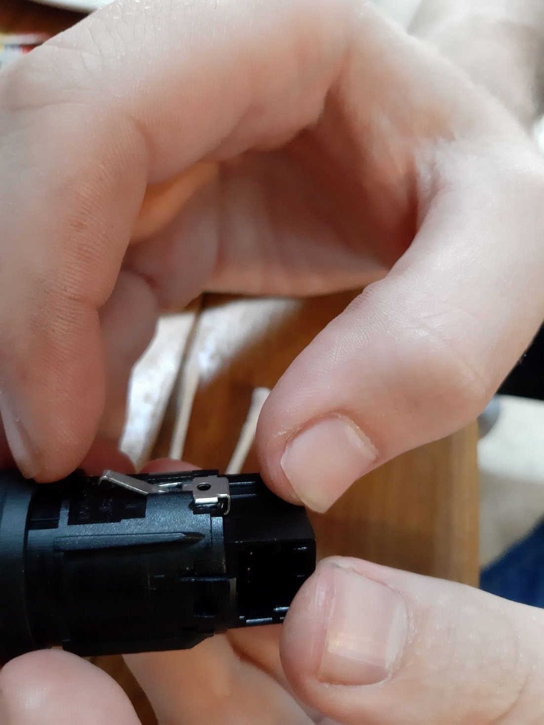

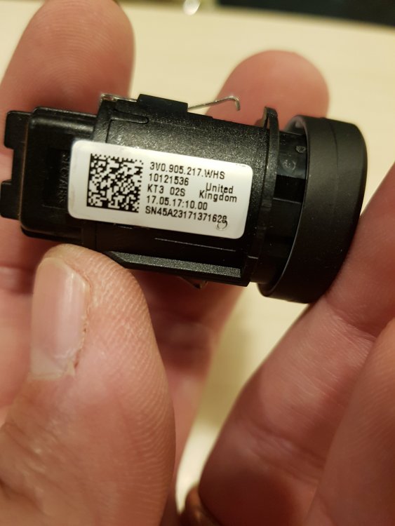

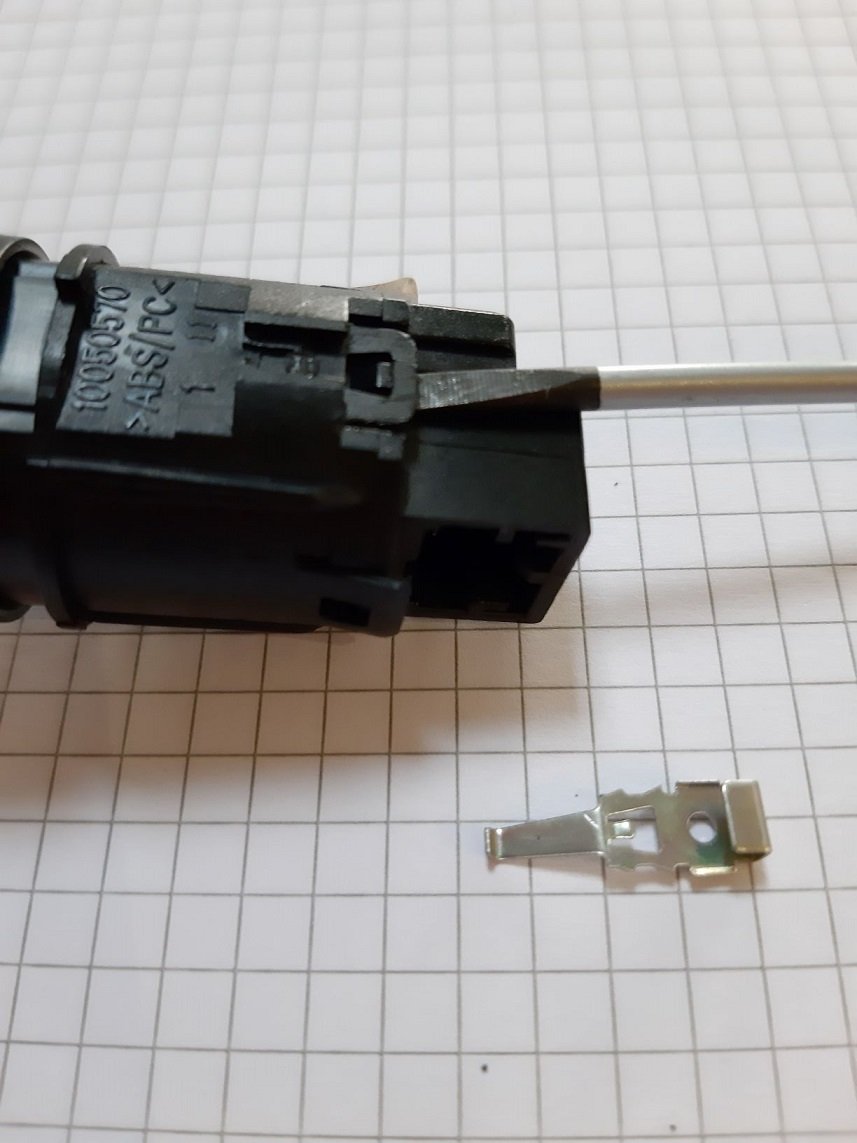

you now need to remove the retaining springs to reveal the plastic clips, there are four, one hidden behind the label.

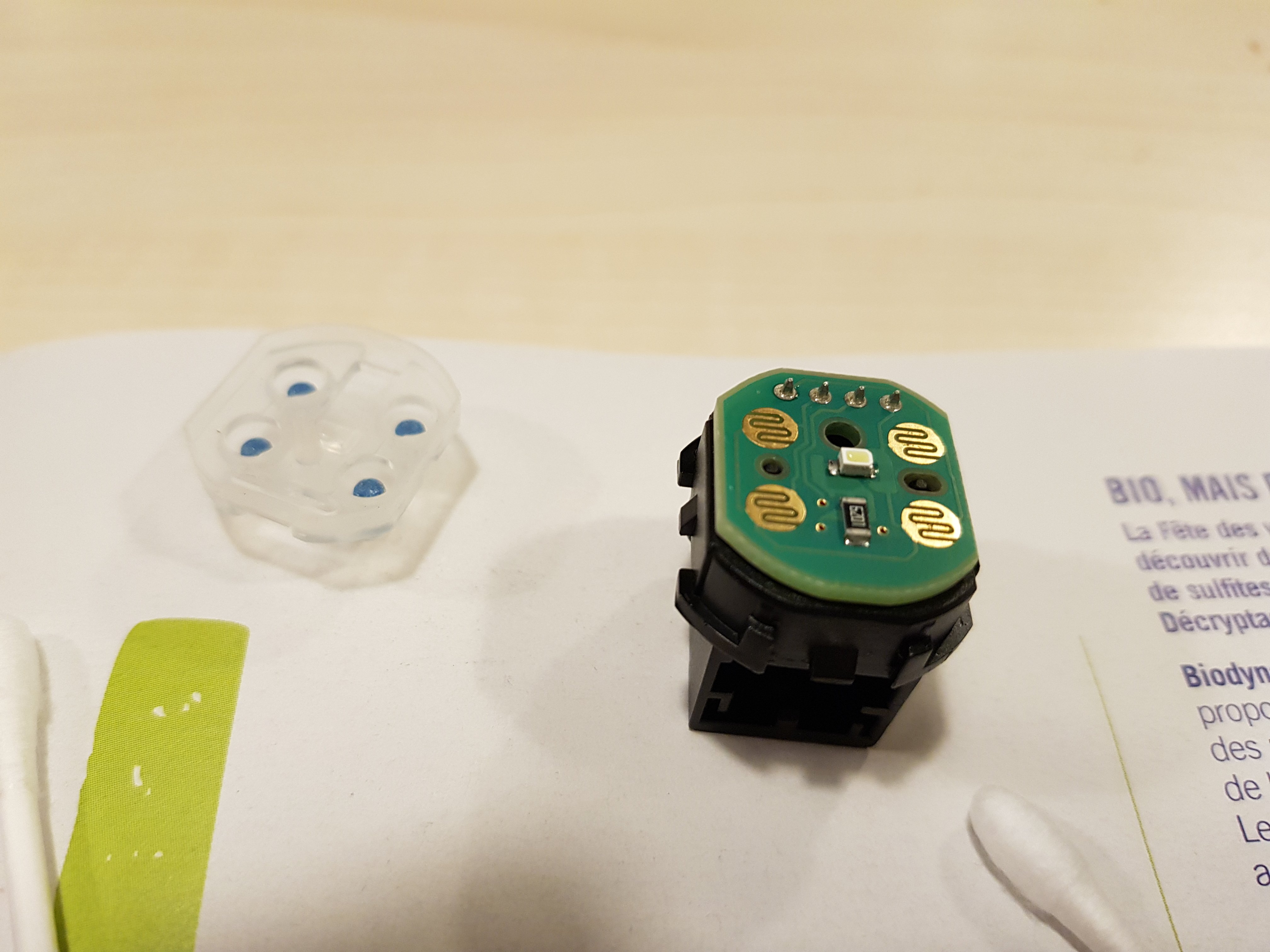

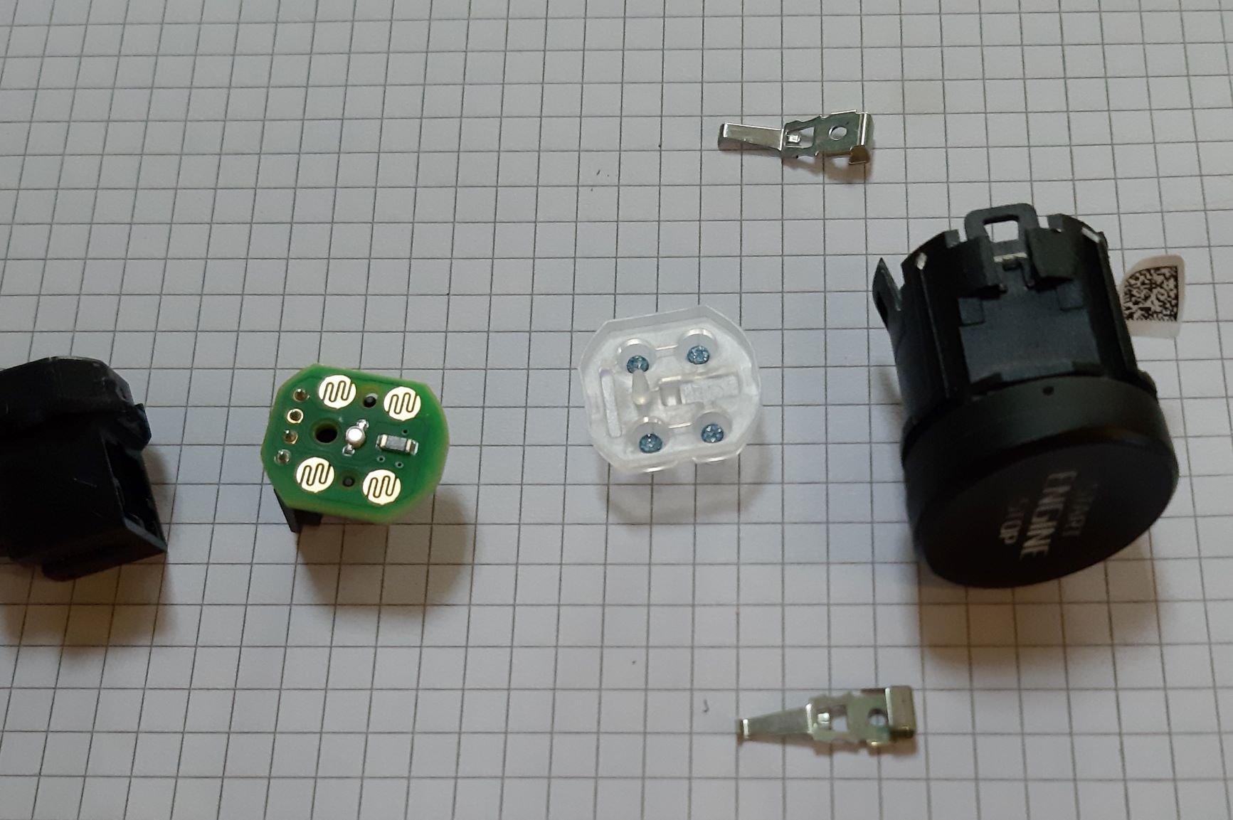

the dissasembled switch, note the orientation of the switch pad
when re assembling ensure the retaining spring retaining tab engages, if not bend it out a bit.

Followed the instructions and tips. All went well. Used sewing needles from below to keep the tabs open.
