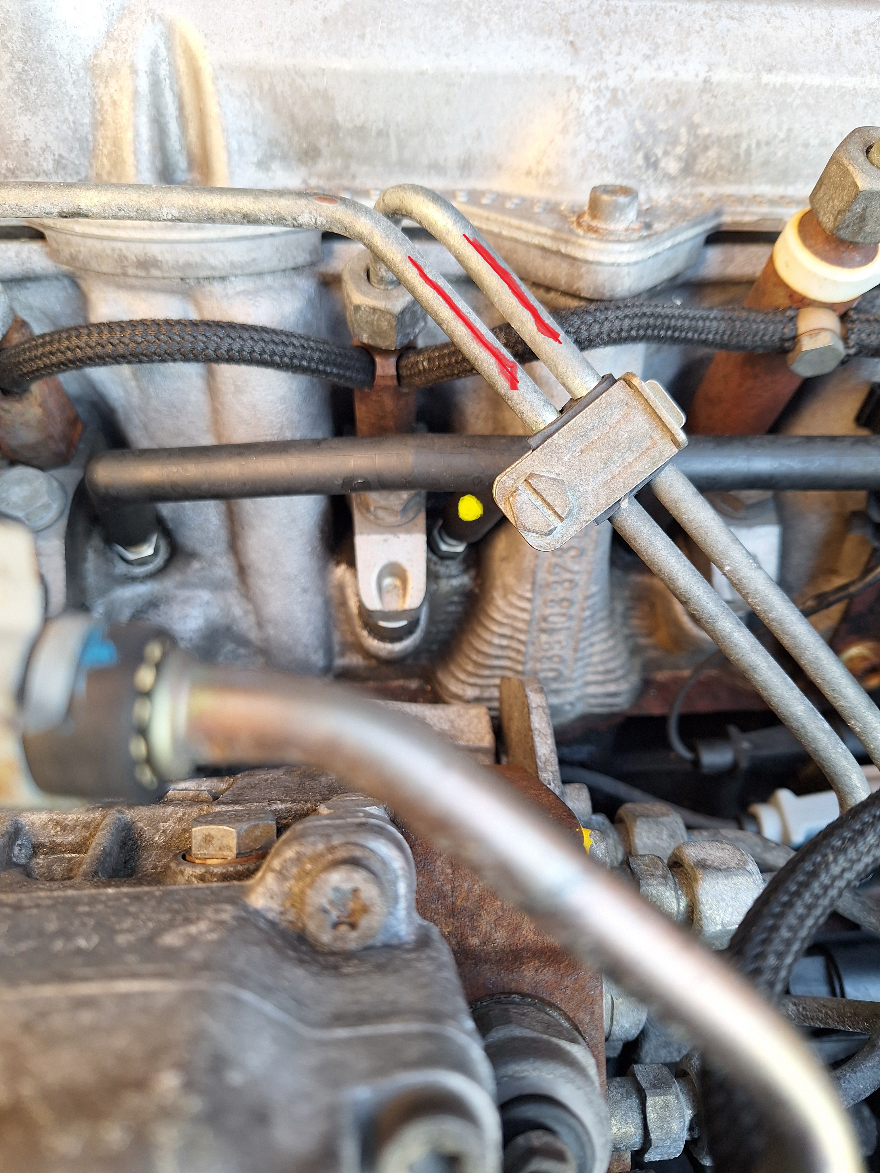

  1. Hello mate, The first one is pretty much what I've got. The problem is where the quick release fitting is, is exactly where the injector lines are. So wondered if there was a longer glow plug fitting to clear the hardlines
  2. Morning, By any chance have you guys comes across a flexible compression tester adapter or possible a much longer fitting? When I did a compression test a few months back, there was no way my tester adapter would fit without undoing the injector pipe near it. Even then I had to squeeze it into place which I just didn't like and can't believe that was normal. I've attached a pic to show where I mean (1.9 ASV engine). Yellow dot is the glow plug in question with the injector hardlines in red. Cheers Vijay
